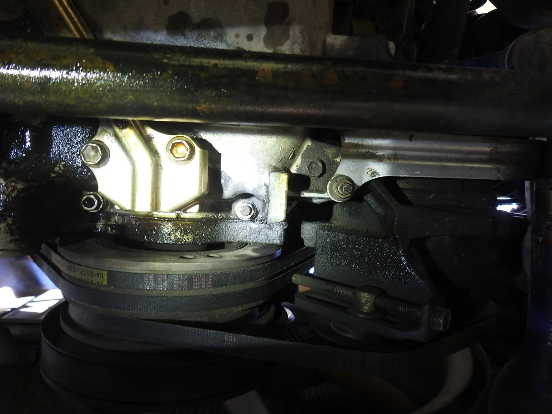

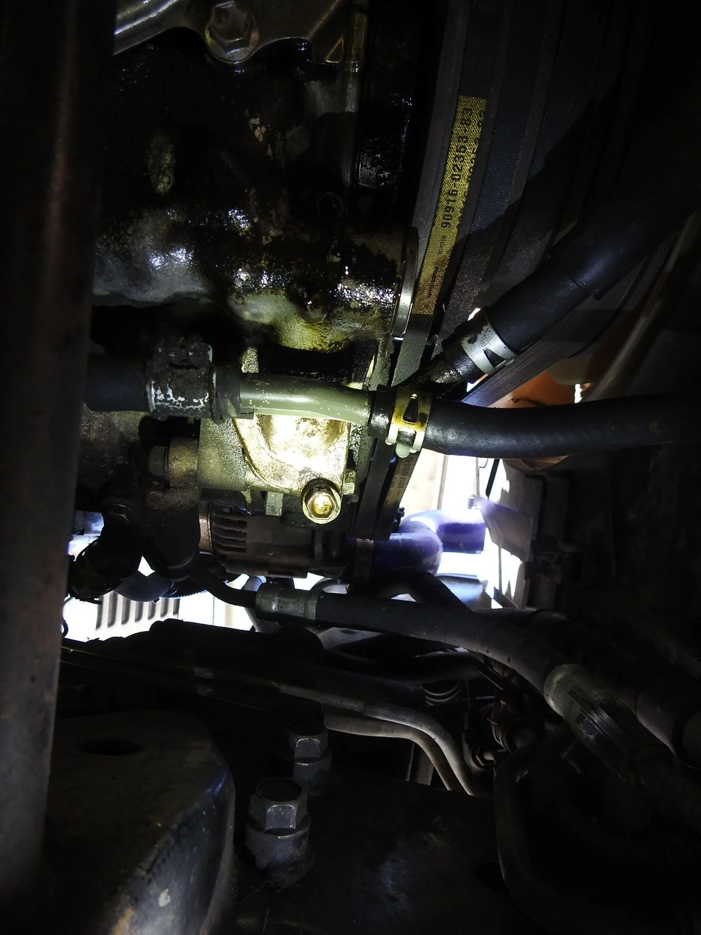

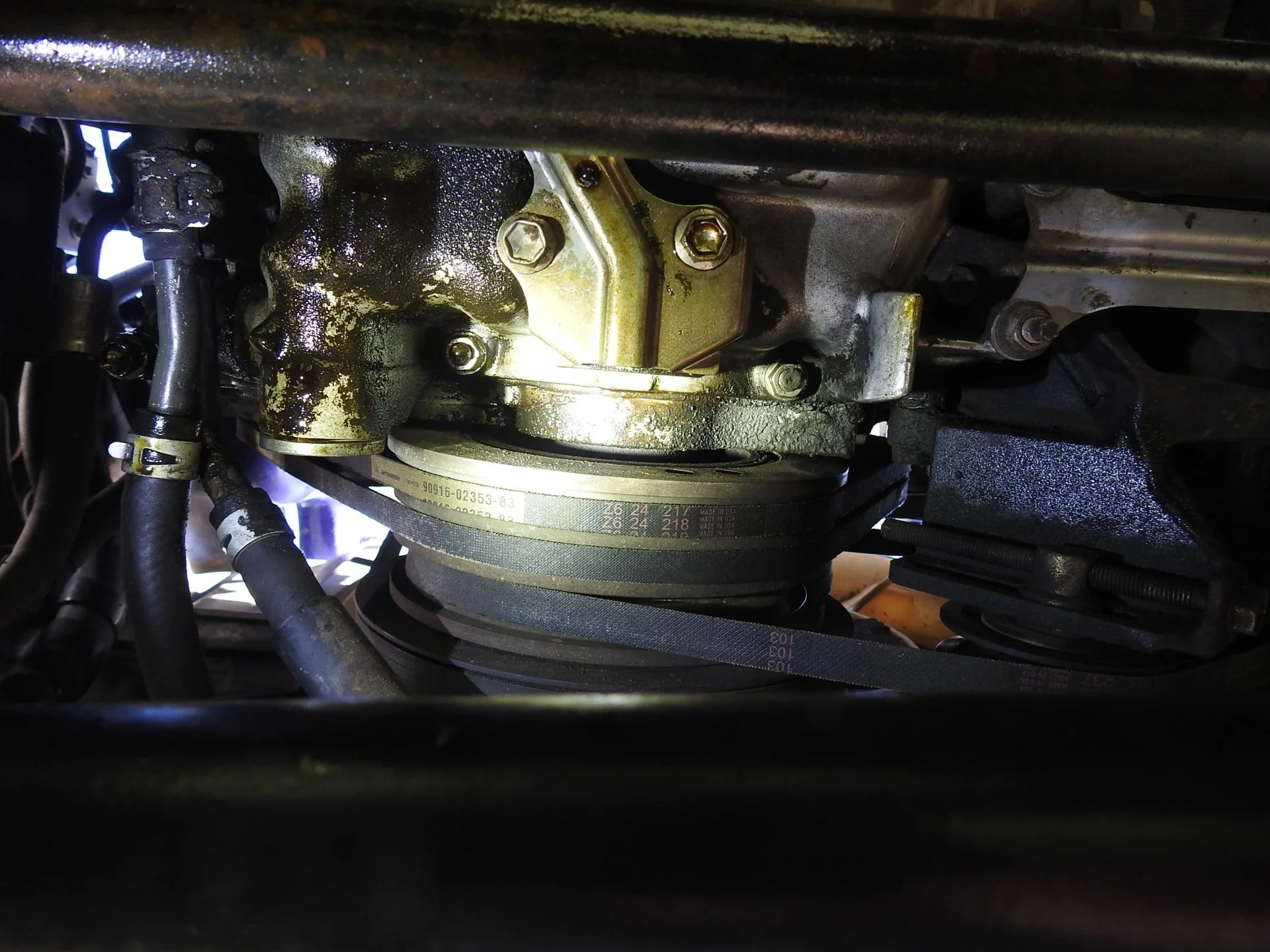

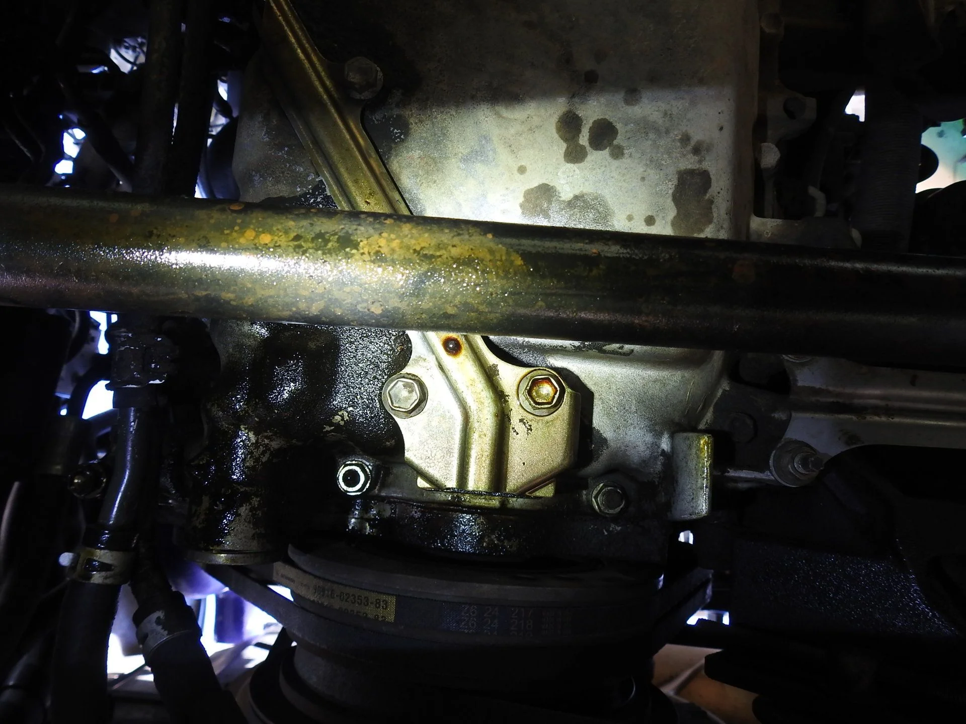

I pulled my rock plate and have this one leak took some pics that will hopefully look familair to some of you . is this my power steering pump leaking or the oring on front of engine? Its got cold here in north east and this truck has never seen the cold. on start up the PS whines till shes running warm.. and Im not getting any noticable drops in oil or PS fluid, but I want to fix it as its the only leak she has. any help? or do you need more info.

Typical appearance of an oil pump O-ring/gasket leak. Wash off the area and reassess to confirm.
Ive power washed it twice and it comes back everytime. I washed it 4 days ago and a week before that I painted the rock guard red so if it did leak it would show.
If you put the UV dye in the oil and check it in a day or so, might help you eliminated it. Pretty sure the UV dye is safe for PS pumps also. My distributor was leaking from inside, and the o-ring as well as the crank seal and oil pump gasket. I tried to UV die only to find my entire engine bay was glowing under the UV light.
If you have not done the distributor o-ring, oil pump gasket and crank pulley seal I would start with those then tackle the power steering, then the oil Pan's. These rigs are getting old and leaky.
Look at the power steering pump, it leaks from the back and from low pressure port which has a tiny o ring behind the hard pipe mount. The hoses tend to leak also, high pressure line can be replaced with the Napa hose from gates if you want to save money, the low pressure lines can be gates also. To do the crank seal and oil pressure seal call or text me and I'll walk ya through it. If it is indeed the pump it's bout 300 or little more from yota and is held by two bolts, you'll have to swap the gear. There is rebuild kit but I've never rebuilt one, for my time I just bought new pump from yota
distrubotr isnt leaking at all its under near and on PS pump and under engine im going to pull battery and everything out of the way and go all texas know how on it.
That looks like oil to me, and identical to what mine looked like when my oil pump cover o-ring seal started to go...
