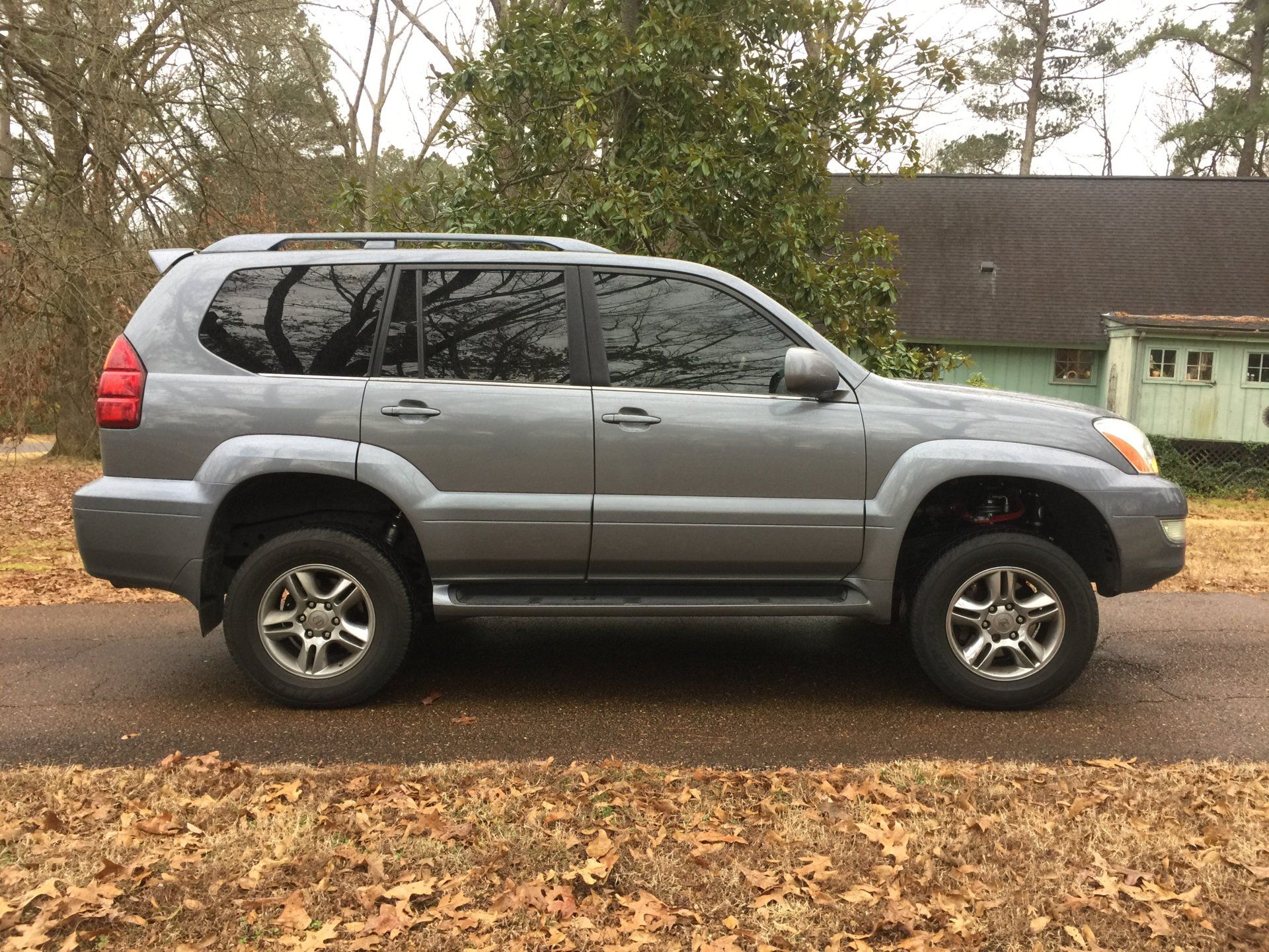

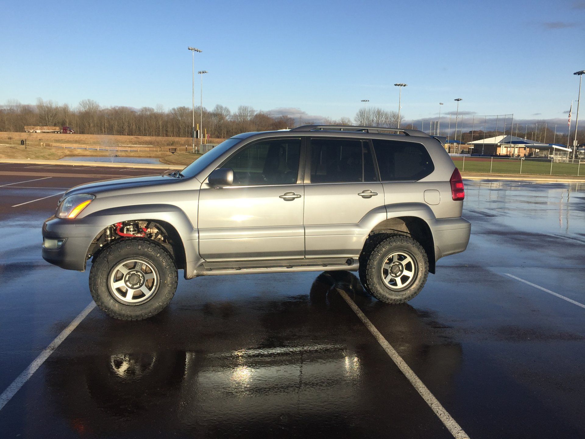

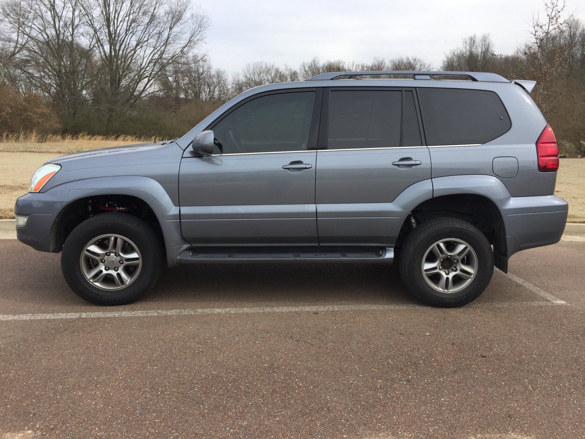

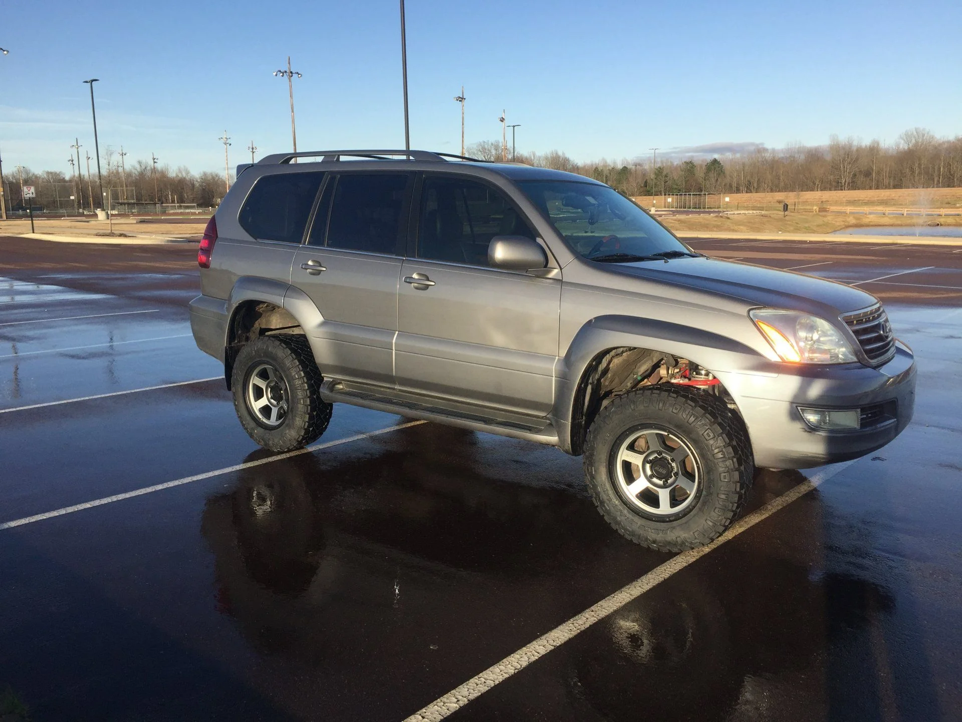

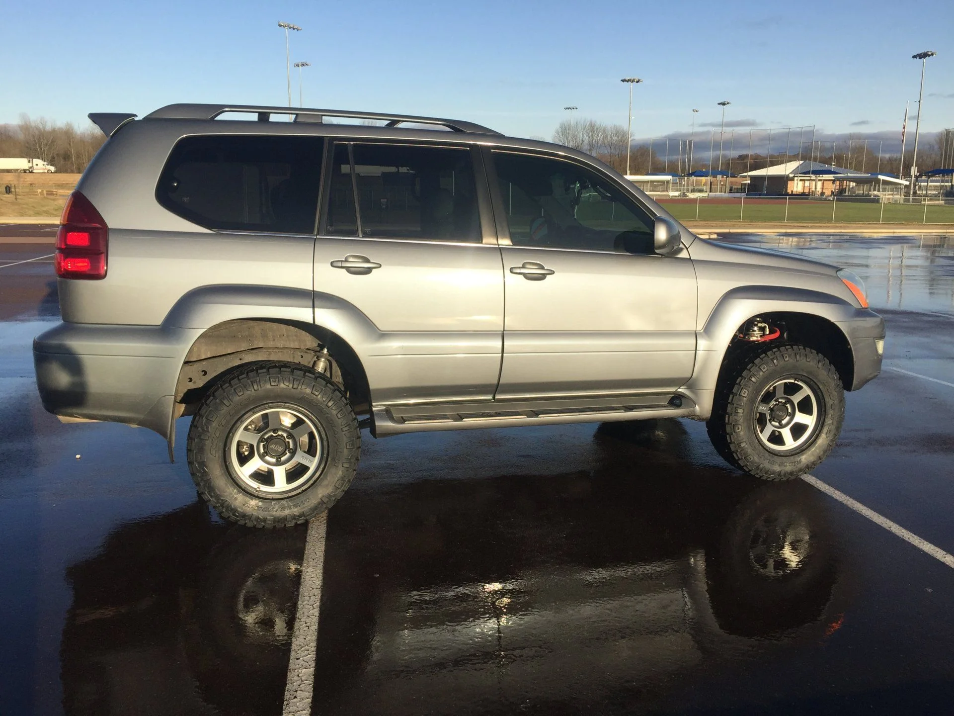

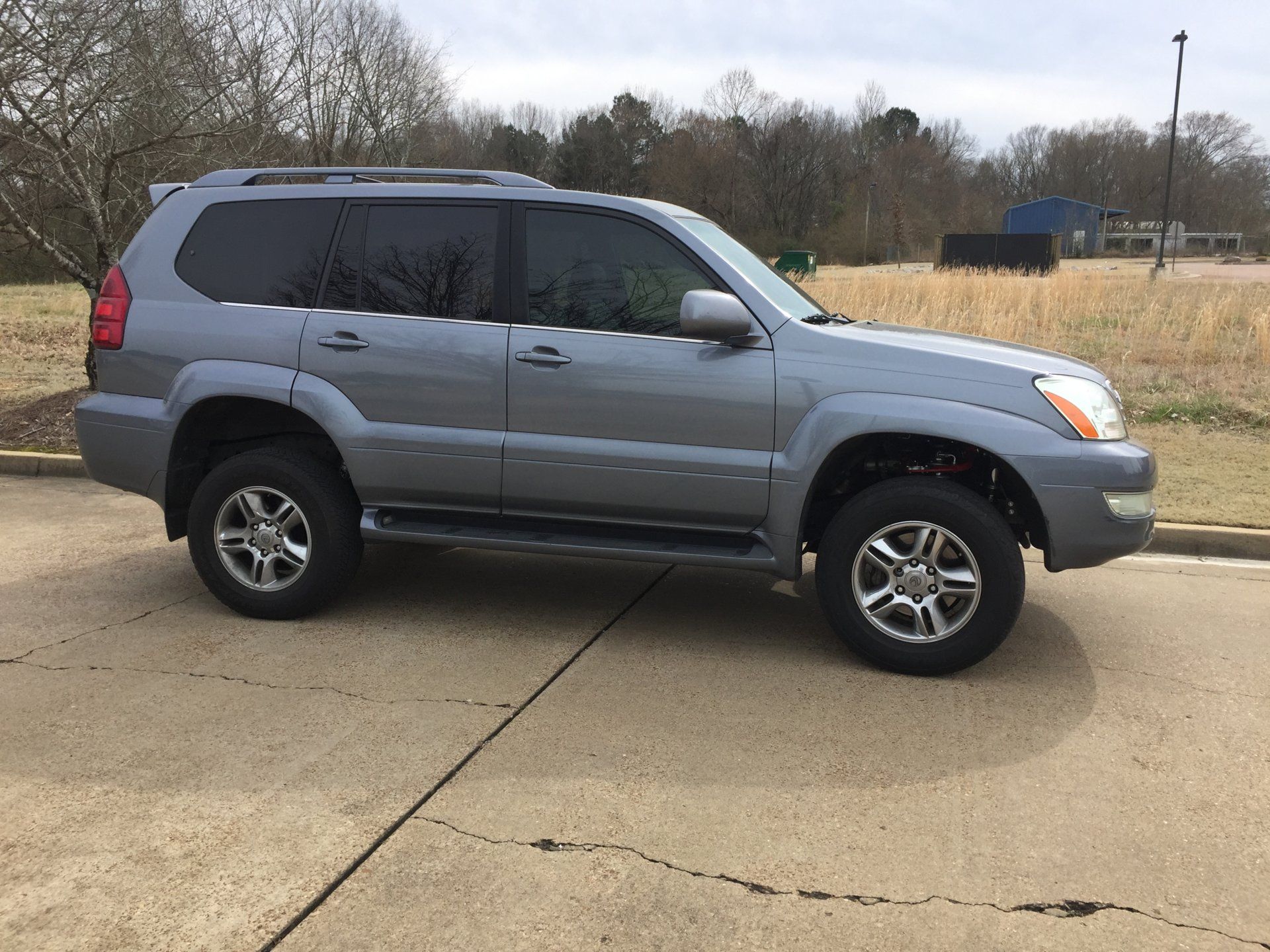

Here are the after lift pics still with stock wheels and tires. I think I’m going to put some more preload on the front. Looks a tad to raked to me. I made the mistake of not measuring before I started.
Cranked the preload on the coilovers and ended up with 4 turns total from the stock setting on the passenger side and 5 turns on driver. After driving it it still seems a tad low on the front measuring vs the rear. Man I wish I had measured before I started.

I'm stock rear and at 21ish"
I think front stock is 19.75" ish.
I have a leveling puck and front is now @ 21.25" ish now.
So you've gone from sub-20" to North of 24 in front.
Edit just measured
DF 21.25 (stock would be 19.75ish)
DR 20 7/8
PF 21.25 (stock would be 19.75ish)
PR 20 7/8
It will ride better with a 1/2-1" rake (rear higher).
I measured one at a used lot in town and it was very close to yours like 19.5. Mine after driving it around some settled to 23 in the front and 24 in the rear.
Yep, that's the Toyota lean. Battery, gas tank, and driver are all on the driver's side, so they tend to lean a bit.
Of course new spring settle after some use. We see it in dirt bikes all the time. Rear preload is a critical measurement with handling an it’s something that changes as the spring settles in. You have to check it regularly.
So I’m actually a tad higher passenger side right now with a full tank of fuel. I’m thinking that should be about right then. I’m trying to get it where it needs to be before I do the alignment.

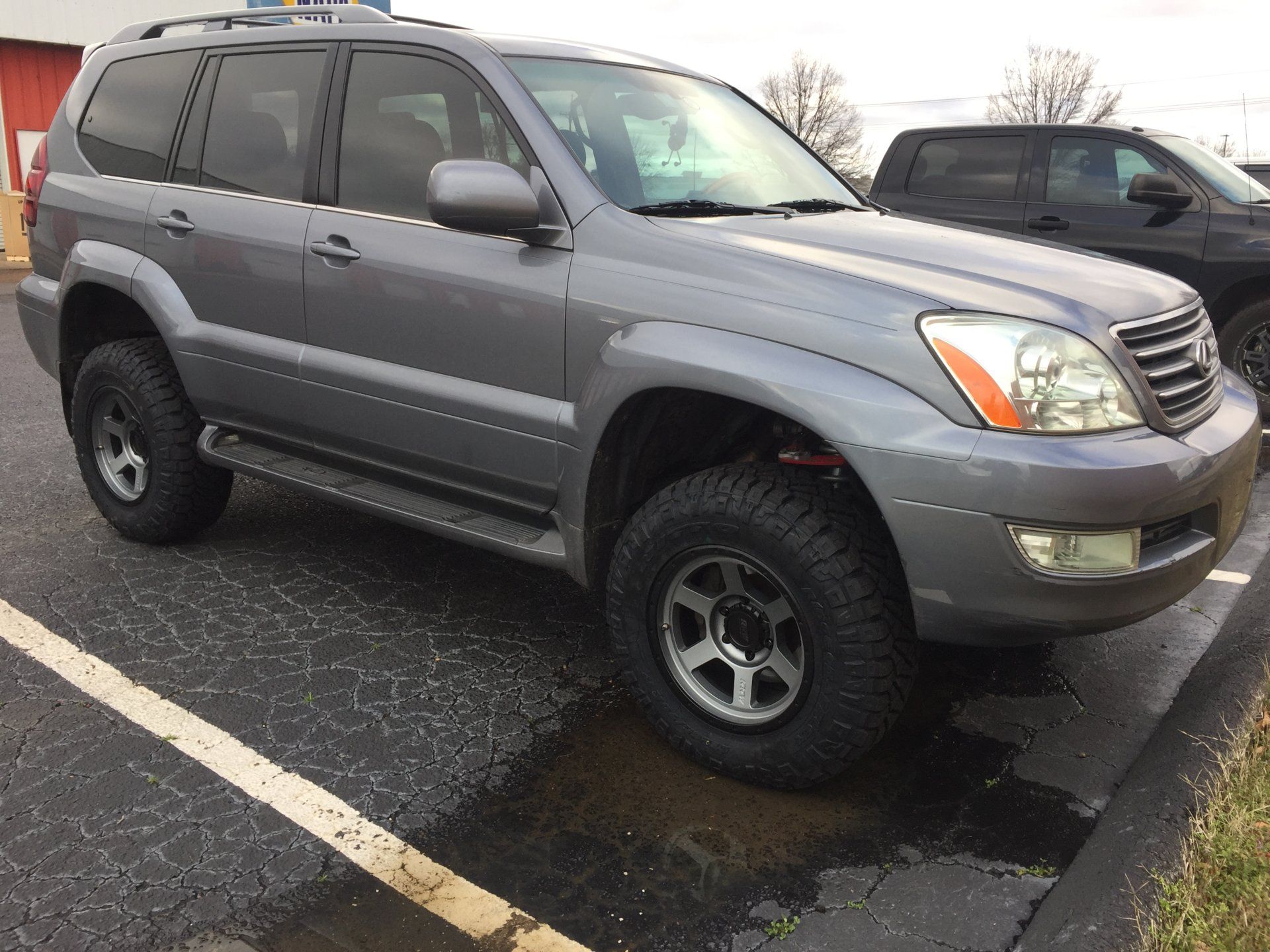

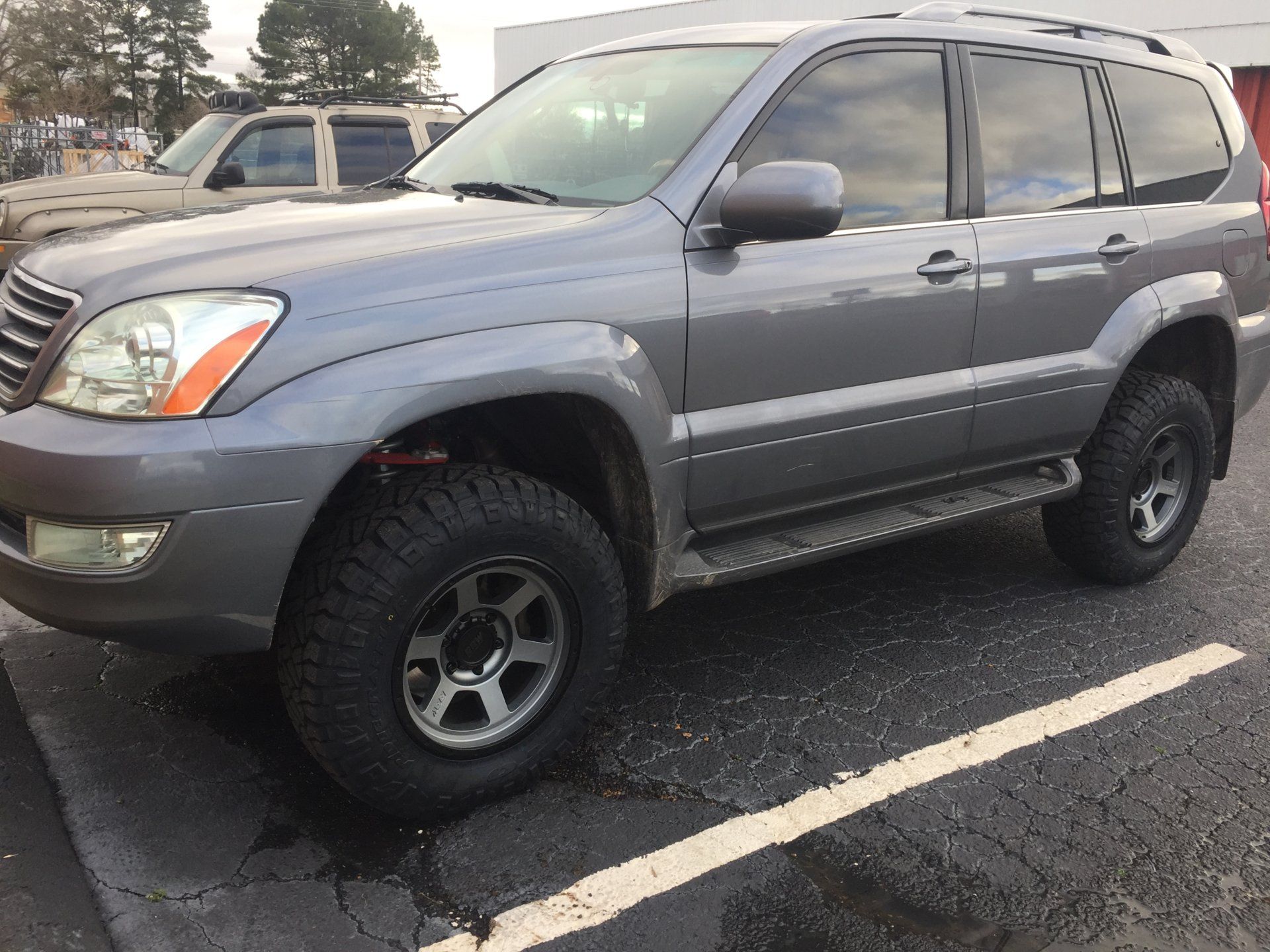

I like it. 265/70-17’s. I wanted to try and keep close to stock fuel mileage and did not want to expend to much energy for clearance. These rub the stock running boards but those are getting replaced next anyway.

It drives great btw. The stock suspension had gotten pretty soft and firming things up has actually improved the ride. Those Nitto's are very quiet. Hope to keep some of the original fuel mileage. The Fox 2.5's came with 600 lbs springs according to Fox. I am using very little preload on those springs. Those first lift pics are with practically none. Even now there is less than an inch total on both. I'm thinking on those coilovers going any higher would not work.
