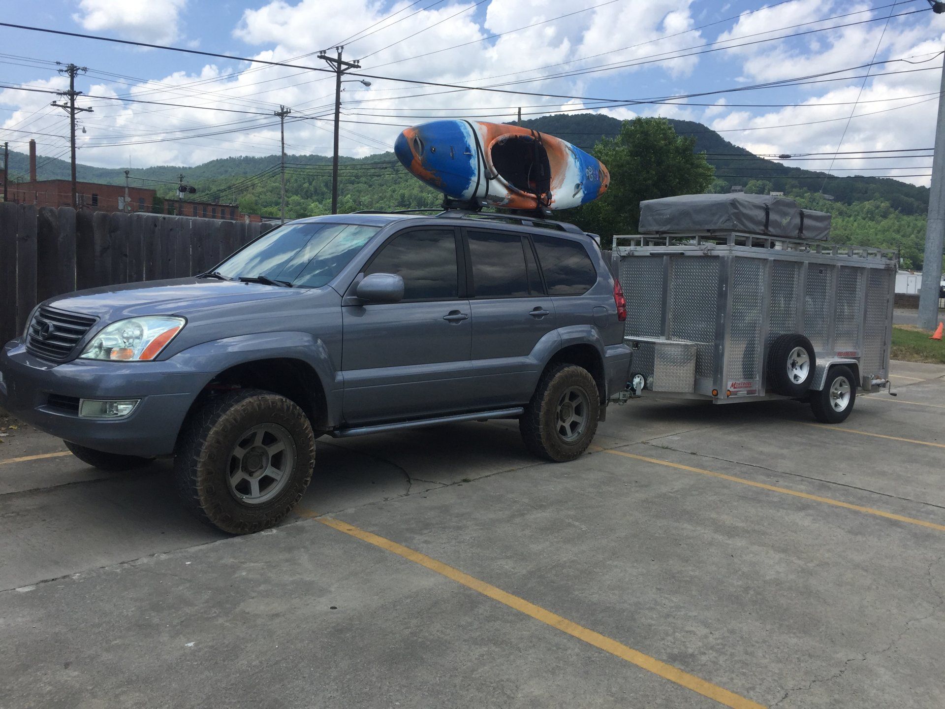

BTW the second battery and the DC to DC Redarc charger worked great all weekend. I kayaked every day so I was driving around and that was enough to keep the battery charged. It ran for 3 days consecutive and I never hooked up the solar because it never needed to and we had 110 at the campsite and I never ran the fridge off of it either. It was way easier just to let it run off the battery. It would recharge fully after about a 30 minute drive when operating for 24 hours.

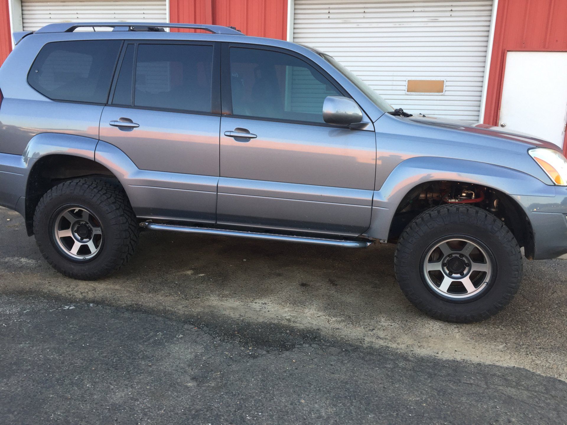

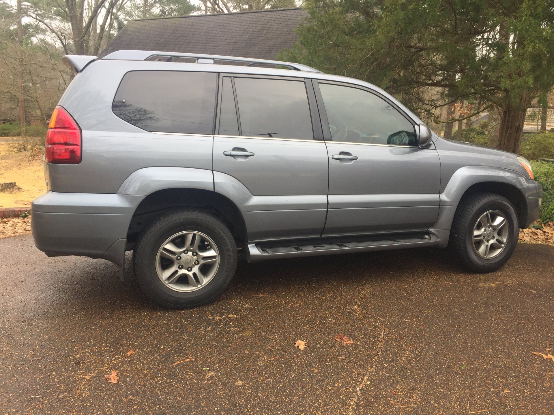

Comparison from stock to current look
Slider look great, love the wheels too 👍.
What size tires, look a bit skinnier than 285/70. I like them and want a narrower tire next.
Nice. The tires look bigger than that, but as I look, are those wheels 17" they look a bit smaller, didn't think smaller cleared brake calipers? .....You probably answer all that if I go back a few pages.
They are 17's RRW's. They are Toyota specific wheels. Sort of an unusual set of specs with offset and BS.
How you liking you suspension? Is it harsh? How does it compare to the factory ride, which is quite good I think?
Its firmer which I like better. Handles better with the new suspension even with lift. I had a 7 hour drive to East TN for the trip and the best part of the GX is the comfortable and quiet ride for that much seat time. The 4.7 pulls my trailer easily. The only downside to the GX is the small fuel tank.

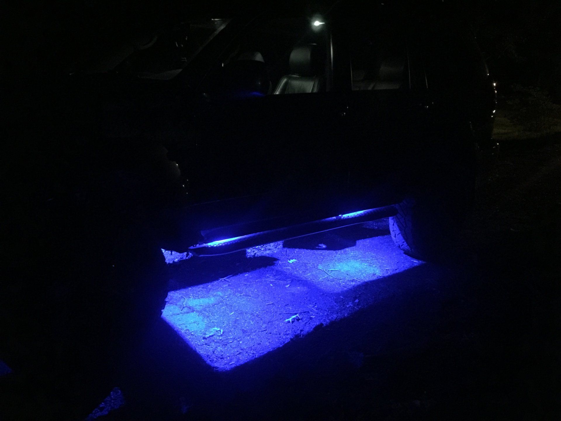

Had my GX up on the rack doing an oil change and noticed the plug from the removed running boards for lights. Got on eBay and bought some cheapy LED’s and mounted them underneath and wired them to the running board plug.
I did the same too, Ebay specials. $6 for 6. Mine were more white, at least in photos. Work great when camping, and even fade in and out.
MIne are blue....just a random pick. My wife even asked..whats with the blue lights? Then she said.."please tell me those don't come on going down the road"..lol.
Ha, she'll never know.
