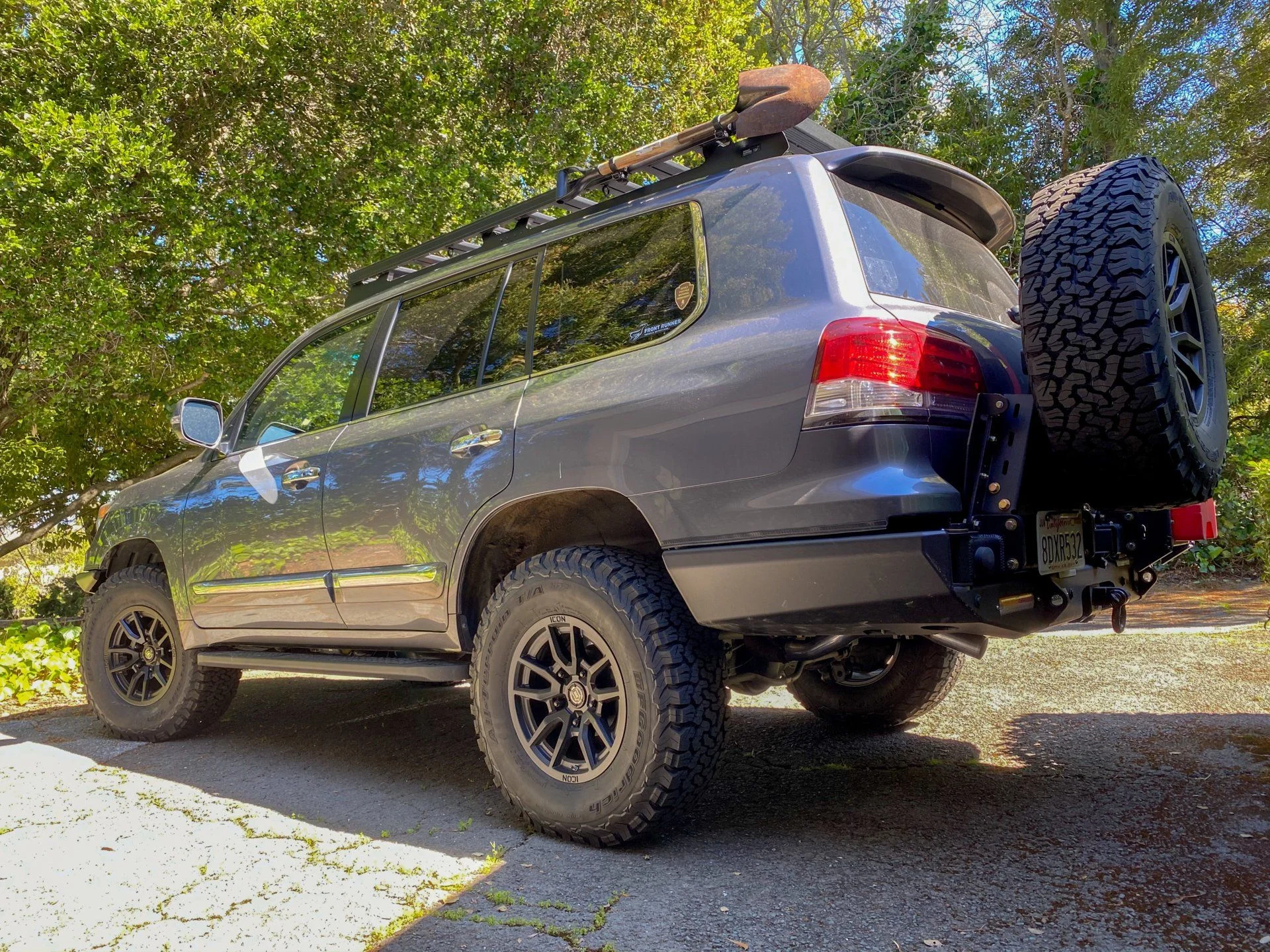

I posted most of these on my IG, but figure I would add here.
Added the Rhino-Rack 84"x49" Pioneer Platform on the Backbone system. Instructions were good. Removing the old rack was easy. Only thing was I had to move two cross bars which wasn't hard.
Also turned my Toyota Tundra TRD wheels to Lexus LX570 LRD wheels... :grinpimp:
You got some explaining to do bro....Ha.... Did you simply remove toyota Sombrero and glue on a Lexus badge on oem tundra center caps or? Do you have part numbers on the roof rack platform and mounting system?
Looks great! Details please...
I would like to do this as well, appreciate any info
I ordered some cheap Lexus center caps from ebay. I pried the sombrero off and stuck the new "L" pieces on. They weren't exactly snug so I used some VHB to assist in securing them. No damage done to the TRD center caps, so this would be easily reversible.
Any issues fitting 285/75/18’s? Running AHC lift or spacers? How much if any trimming?
No issues but it took some work. I have lifted the AHC using the bracket. Later I added the spring spacers but only because I was changing fluid and had it drained anyways. I did not need them to fit the tires. Wheel spacers I did need. I used 1.25" BORA spacers which did NOT require trimming the wheel studs - at least with the TRD wheels, although I suspect most wheels would not require it either. When I have the wheels off next, I'll snap some pics. I think I have a rotation coming due. I trimmed the rear side of the front wheel well after I removed the front mudflap thing. I did some reshaping of the liners using a heat gun. Best collection of info is here: LX570 wheel well "adjustments" for 35s
Rhino-Rack part numbers: Platform is JA8647 (or 42107BF depending on where you're looking) and Backbone is RTLB1.
Later I added the spacers but only because I was changing fluid and had it drained anyways. I did not need them to fit the tires. Spacers I did need.
So you did or didn’t need spacers? You seem to accidentally contradict yourself here unless I am misunderstanding.
Corrected. I meant Spring Spacers and Wheel Spacers respectively.

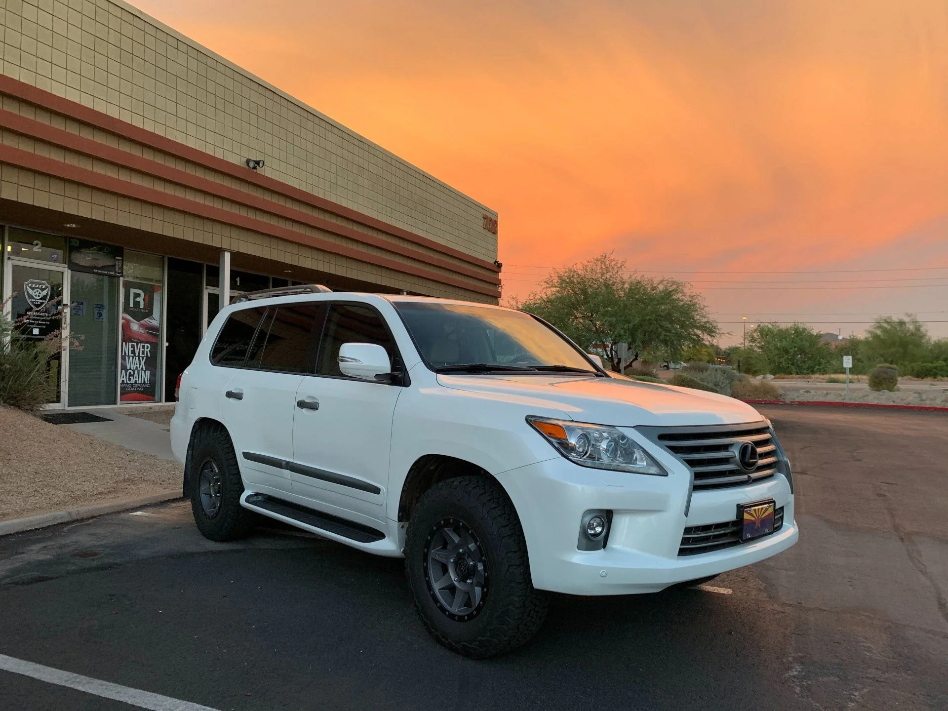

Got tint, head light/tail light restore, and chrome deleted this weekend. Chrome was wrapped to color match the rims.
Thanks @Tim Foil for the recommendation in this thread, I used Marcin @ Elite Car Group and had a great experience.
Look great Big Jon. How do you like the handles? Marcin was a little worried about those so I didn’t do it.
Hi Tim,
With the understanding the car will live primarily in covered parking, Marcin & his wrapper guy said it would look cool and hold up. They did have to take off the door panels, which added to the cost. Logo painting and all the wrap ended up at $1300.
Jordan
Really like the way these wheels look. Makes me reconsider my Icon Vector 5 order (which is still 5 weeks on backorder). Generally not a fan of fake beadlock, but these look pretty nice.
Chrome delete looks great, final nudge for me to go graphite! Also rocking a pearl white LX and was first thinking of a matte wrap on the stock chrome, but then I found the graphite metalizer for plastidip and think that's the route I'll go. Unsure of how well it'd work on the handles with use, but then again it can just peel right off if need be. Cheers
