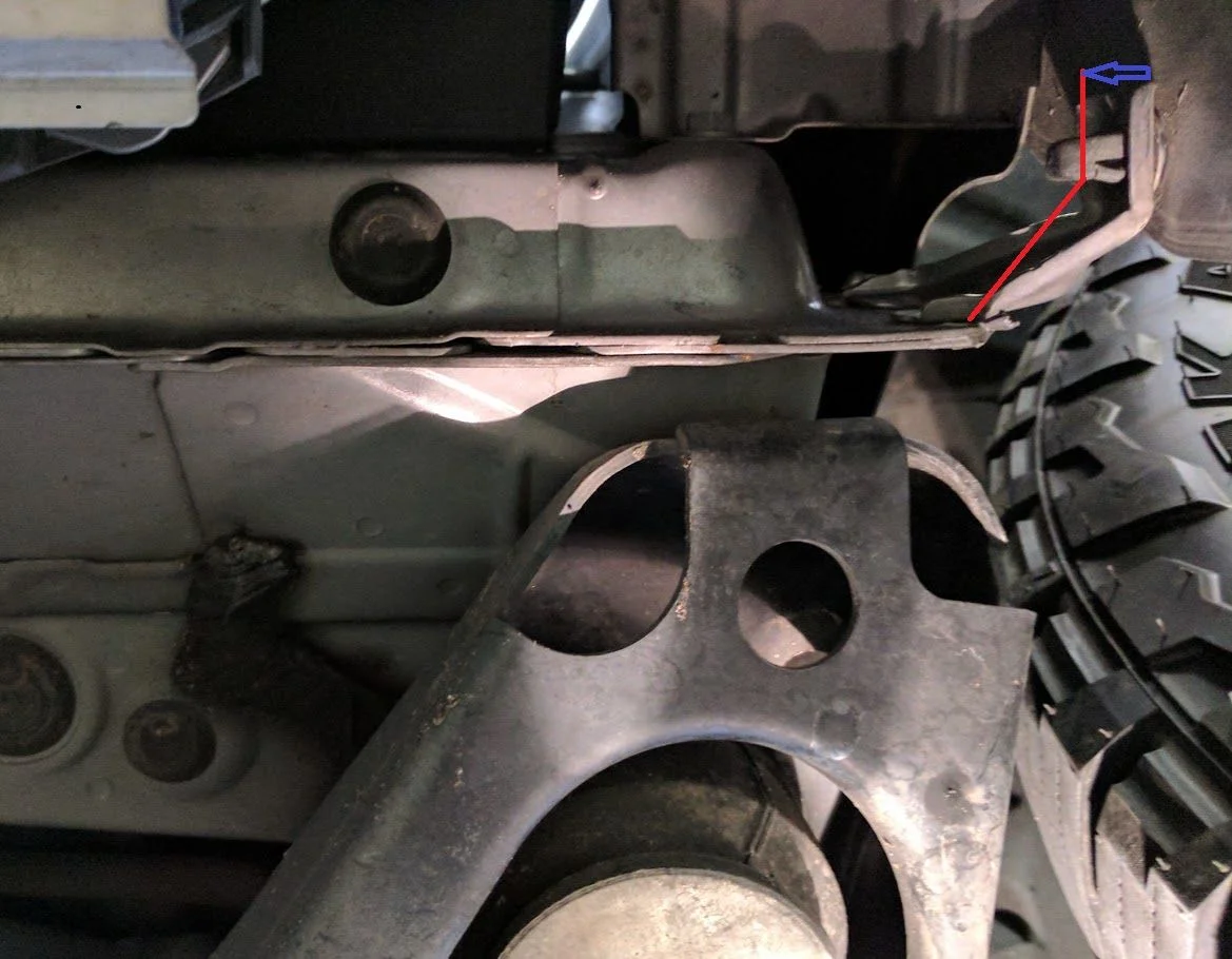

I think you've got the work identified. Just get rolling. I think the slot and screw is much better than the trim for In front of the front tires.
You'll probably have to break off the little sheet metal bracket for the running board behind the front tire. Then a bit of heat molding and you're done.
Thanks @grinchy! Do you happen to have a picture of the bracket you're talking about? Will it be apparent once I'm in there? I'll definitely try to make new mounting holes for the front liner then based on your advice. I'll be getting a new Dissent bumper soon (hopefully... stupid Covid) so I'm much less worried about the front than the rear but still like to do things the right way.
There's a good picture of how to prep the liner with a new slot and hole in this thread. Once you "push forward", you screw the stock Z clip in the new area.
(also a pic of the metal bracket in that thread)

Lowest most screw is the bracket I had to break off.
then Shape and reattach the plastic back with a method of your choice, I used zip tie.
Thanks Grinchy, I know the one you're talking about. My tires are barely clipping the edge of the rocker panel so I may try to trim them and leave that screw in place. Not sure how it will deal with being offroad but I'll be sure to have tools to deal with it if more trimming or cutting is needed.
For the rear of the fronts, it's just removing the flap and then heating and deforming the step and rocker rearward. I made mine stay back with zipties and it's held for 1 year+ and all sort of wheeling. The front was a series of trial and error with a heat gun. If you have a lift it goes much faster. Heat, mold, put tire back on, turn wheel, remove, heat, mold.... Until it doesn't rub anywhere. Then you try it on the ground. Then you try it in low mode. I did not make any new holes in my liners.
