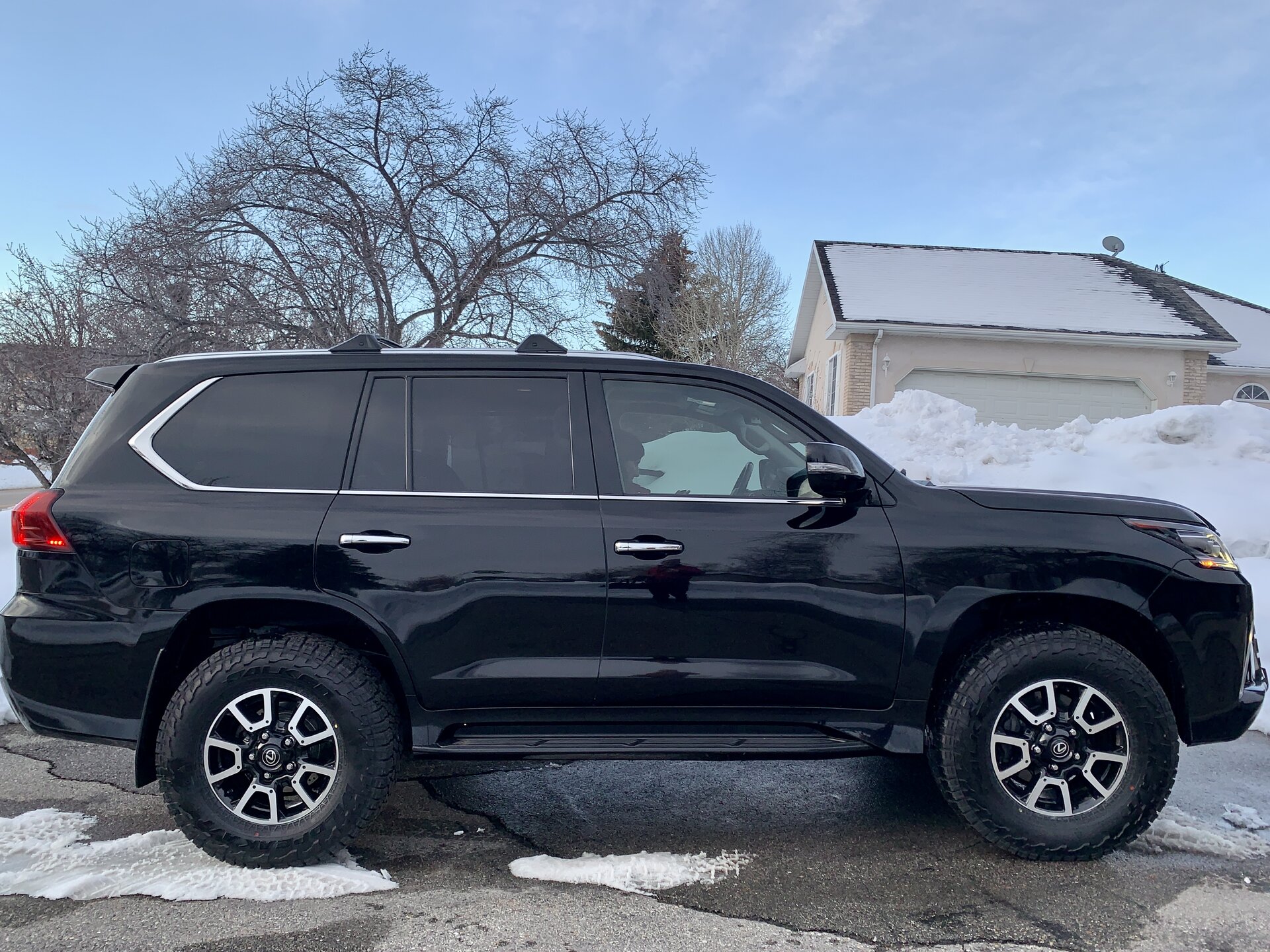

295/70/18 not as easy to fit as the internet said...but it looks great. Tundra TRD wheels with 1.25" spacers. Trimmed some plastic, heat gun to the fender well liner and then shifted all the plastic on the front lower area forward. Only a little rubbing on the side step plastic piece (just needs more trimming). I also got the spare in with about 2mm clear of the panhard bar.
View attachment 3289549View attachment 3289544
You’re the second ive seen black/silver with these Tundra wheels. It looks great!
This year is hard to get wheels to look right on it. I dare call that almost a factory look. I wouldn’t even think they are from another model.

For the next guy, 1" spacers (~35mm effective offset) can make this fitment easier still.

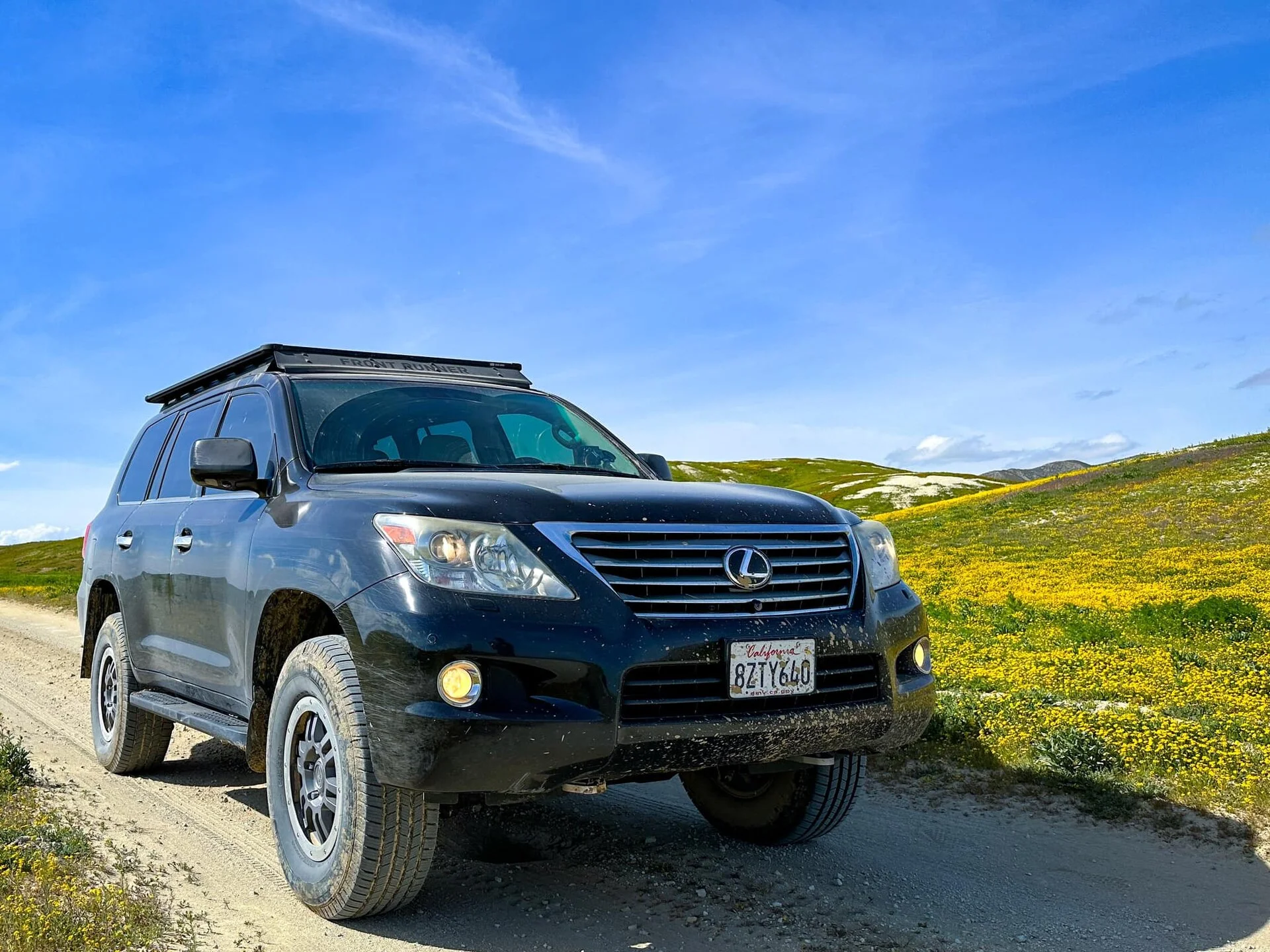

What kind of tires? The tread looks similar to what I just put on mine: Michelin Defender LTX M/S 285/60R18 120H
Correct they are Defenders! Went from a dedicated AT tire to these after I read up on how well they do in a majority of terrain conditions. No punctures yet and I did some gnarly stuff in Anza Borrego
