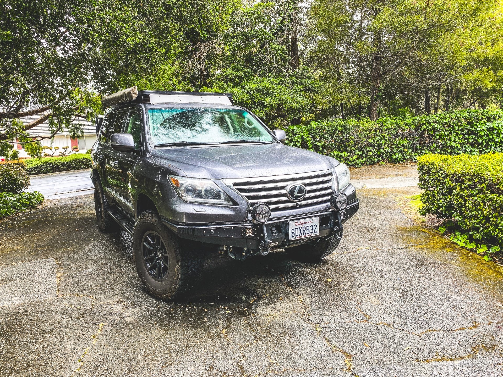

Finally got these on.
Cooper Discoverer AT3 XLT 285/75/17, 35psi
Alphaequipt Echo 17x8.5 +35
Removed mudflaps and it seems to articulate most of the way no issues. Need to push up the front a little bit and maybe trim the inside of the plastic from the sidestep but honestly it's really minor. Really happy with the ride and it's noticeably quieter so far than the lightly worn Nitto 420s tires the vehicle came with
You might get a tiny bit on the top of the wheel liner.Looks fantastic, @JohnnyBeagle. Exact tire, and tire size, I'm thinking of going with. You have sensor lift, right? Think the rub would be about the same without the sensor lift? I'm trying to find the ideal wheel/offset to get without spacers, to avoid as much rub as possible. Ideally I'd like to avoid the sensor lift and take care of any rubbing through the normal trimming, mudflap removal, and fender lining push forward, but imagine the sensor lift will be necessary anyway. I'm not sure which number in the +30 to +50 range is optimal for this.
No sensor lift. I had an issue with the driver side corner sitting low and the dealer bled the AHC system several times and tested the accumulators and got it back to sitting within 1/4" side to side. I got it back yesterday and immediately put the wheels and tires on in my garage but didn't adjust the sensors. Drove it 60 miles today and it doesn't seem to have rubbed the top of the liner, and the only witness marks I see are on the front.Looks fantastic, @JohnnyBeagle. Exact tire, and tire size, I'm thinking of going with. You have sensor lift, right? Think the rub would be about the same without the sensor lift? I'm trying to find the ideal wheel/offset to get without spacers, to avoid as much rub as possible. Ideally I'd like to avoid the sensor lift and take care of any rubbing through the normal trimming, mudflap removal, and fender lining push forward, but imagine the sensor lift will be necessary anyway. I'm not sure which number in the +30 to +50 range is optimal for this.
