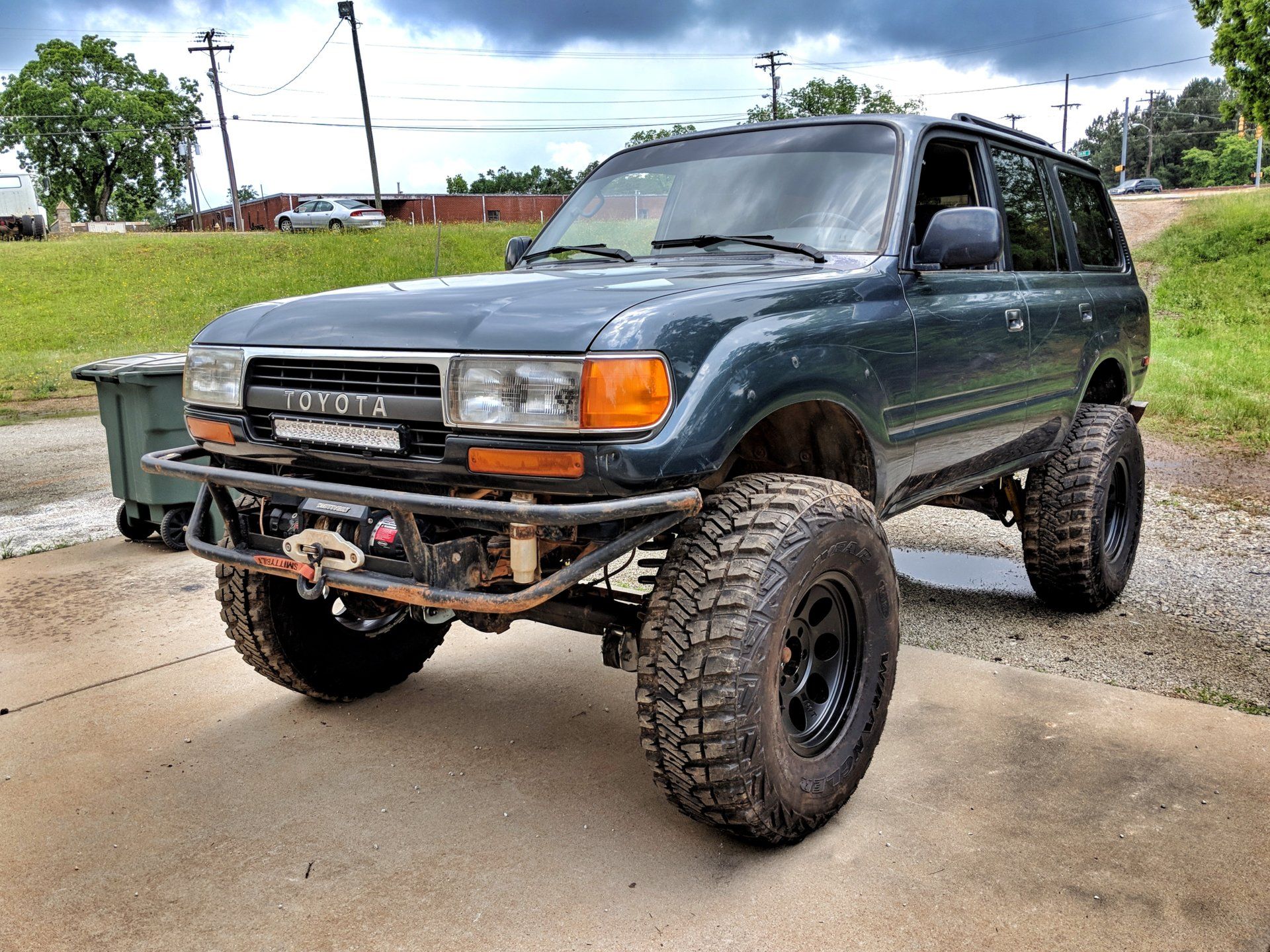

37s with a 2.5” lift stuffed good in the cut wheel wells. Still need to get my rear bump stops dialed in. Only Rubbed once last weekend. finally got some used 3/8” longer lower links and adjustable uppers off @jcardona1 installed which helped quite a bit.

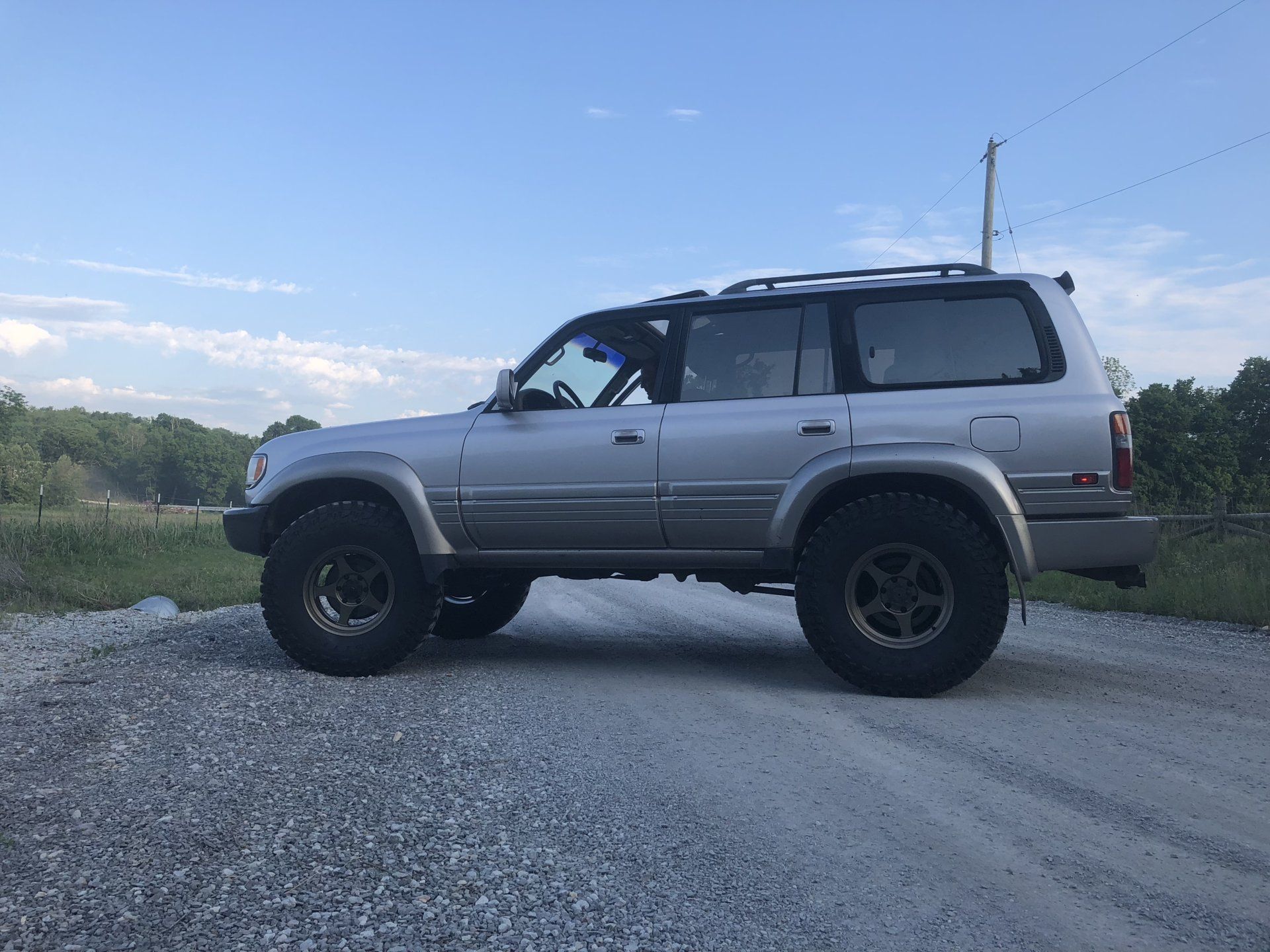

need to lower it 1-2 inches and trim the fenders. this was immediately after the lift, shocks, caster plates, and tires.. much different than when i bought it lol

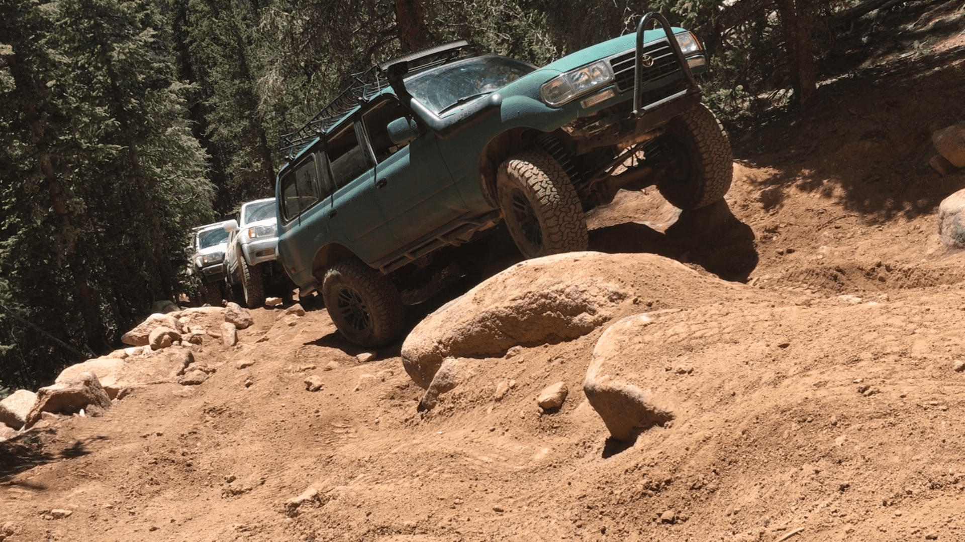

Wheeled a familiar trail on the 4” Dobinson Flexi. I am so over trying to trim lift height - so much more capable with the extra clearance.

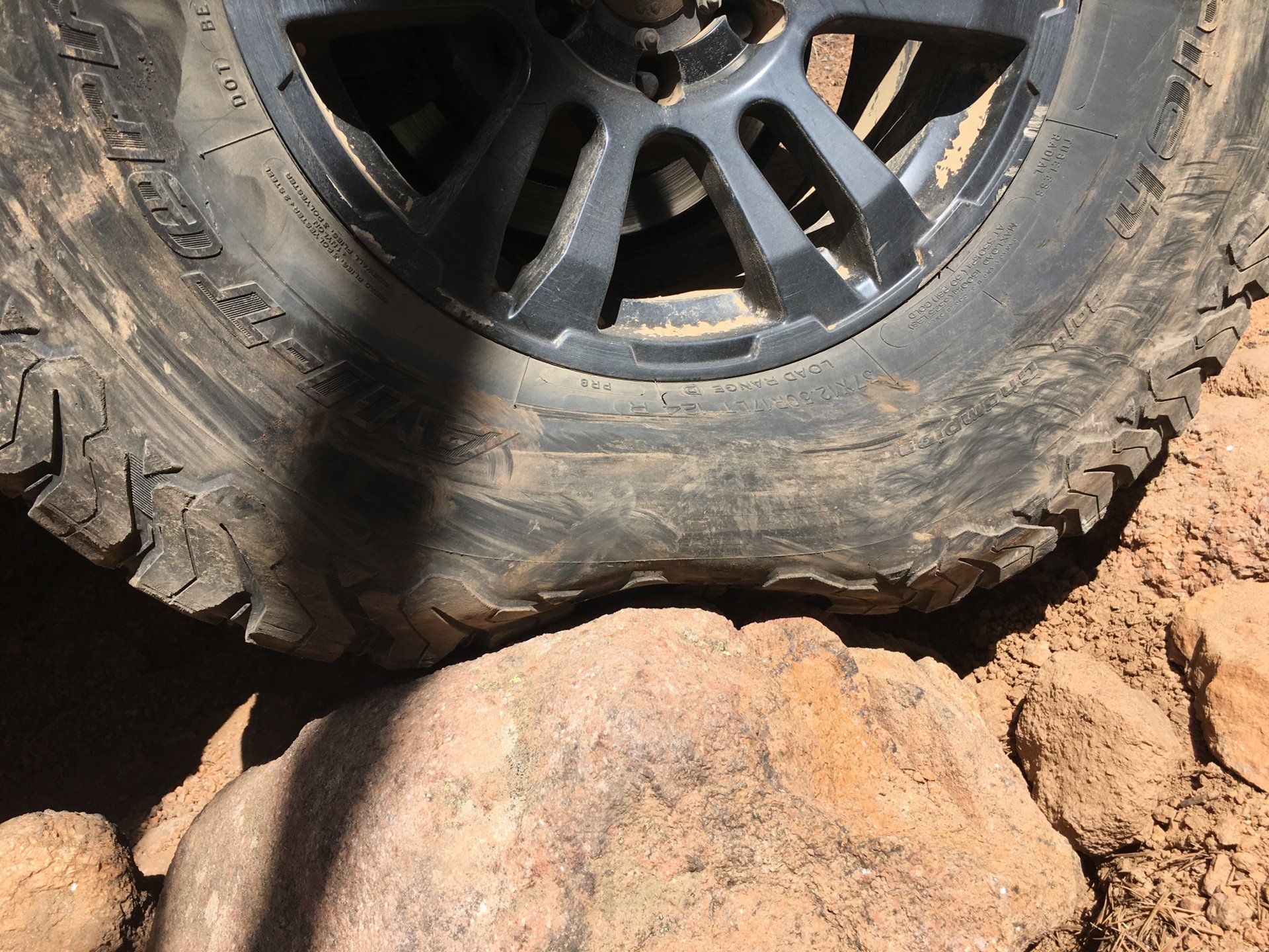

It’s hard to overstate how good the ko2 has been. Ice, dragging it frame deep in a blizzard until all four where spinning in idle, 43K miles and still crawling like a champ with 7/32 tread depth remaining, still quiet and riding like new, never needing a rebalance.

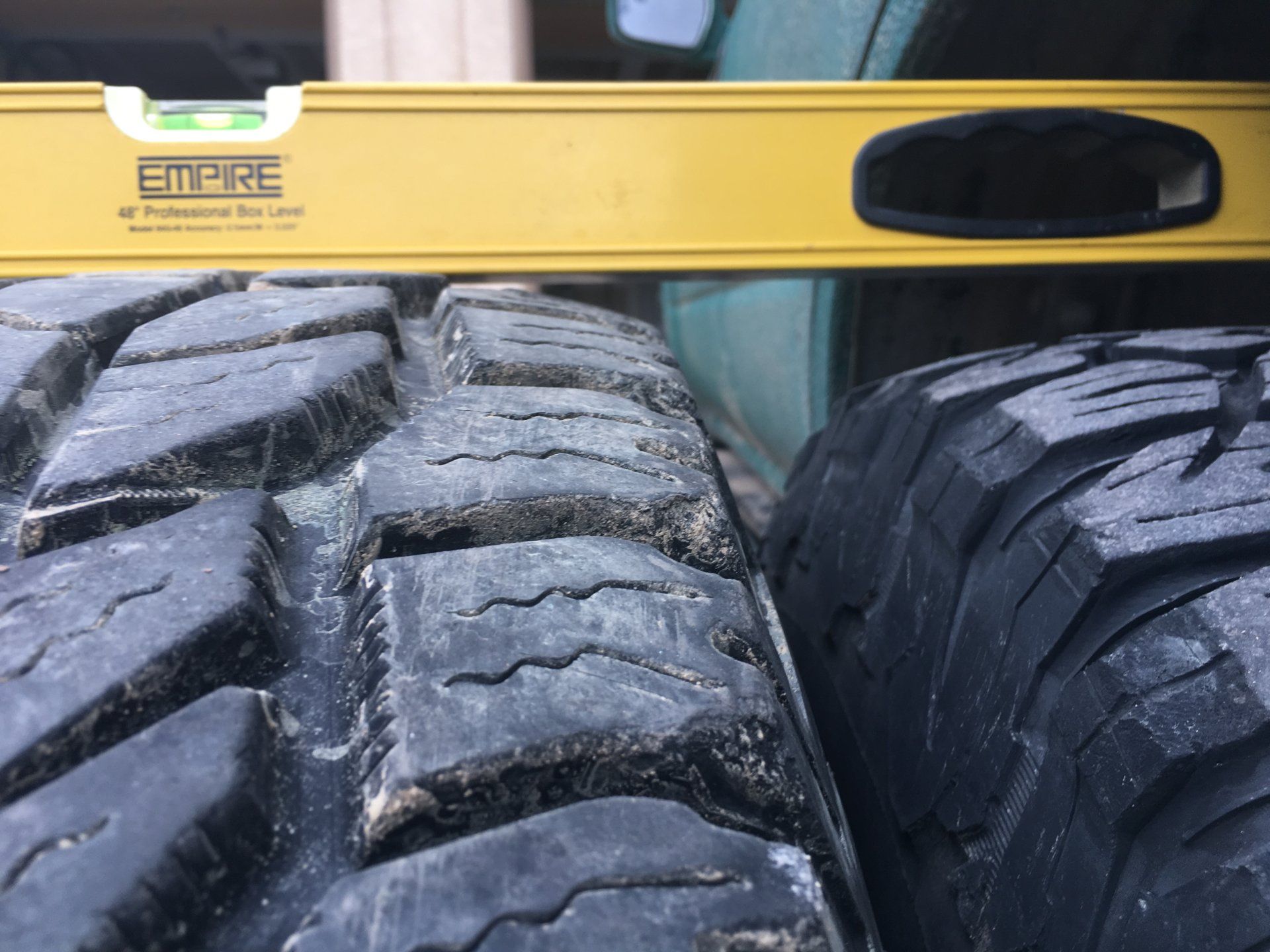

I’d have pulled the trigger on the ko2 again or the 37” KM3 if not for the size issues. I can run a Cooper and go back up nearly an inch in tire size on a 37.
This is the Cooper AT3 on the same rim with the weight off the ko2 so there isn’t the mounted v. unmounted height issue. Even giving back 1/4 for tread wear, the Cooper is nearly 3/4 taller.

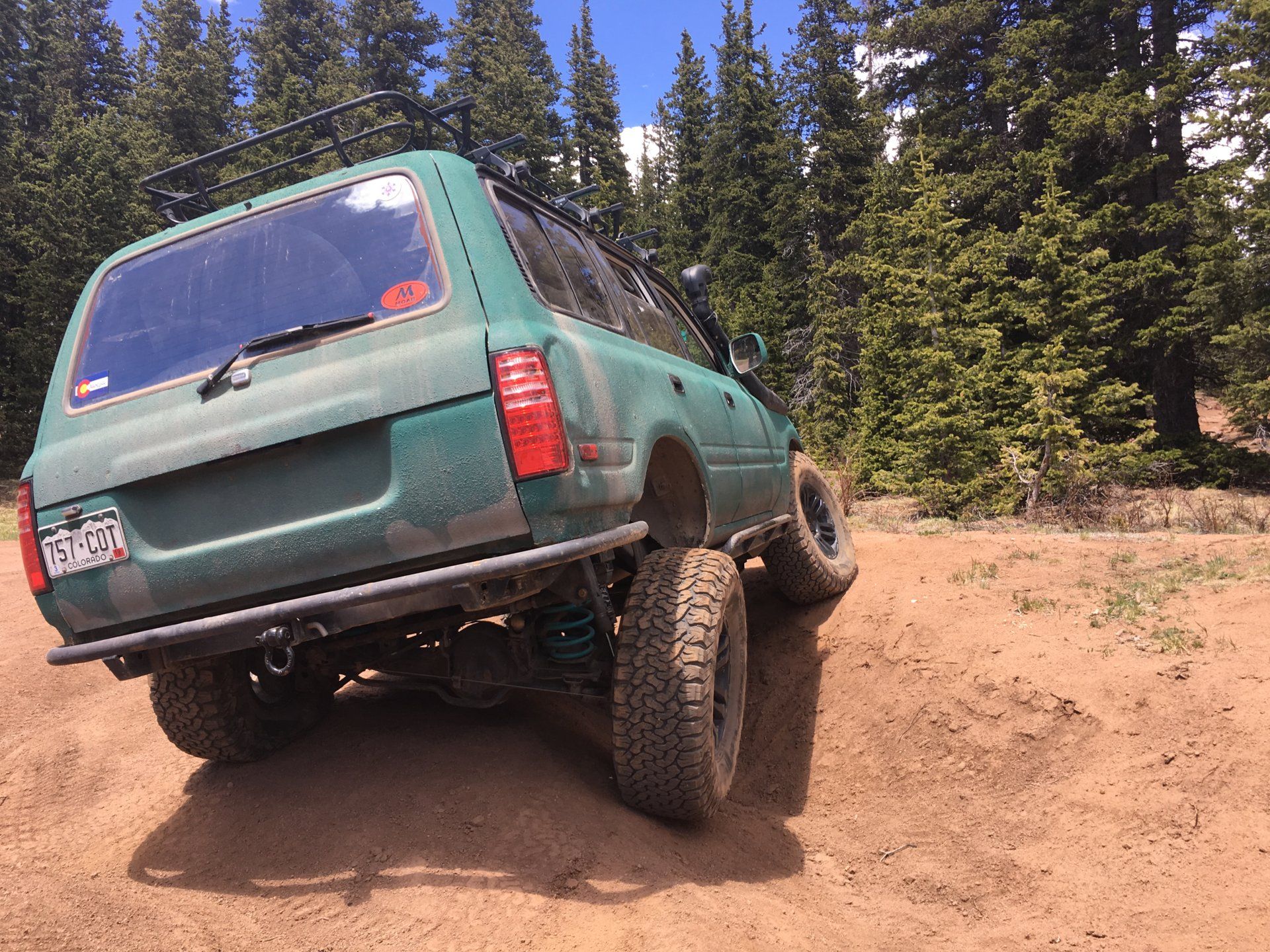

This is a great suspension for a lighter weight crawler. I have the spare 37, spares (axle shafts, etc) and basic tools in the back so 200 lbs or so.
The rear coil is just nailed in how much control and stability it provides, but it does make a smallish 37 look....smallish. I took this pic at this angle to make the tires look bigger.
Edit: found a better one that really shows the lift. I usually ass drag around on more technical trails and never made departure angle contact once yesterday.
