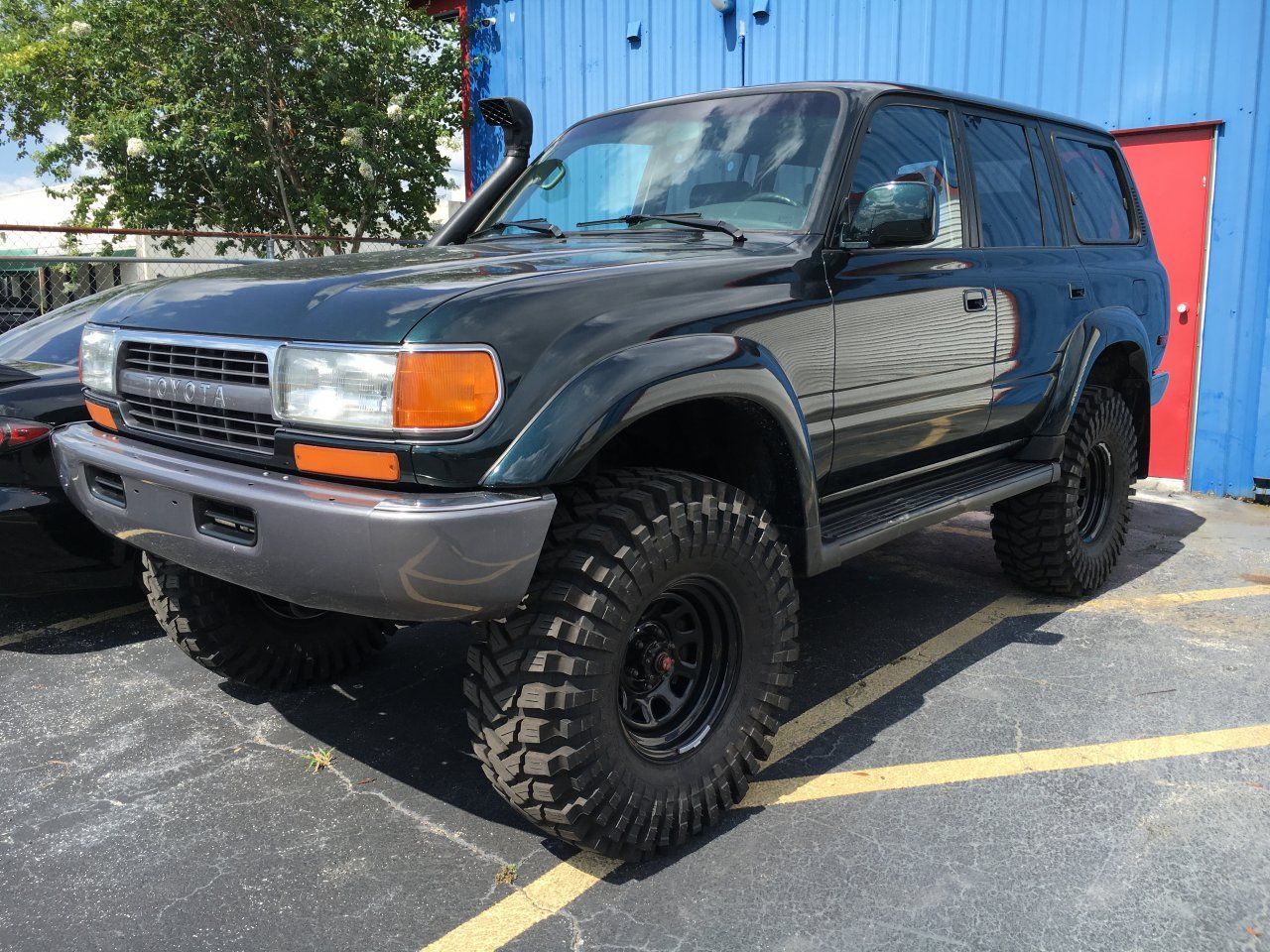

Prepping for tyre size, will have more pics as we go.
38.5 michelin xmls no lift.
All stock as of now but will gusset, add chromoly and change gear ratio down a tad.

Got my new tires mounted this morning. 38.5x11r16 Boggers. Flexed the suspension to full dropped with front wheels turned in every direction. Only contact was the back of front wheel wells. I cut about a 3 inch arc and pie cut the inner fender and hammered it up. No contact at all now. Can't wait to wheel it.
