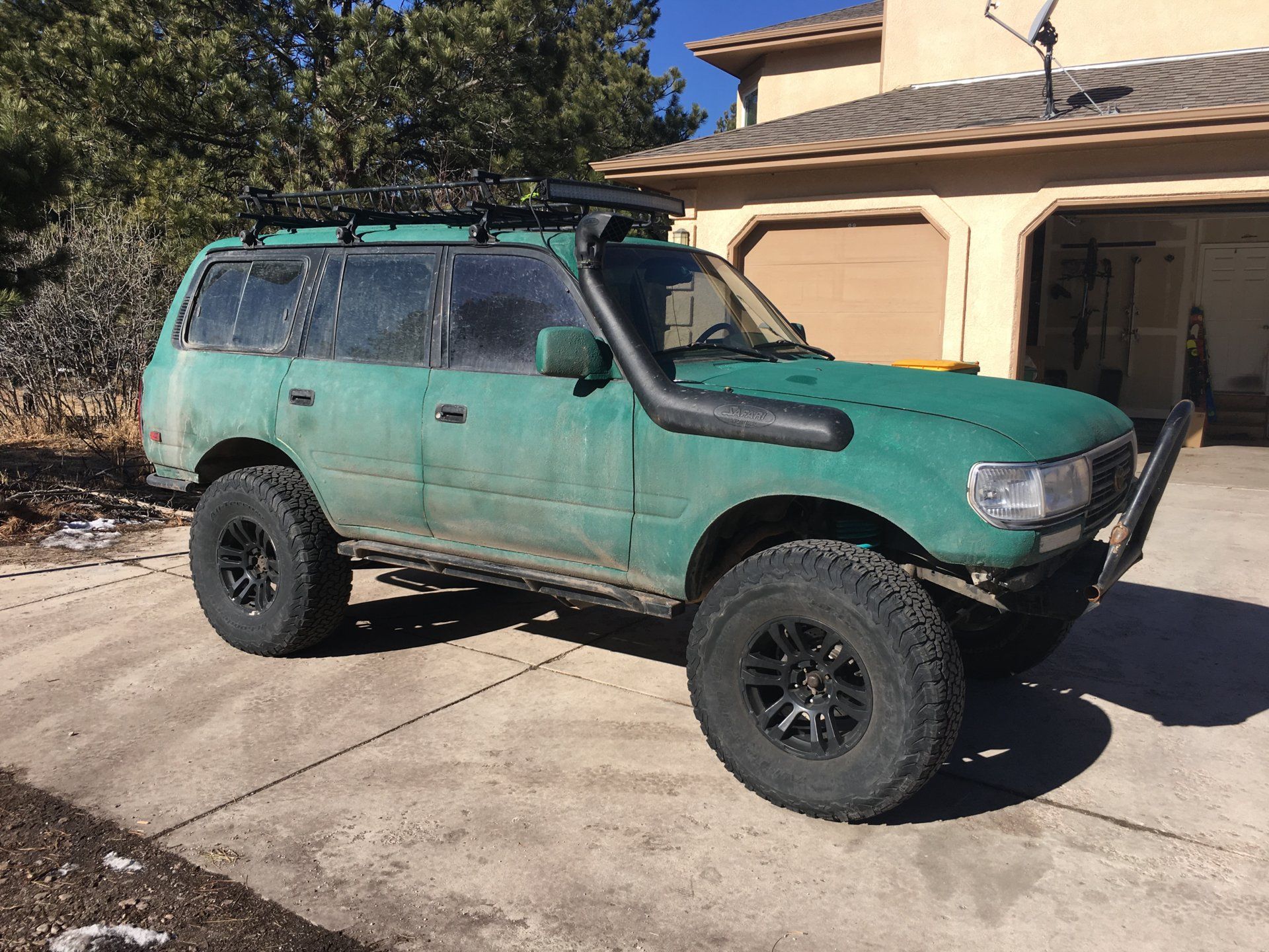

Could be an old photo though.
Yeah I didnt comment on the photo because i wasn't sure since the coils arent visible. I wouldn't use that photo for any sort of decision making since its far from flat ground. @Nay needs to post up a parking lot shot for you to see how the 4" looks.
Is this photo with the new Dobinson's or before? Did you end up getting 3" or 4" Flexi's?
It’s before - I got the 4” Flexi after my accident in Nov because one of the front F.O.R coils was damaged. I picked up an inch of lift.

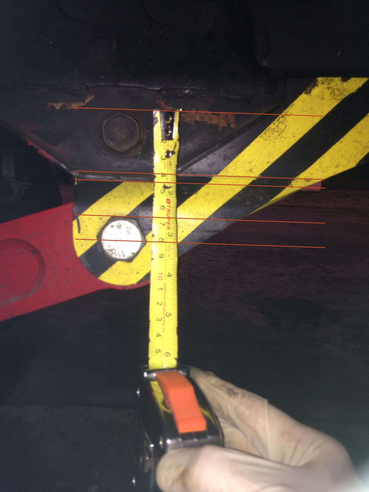

Thank you i really appreciated, i'm doing the calculations, but i have trouble measuring this (photos) i order a 2" drop brackets but measuring it i think is 4", how do you measure, here are the pictures...
