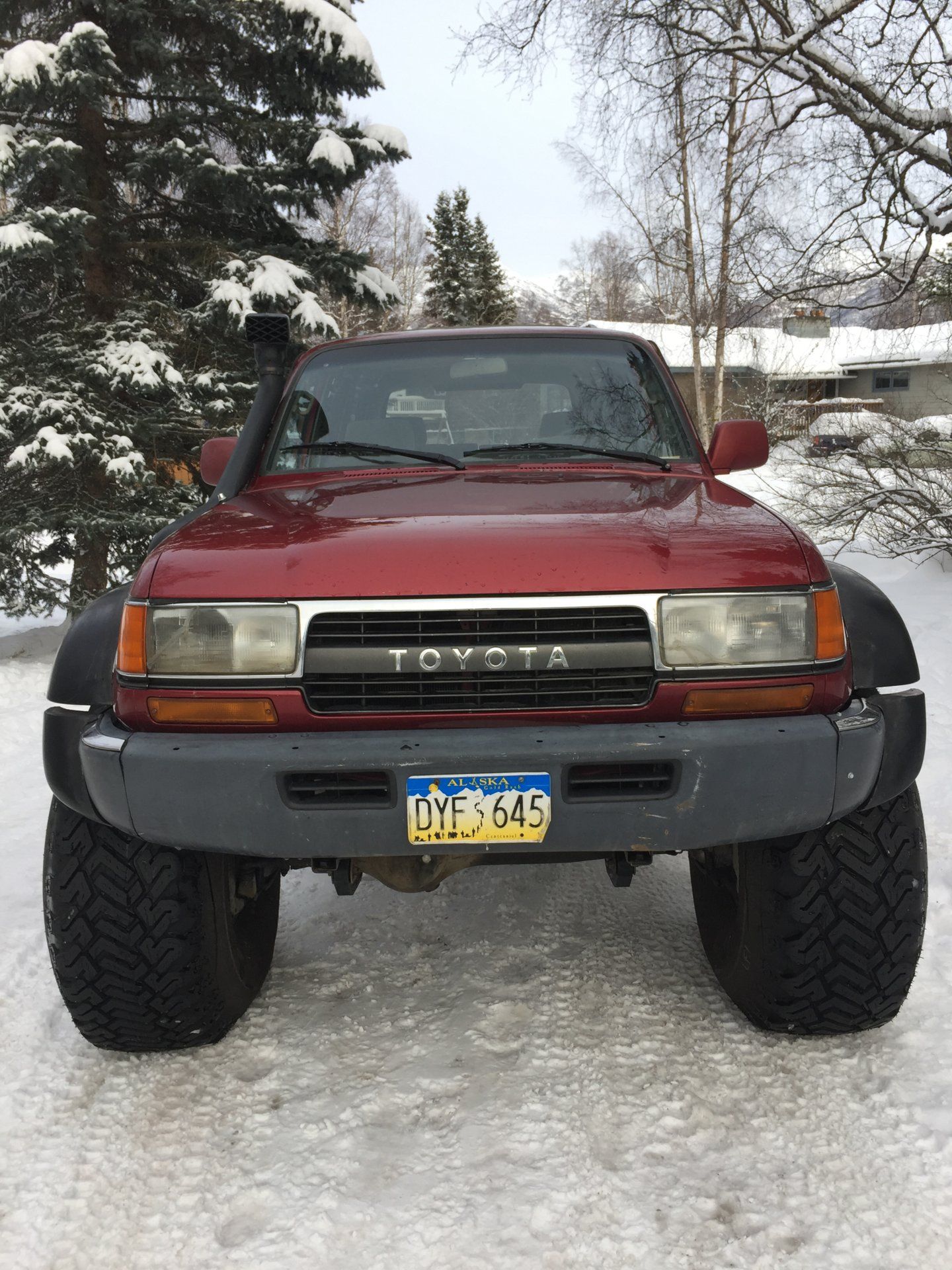

Might as well contribute some Toyota porn to this thread.
44” Dick Cepek fun country (tires trued)
15”x12” wheels with 2.25(?) BS
4” Slee lift + 2” body lift
Rear axel relocated about 6” to the rear
Formverk flares
Aluminum block 5.3 LS swap mated to the 6 speed AT
Garmin pic is 1st freeway trials. 2-3mph more than I would have guessed, but still close & amazing
@aktundra , that is one way to improve your rear departure angle! Looks sharp!

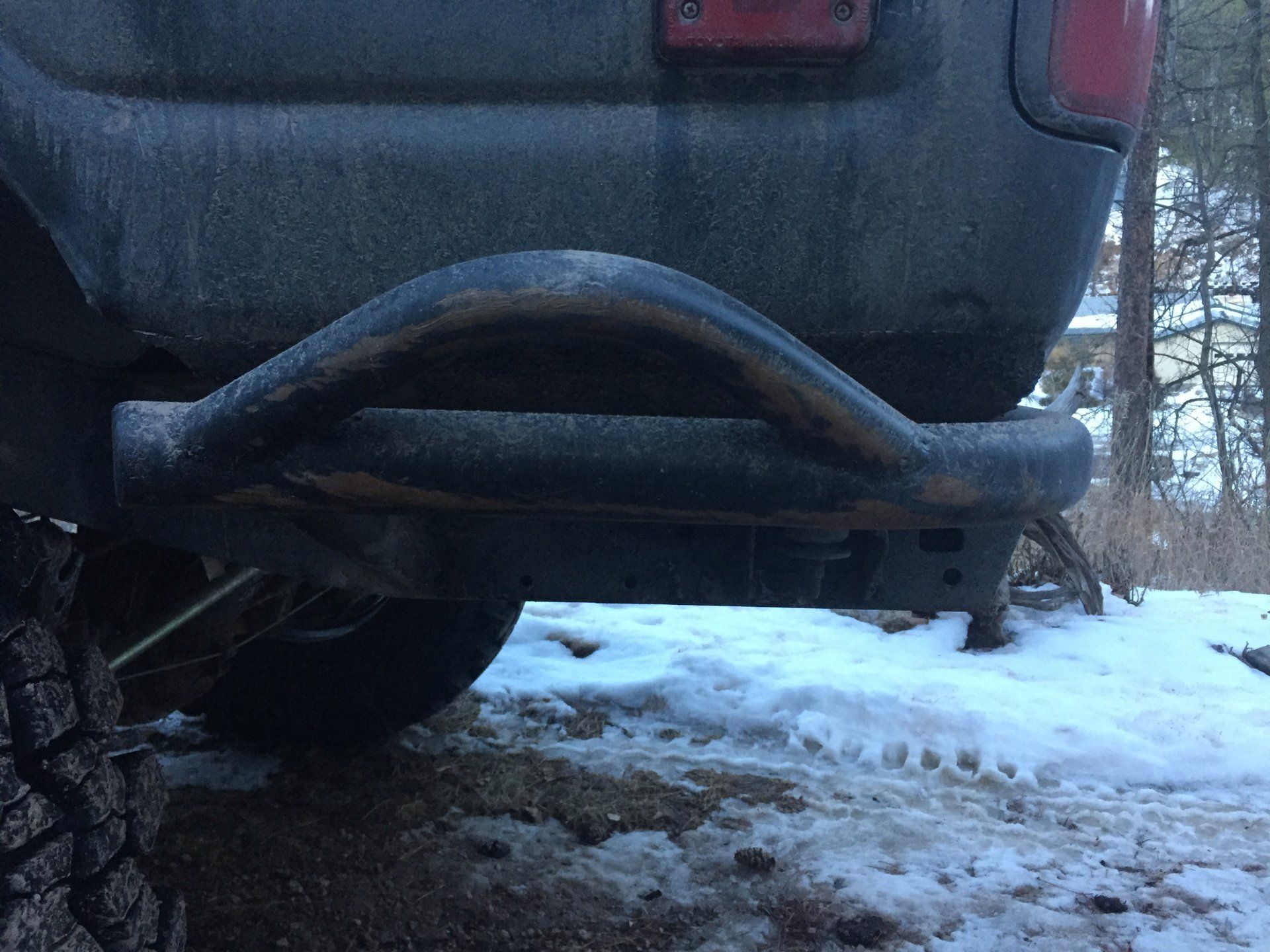

Yup I can climb a lot steeper inclines from starting flat without dragging the rear body on mine. It was rusty behind the rear wheels so I chopped all that up about 6” and removed the rear crossmember tucked it in tighter I lost weight doing so. One of the best things I’ve done to my 80. I do use mine differently than a camp/expedition vehicle though.
Let’s see a better departure angle on an 80 with a tire carrier than this.
It makes such a huge difference to trim the rear frame ears and quarter panels and tuck up a bumper.
There are a ton of people wheeling hard with these armored low clearance setups, and they better be beefy because you are going to hammer the crap out of them.
