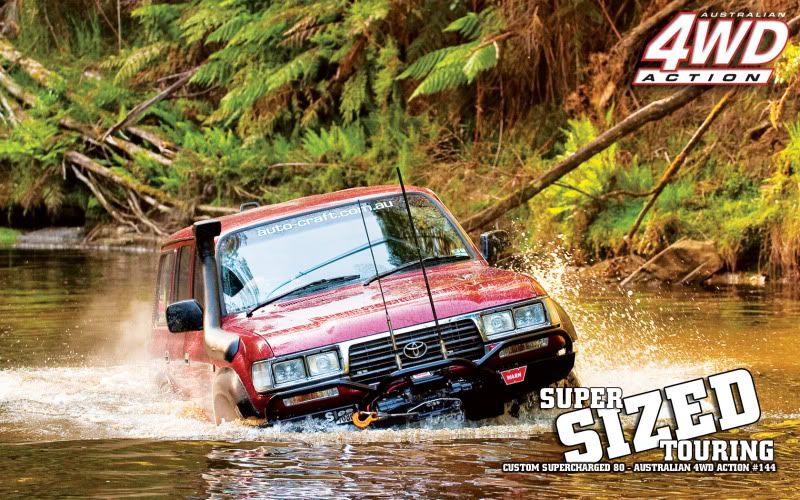

ROOBY
1995
37 x 12.5/17 PRo Comp Xterrains and Muds.
17 x 9 Pro Comp rims and Allied Rockathons.
4.56 diff gears and 20% lower t case gears.
Slinky long travel 3"lift
40mm bump spacers
moved front control arms forward 12mm
made some room with a mash hammer neatly.
Mid 90's, my first 80 on 36's.

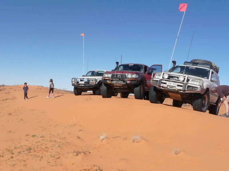

The next 80 I am planning will be 40"MTR's, and all the suspension points moved up so all the arms are at std height, but tubbed inner fenders and new upper mounts will make for 30% up travel and 70% droop using 14"stroke shocks and slinly long travel coils, oh, and it wil be a ute :D
I had 40's on my patrol for a while with 14"stroke shocks.
