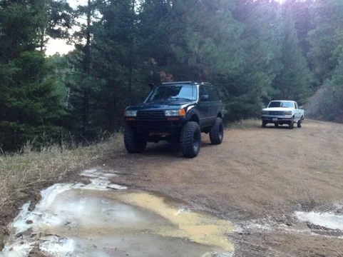

Here is my 93 purchased from Evan938 as a stock triple locked 80 on toyo 285/75-16 Taco steelies. Since purchase I have done a full maintenance of the engine and a work around for the PHH issue. I replaced the factory stereo with a double din DVD/nav unit and replaced all 4 door speakers with pioneers. Cobra 40channel hidden away in the center console with a 48" firestik antenna. I added a safari snorkel a warn XR 10000 and a custom 3link built off of the same design as Shawn Jackson's 80. I used TJM 7" coils front and rear and 1" poly spacers up front to help level it out, stainless braided lines at all 4 corners with stainless drop lines and she now sits on 40x13.5R17 Toyo open country M/T's with black ProComp rock crushers with 3.00 backspacing and the 1" wheel spacers it came with for 2.00 backspace total. No trimming and no broken bits to speak of yet. 4 months and no problems yet" fingers crossed"

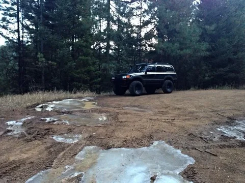

some updated pics, the first one with 37" studded mud grapplers and chains on the back, and the others, it's not a great pic but with 38" geolanders, luckily the chains fit my 38's as well. New bumper and headlights since the other pic on page 4 or 5
