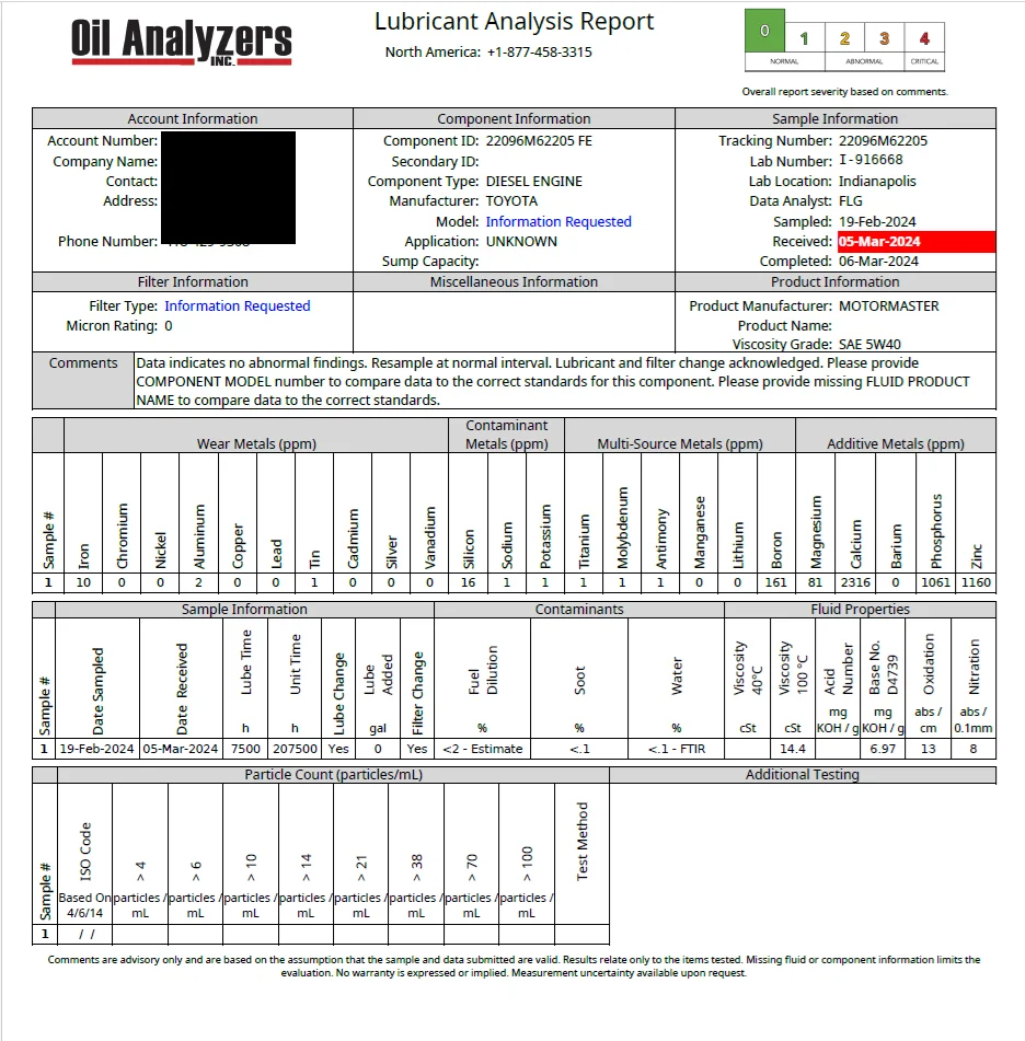

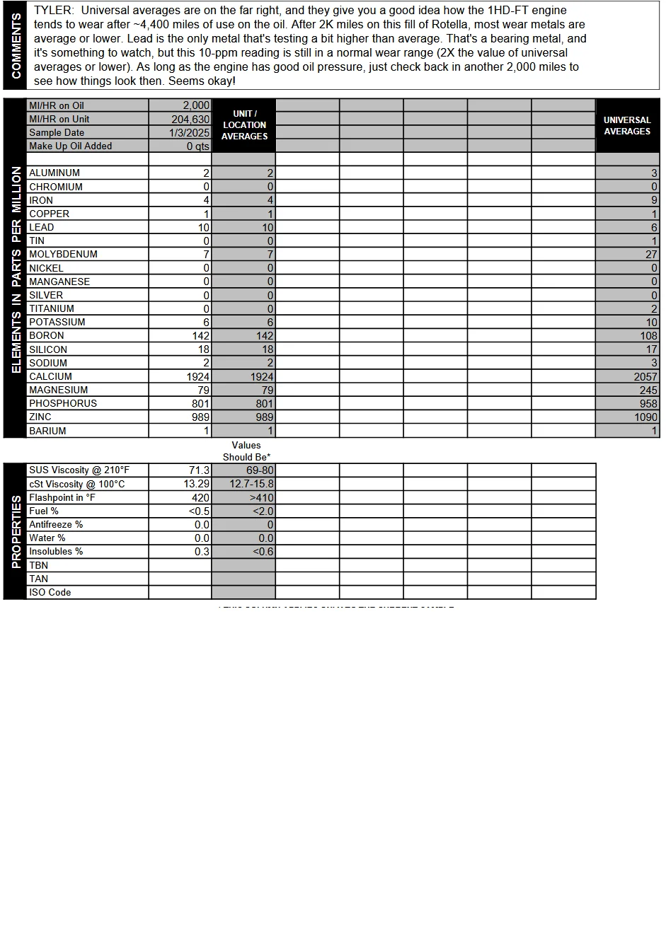

Some more data for the thread, 1996 1hdft, crank is 10/10 condition.
anybody else have any oil analysis data to share?
were these the cerakoted bearings? how many miles on these?
no those are going in my engine, this is a customer's 200,000 KM on them I'm almost sure they are original.
Almost certainly original IMO
Vast majority of 1hd-t in Aussie cruisers have never been opened up.
Guaranteed the average mileage wood be over 200k km

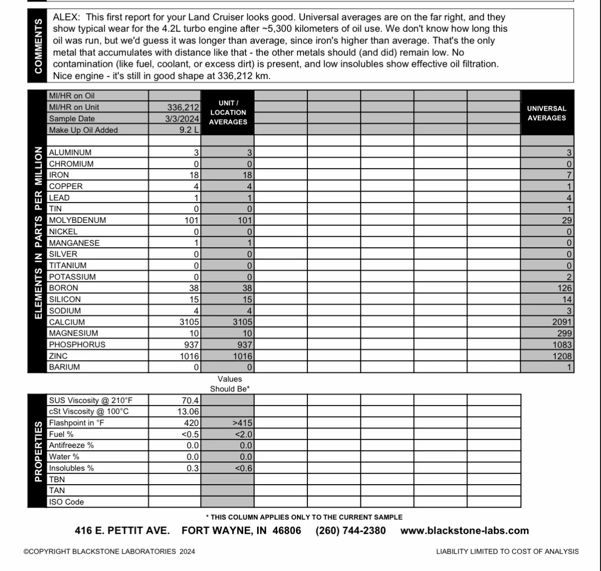

This was my report from about a year ago on my euro HDJ80 @ 336,000km. unsure if BEB's were ever done, but planning on doing them anyways in the next month or two
Posted this a while ago as a newcomer introduction and only just stumbled onto this thread, figured the info would be more valuable stored here.

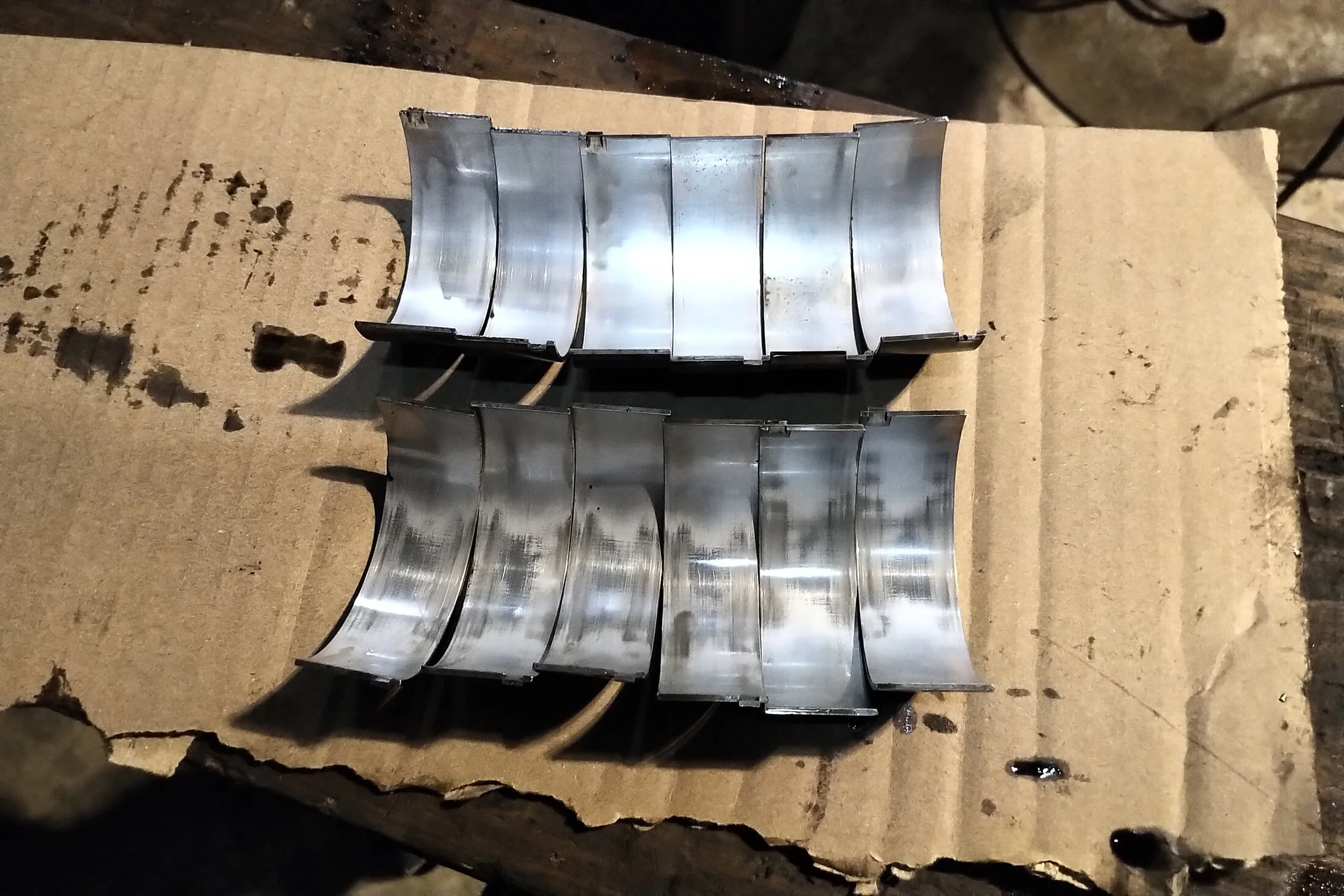

Defused a time-bomb with 1s left to go, I think I was about to send a rod to god.
1994 HDJ80R 1HD-T @190k Miles.
I believe these were the original bearings. Replaced with standard spec ACL.
Ill consider myself very lucky.

Did you say these were changed 2 years ago or you suspect they are originals?
Ive edited my post, that wasnt so clear was it...
I suspect these were the original bearings, previous owner who knew the long term previous owners had it as a belief that toyota recalled the 1hd-t for BEB's. Luckily i didnt believe him.
Very unusual wear pattern.
