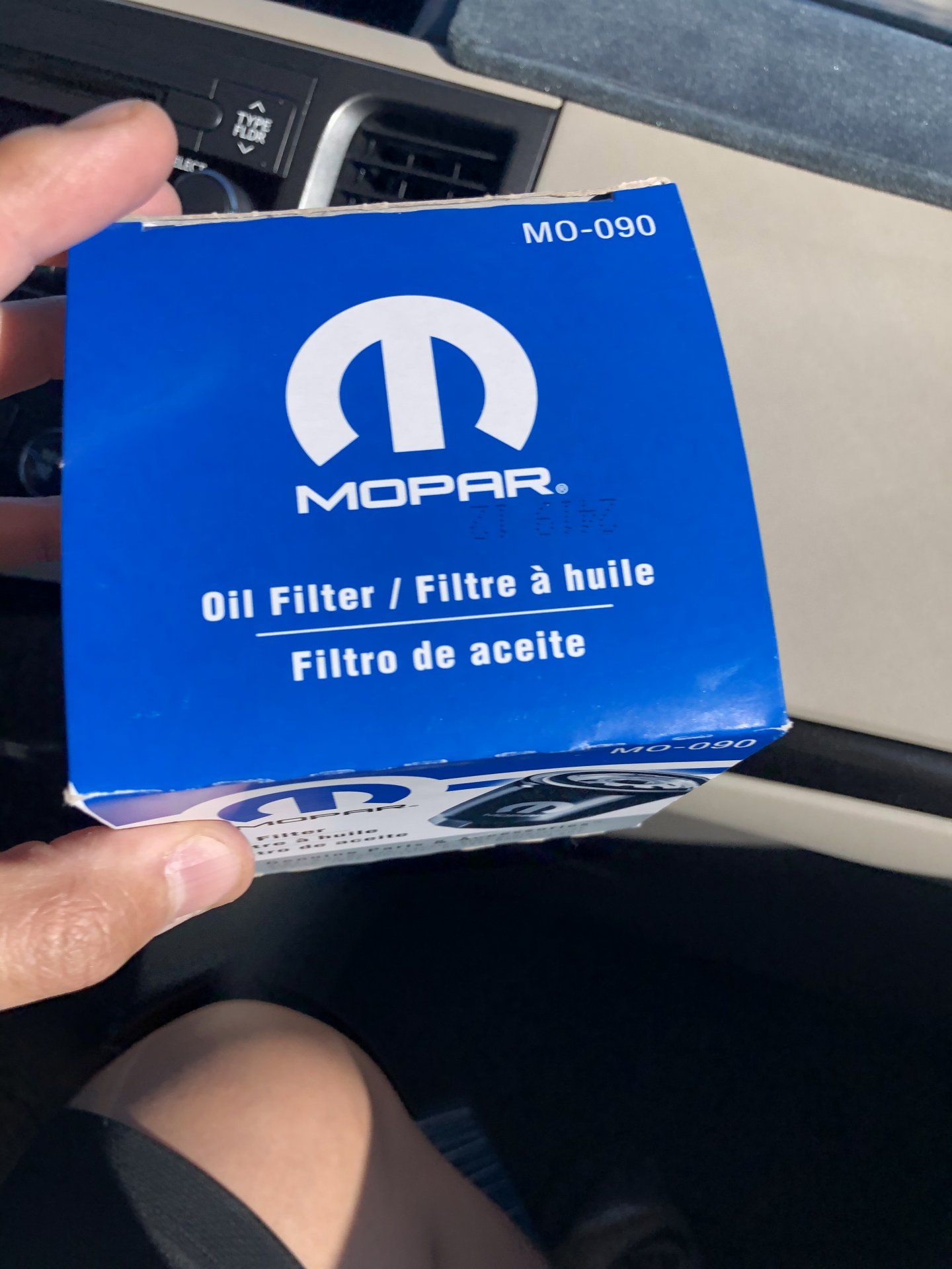

Used a mopar part (sorry). If you are trying to gain clearance for 13bt manifold on a B series moto... use this part M0-090
3.8” tall +\-
You are @cruiserdan new hero utilizing a Mopar part on a Land Cruiser
