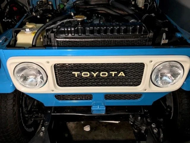

I got the kit installed, WOW, what a difference!
One issue that I have, is that the low beams are staying on with the high beams. This is also not allowing the HB indicator to light. Stock sealed beams worked properly. So far I haven't pulled it all apart to test anything, curious if anyone else has witnessed this phenomenon before I cut alllll those fancy zipties apart.

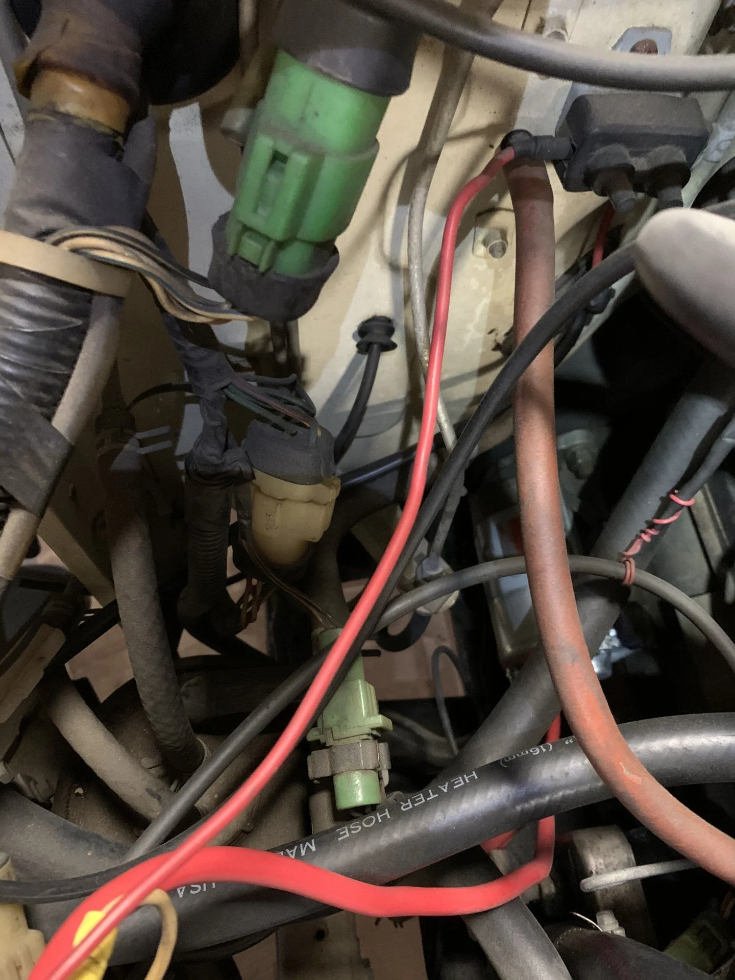

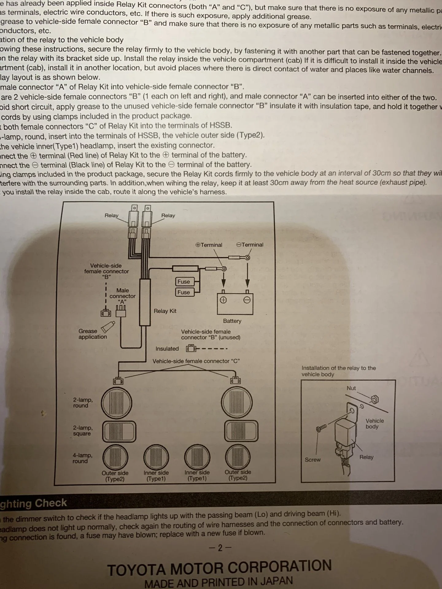

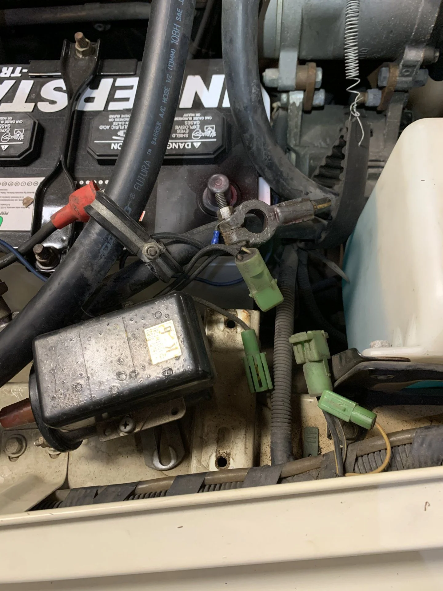

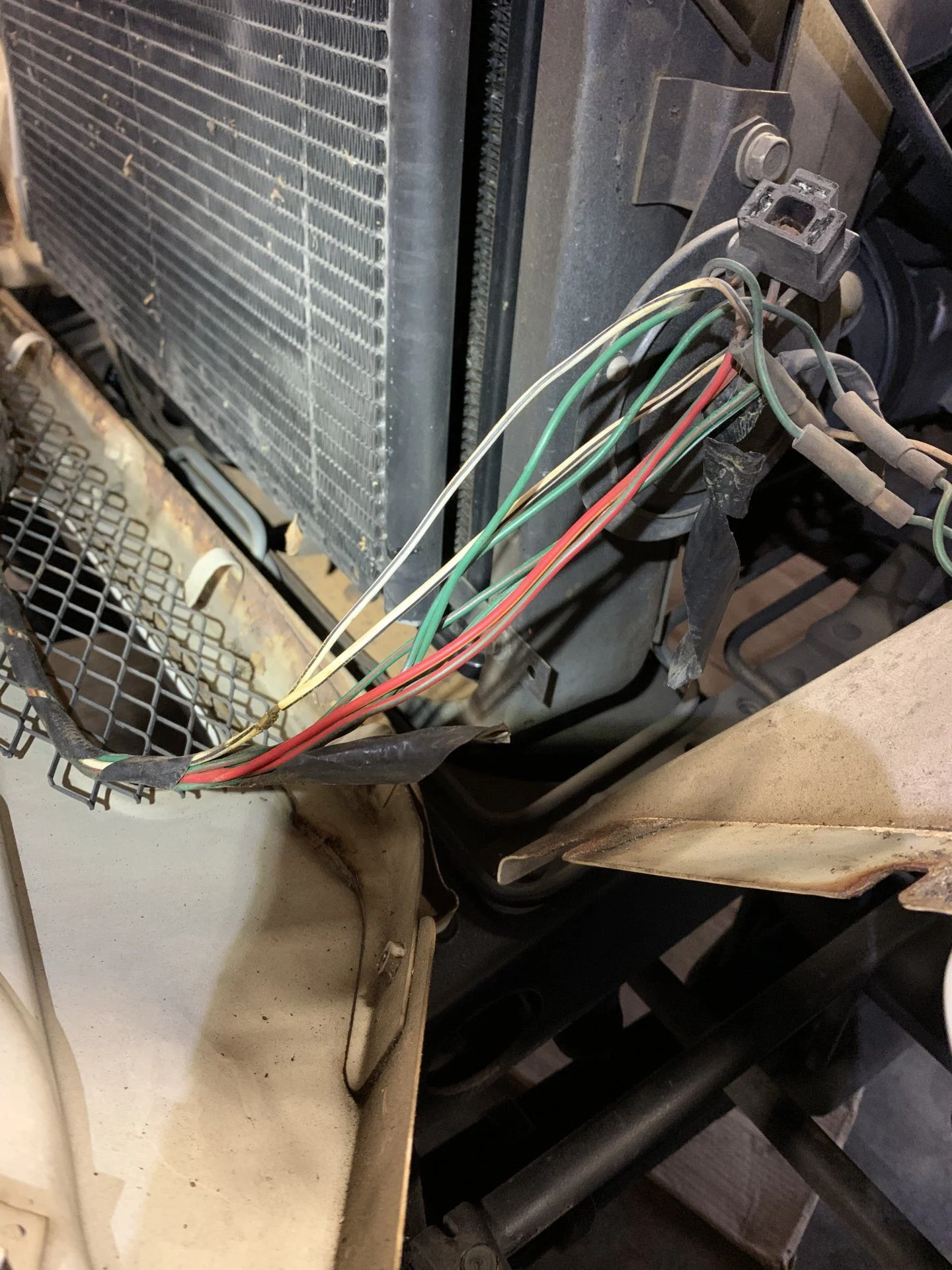

So with all the free time I’ve had lately, I decided to install my new headlights and harness. Now I’m stuck and a little embarrassed. This supposed to be a one banana job. I can’t for the life of me find the “B” terminal. The instructions say there are two. One on each side. Am I blind or did the same dip sh*t that installed the stereo and AC cut them out? Are they in the cab?
