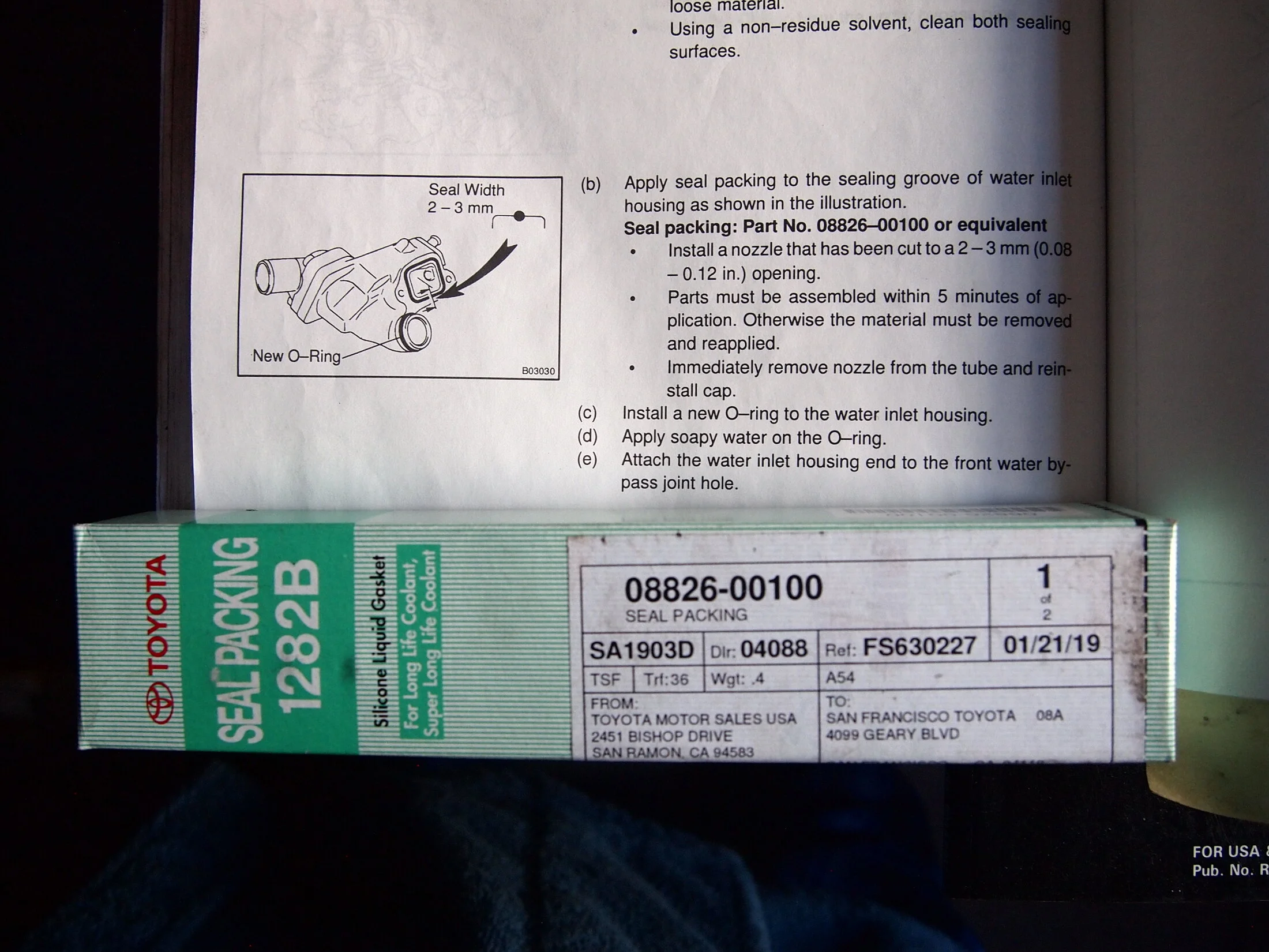

Seal Packing 1282B, Three Bond 1282B or equivalent FIPG is the one you want for coolant.
I believe the part number is 08826-00100, but would recommend you verify.

Toyota 1282B FIPG is only specified for the water inlet housing to water pump only.
I do use 1282B when creating a patch on block and a few other places. When doing so, I let cure for ~24 hours before assembly.

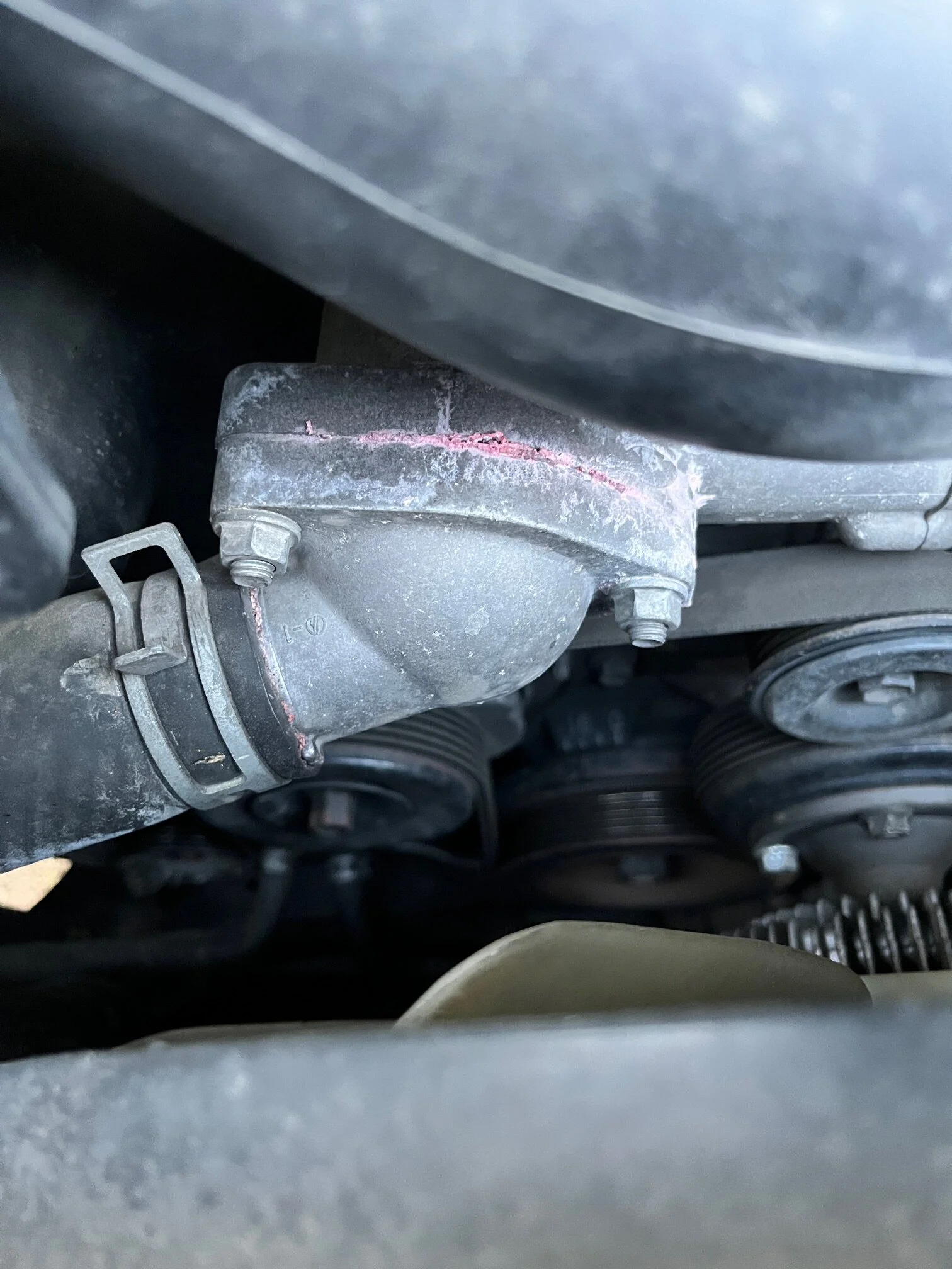

I went back over your post. Do I understand correctly that you advise NOT to use any 1282B on the two parts that represent the thermostat housing?
(The outside half of the housing that the upper radiator hose attaches to and the inner half of the housing that holds the t-stat in place aka water inlet housing)
I guess I'm just wondering because that's where coolant is lightly leaking from and forming a pink crust directly along that seam...
Electrolysis pitting?
Per the FSM no FIPG is applied there. The thermostat within the mated pair has a gasket on it that seals correctly. If the exterior portion of the thermostat housing is pitted you can replace that. The other half (I believe) can be replaced during a timing belt R&R.

I'm also wondering if perhaps the t-stat got stuck closed temporarily and that cause a heat increase I didn't notice that overpressurized the system and that generated the conditions necessary for it to leak in those areas.

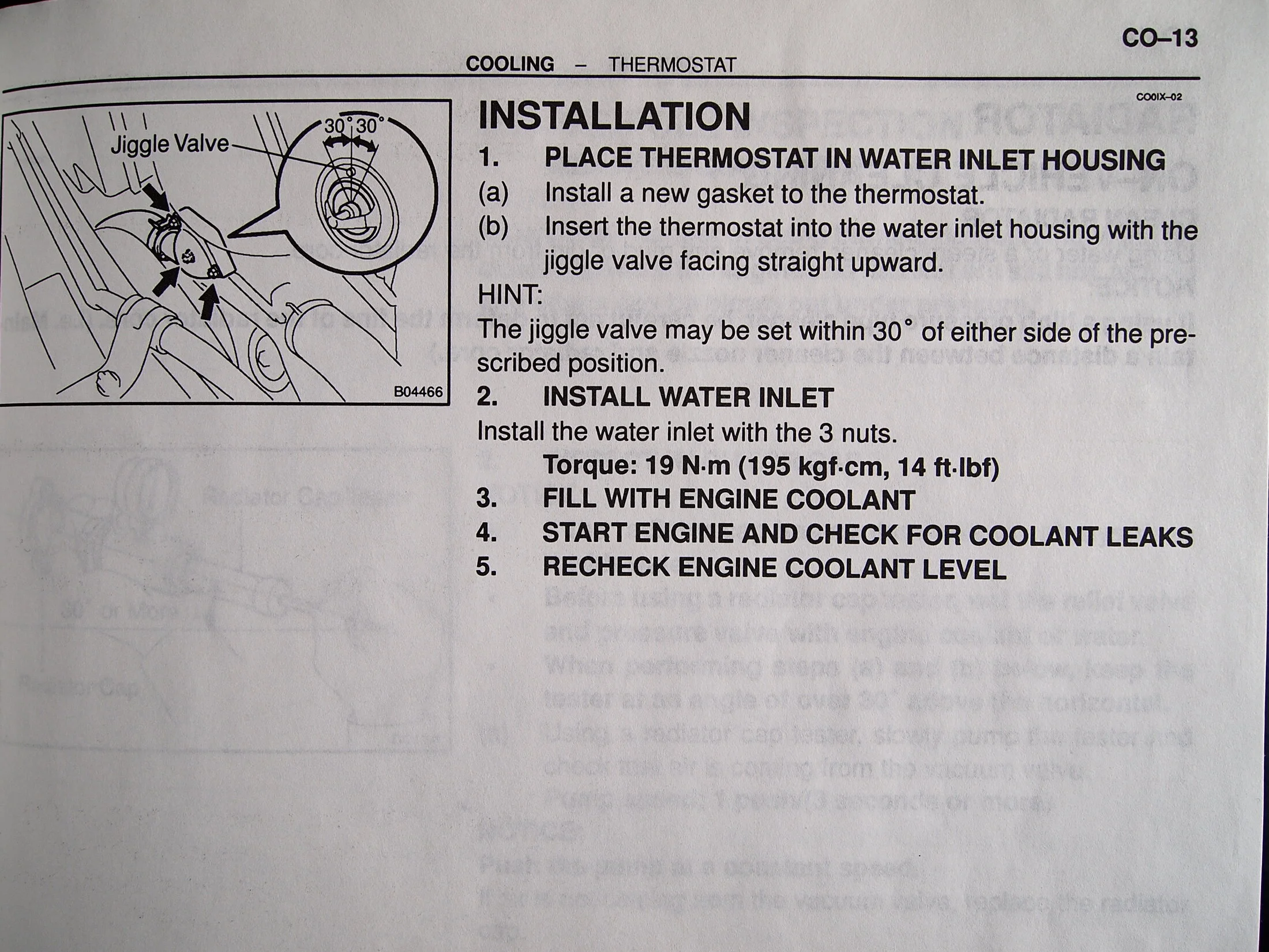

That is correct, do not use FIPG between thermostat housing (water inlet) and cap (water inlet cap) that lower hose attaches to. Use a new Toyota OEM gasket. This gasket, has a groove that thermostat fits in, wrapping around the thermostat. The thermostat with gasket, will try to slip out of position as you place cap on. I use a feeler gauge (thin strip of metal) to temporarily hold thermostat with gasket in place in the water inlet, as I place cap and then nuts on. Sung nuts down evenly work in a cross pattern, with a final torque of 14ft-lbf.
Tip: Make sure the groove in water inlet housing for thermostat is clean a free of pits, and the face of water inlet housing and cap are clean. Do not over torque, we're not plumbers!
Note: If radiator cap and reservoir not functioning properly. Say cap sticking closed or releasing above it specified pressure. This will overprizes the coolant system, result in leaks.

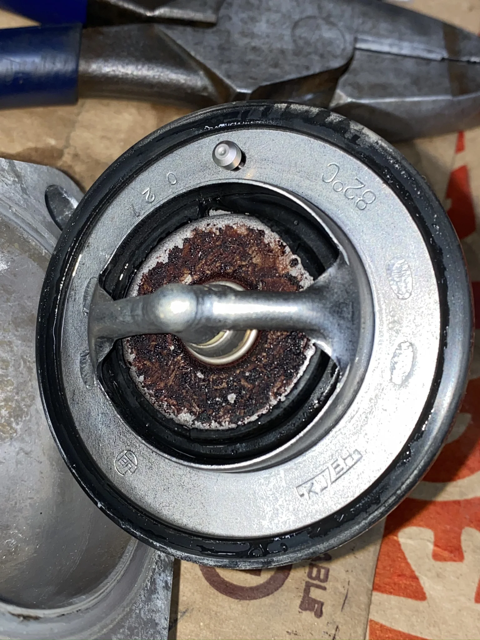

The picture is a old & damaged thermostat, that gasket is still on.

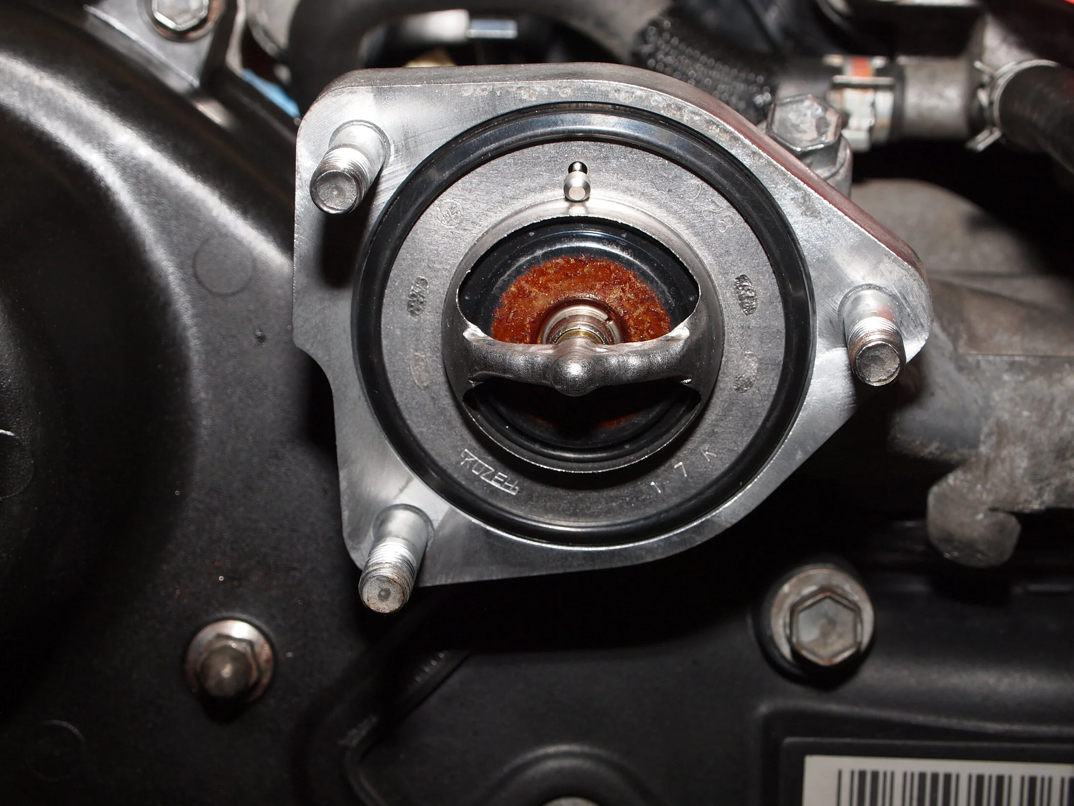

Here's a new thermostat and gasket, in water inlet, befor cap installed.
Ahhh...
I see. the picture of how the inner rubber t-stat gasket seats helps a lot. Thanks!
