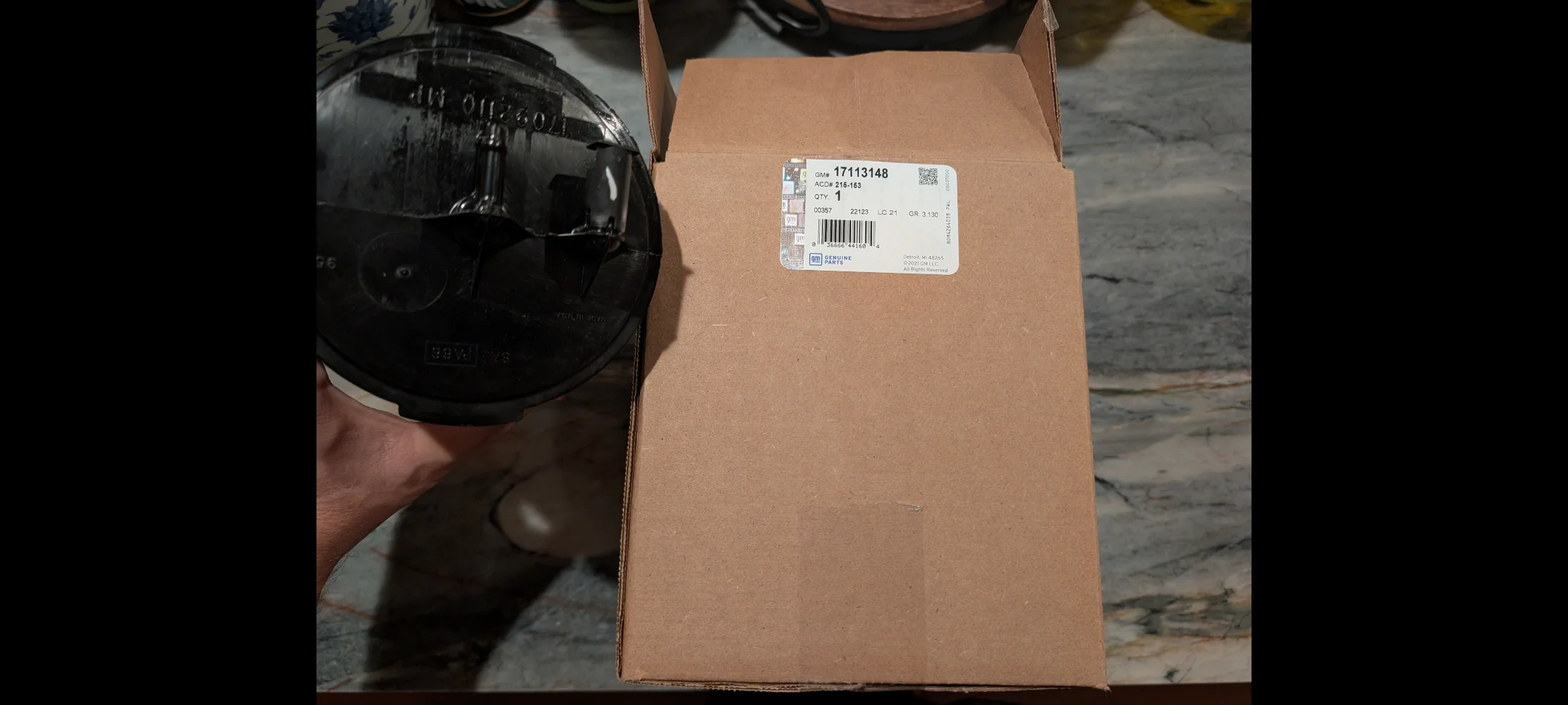

I ordered the acdelco from summit to ensure no counterfeit and many years of trouble free service, I like this AC Delco much better than the vc120 because the bottom is sealed and won't deform over time and fall off.
Just curious, what do you mean the 105 canister didn't work well?
Also, how much modifying did the GM canister require?
It works but the flow rate on it is low causing excess pressure when filling at the pump and driving in the heat.
The 105 canister does not work well compared to the vc120 and I'll be installing this AC Delco soon
The vc120 doesn't have a 3rd drain and installs same as stock, but the vent at the bottom fails in the heat of the engine bay causing a sweet fuel smell in the heat when Wheeling, probably not a huge deal but definitely not a comfortable smell.
The new AC Delco is a sealed unit on the bottom, installs same as stock, easy but with it sealed in the bottom it has a dedicated 3rd vent on the top, you can leave it capped to atmosphere or run it down to the factory frame drain/vent.

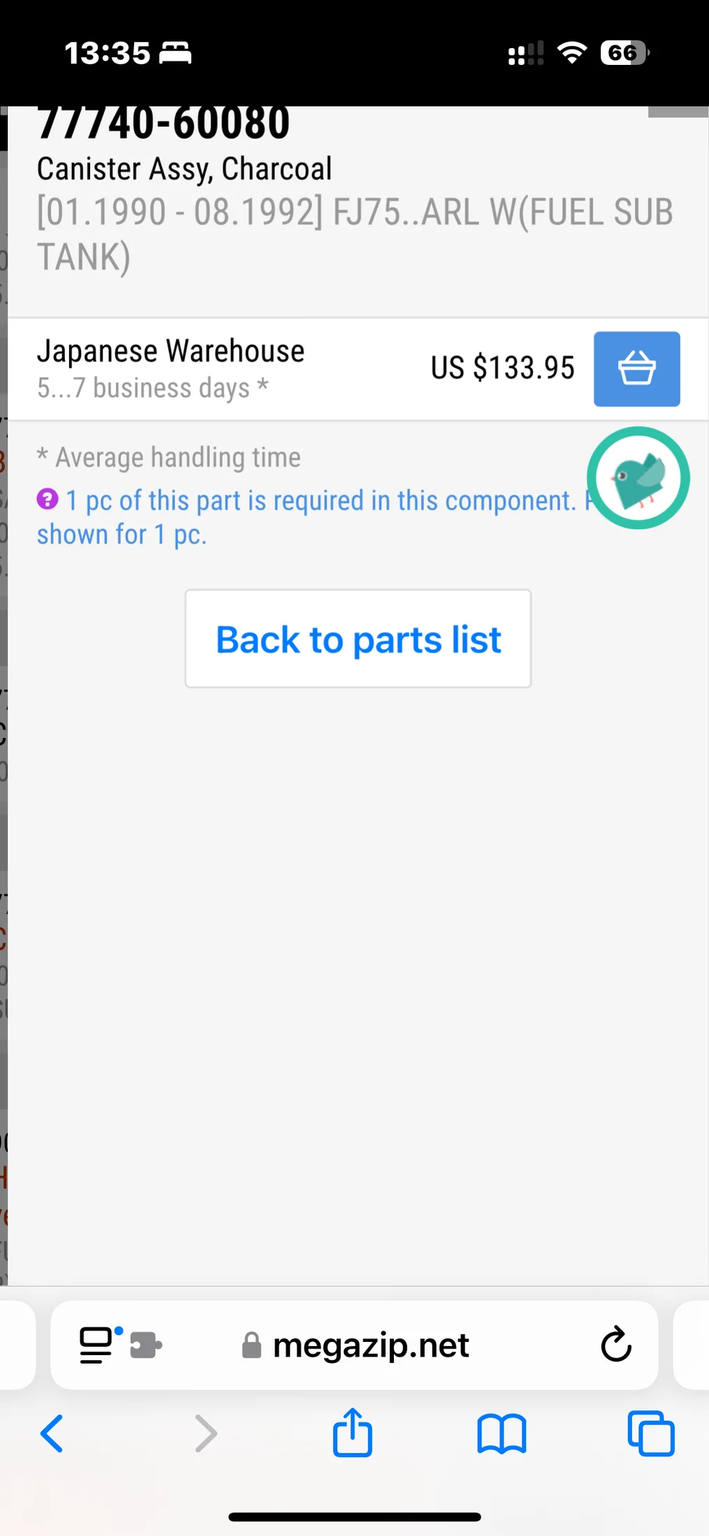

77740-60080
This should fit as well, if you are looking for OEM

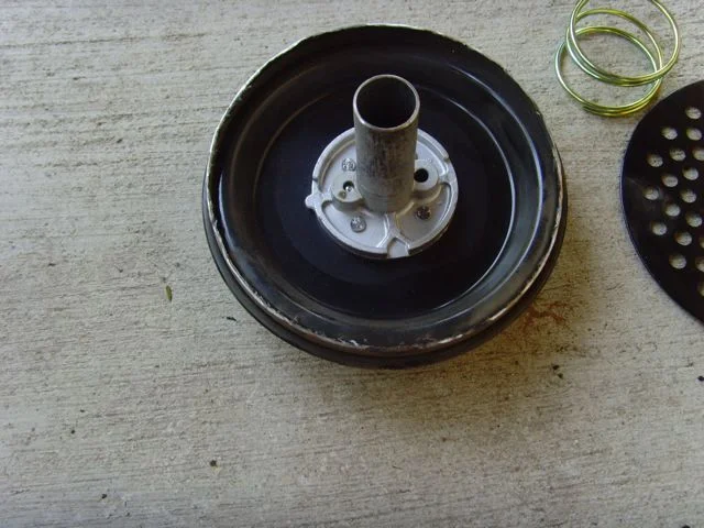

I just rebuilt mine a few years ago after really disliking the Delco, GM or whatever. Followed this guide. Pretty easy and it all still looks factory which is a plus in my mind.

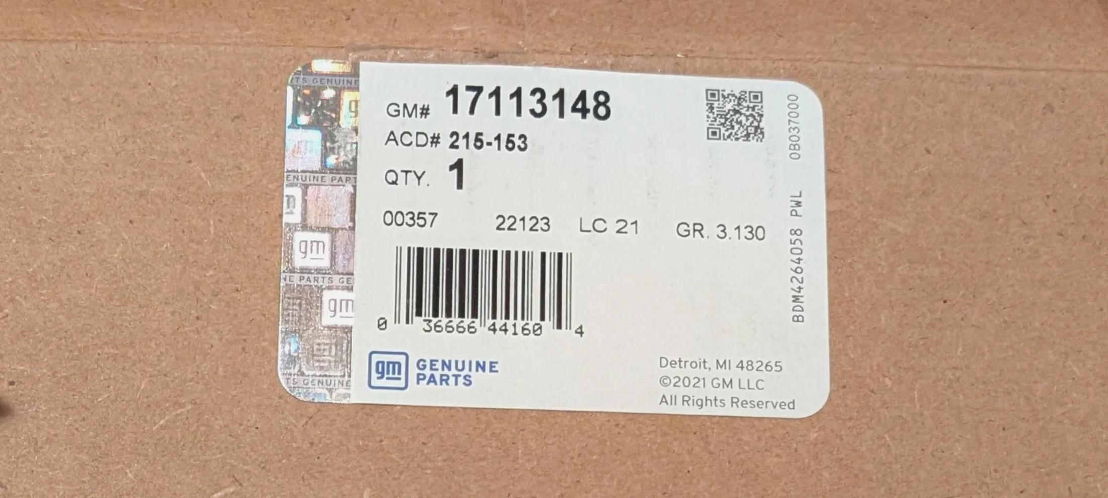

FYI for anyone else going this route: I ordered mine from Amazon and saved like $30 over Summit. I sent pictures to ACDelco, and they confirmed it was a legit part, and that they are running their own store on Amazon.

The only problem with using J B weld, is getting the canister apart again. Once you grind, or machine the roll seam lip off of the canister, the top is kind of a press fit into the body, so I'm not even sure you need to J B weld it in place for it to hold.

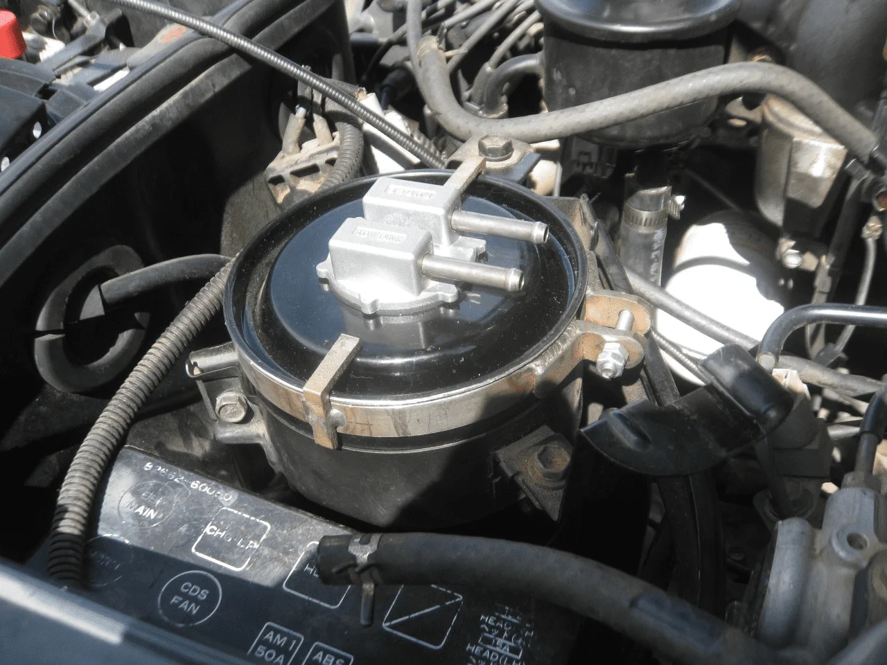

The nice thing about having the top removable. When the time comes to replace the charcoal inside the canister it'll be a whole lot easier to change if the top isn't glued in place. In my case when i did this job i just made a home made clamp to hold the cap in place, but I'm sure a big hose clamp would work too.
That is one hell of a clamp, nice welding work. Not trying to rain on your parade, but for us non-welder types, Red RTV does the trick and is re-openable....
I am a welder type and I still used RTV (grey) because I'm way too lazy for that. It's a hell of a nice looking clamp though! If everything is working properly, it really doesn't need much to hold it together and keep it sealed. If memory serves, there's about a half inch of slip fit, that's plenty for the RTV to keep it sealed.
Ok, for the record, the Grey has better chemical resistance (including gasoline) than the Red. However, you should not have liquid fuel to the top of your canister. Regarding temperature rating the Red actually has a higher rated temperature of 650degF vs 500degF for the Grey. But, IMO, either should be acceptable for the application as your canister should be nowhere near that hot. You've got bigger problems than sealant breakdown if you are over 500 for extended periods in the engine compartment. (This is all Permatex product information btw.)
If the Grey makes you feel more comfortable with the install, go for it. Red is what I had on hand and is adequate in my assessment.
