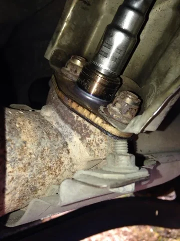

Here's another Denso vs Bosch story. So I got the the dreaded 420 code while trying to pass emmissions here in communist Atlanta. The error code actually reads, P0420 Catalyst Sys Efficiency Below Threshold. There are several troubleshooting steps on the MUD Forum before you get to my next step which was to replace the catalytic converters. I ordered OEM from Advance Auto for $719 plus shipping. FYI - I have a 96 LC with two in-line cats. I liked Advance Auto because they also had O2 sensors, sort of a one stop shop. Or so I thought. Without thinking or reading much on MUD I ordered Bosch sensors (part no 13422 upstream @$110 and part no 13136 for downstream @$90). After having my emmsions shop clear the error codes and then resetting the computer (drive 15 miles at 55-60 mph, immediately followed by stop-and-go traffic for about 15 mins), I had the system re-tested. The 420 error code was now gone, but the test failed. This time the error code was caused by an O2 sensor "heater". I didnt know what that meant but it was coming from the upstream Bosch sensor. So I go back to Advance Auto and order a replacement. I reinstall the replacement BOSCH sensor, have the error code reset, and drive the truck to reset the computer. I take it back for an emissions test and GET THE SAME [omit word] ERROR code coming from the Bosch [omit word] sensor. So I finally read the MUD forum, get smart and order DENSO sensors. Advance Auto tells me they are out of stock but I found them on Amazon via StockWiseAuto - Denso Part No. 234-4156 upstream $64 and Denso Part No. 234-4153 downstream @$62. Then the same drill - reset codes, drive to reset computer and retest. This time PASS! So the morals of this story are: 1) only buy Denso, 2) shop on Amazon and pay about 50% the cost of big box auto parts stores and 25% of the dealership's parts prices, and 3) you can install cats and senors in 2 to 3 hours in your driveway. Its a 2 banana job and all you need are metric wrenches and WD-40). Oh, one more moral: 4) BOSCH is crappolo.
Also, there ahve been several questions on MUD about which way to install the sensor gasket. See photo attached and how it comes fitted in the sensor from DENSO.
