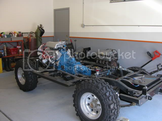

You could also look at a Ranger overdrive unit, they're available with Chevy pattern on the front and Toyota on the back so it becomes your adapter (to retain the stock transmission.)
BTW here is what an NV4500 and AA adapter to stock T-case looks like size-wise; my T-case is moved back around 2.5" if I recall.
