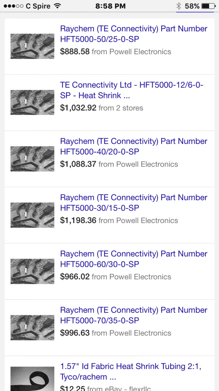

Ohh...
That's nice!
Nice and cheap too!
I did find a vendor in the UK that sells it by the foot. Still very expensive. No doubt it's the bee's knees though. Good find @BMThiker .
Yeah, the more I think about it though, a sleeve will not work. There are branches coming off these harnesses every 18" or so. If it was a continuous wire, these would be perfect, but given the fact that the harness is the way it is, only a split tube will work.
Yeah, this stuff is best on the smaller, two-wire runs. I just hate wrapping Super 33 from one end to the other, especially when you are trying to troubleshoot an issue. PITA

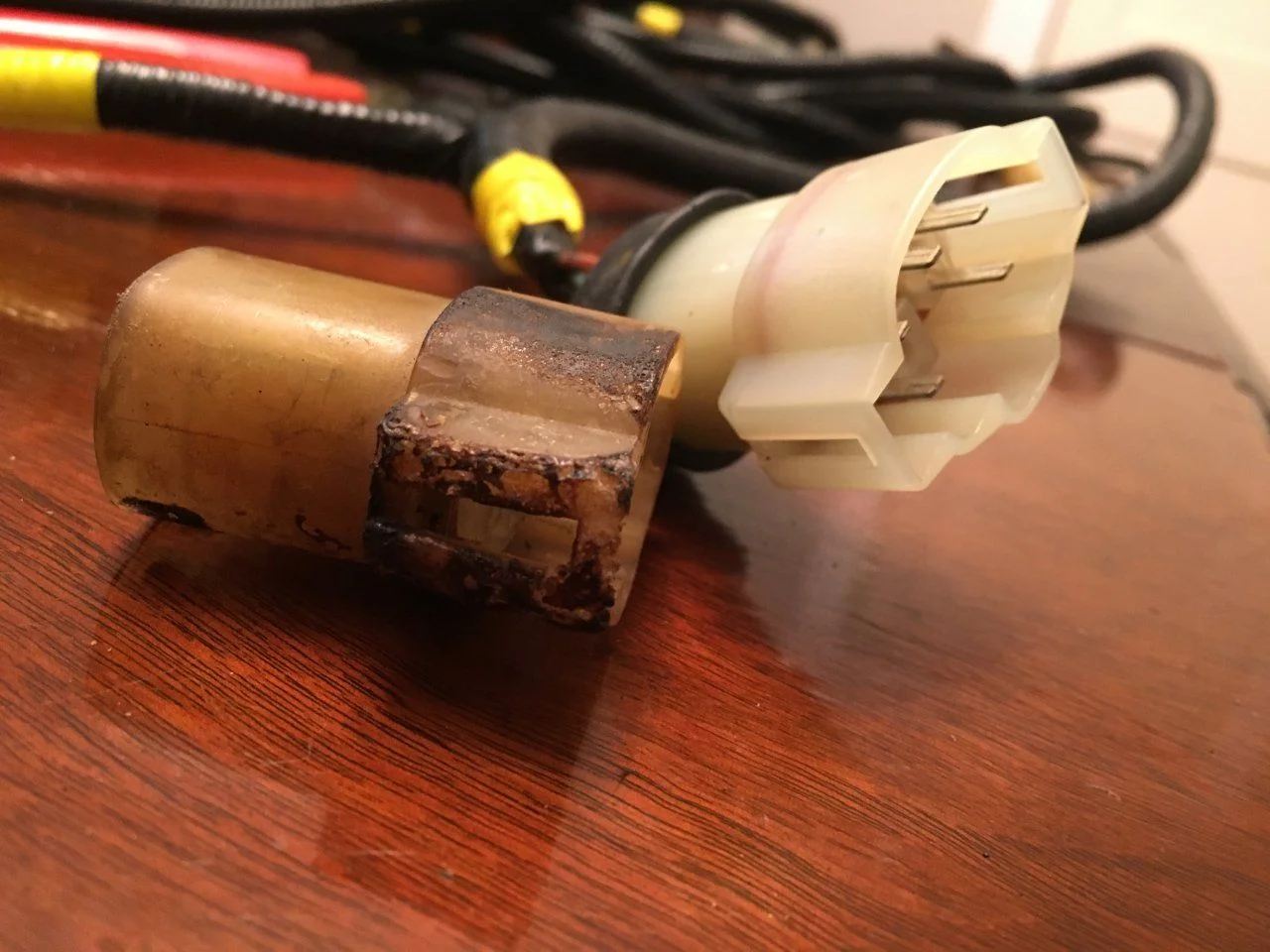

Replaced the burnt/melted main female connector on the rear harness.

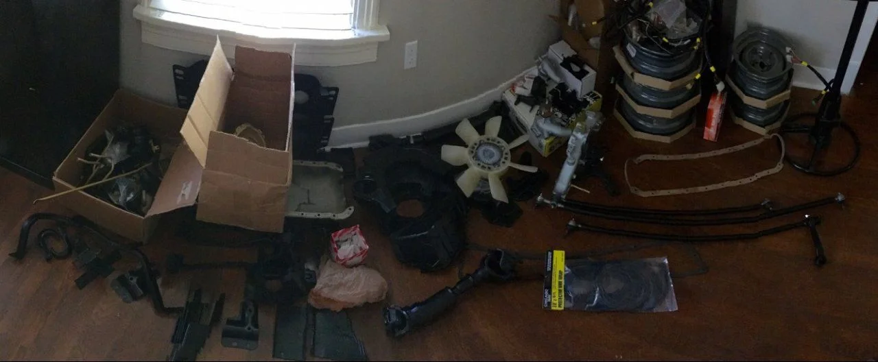

The finished parts pile in a guest room is growing.
