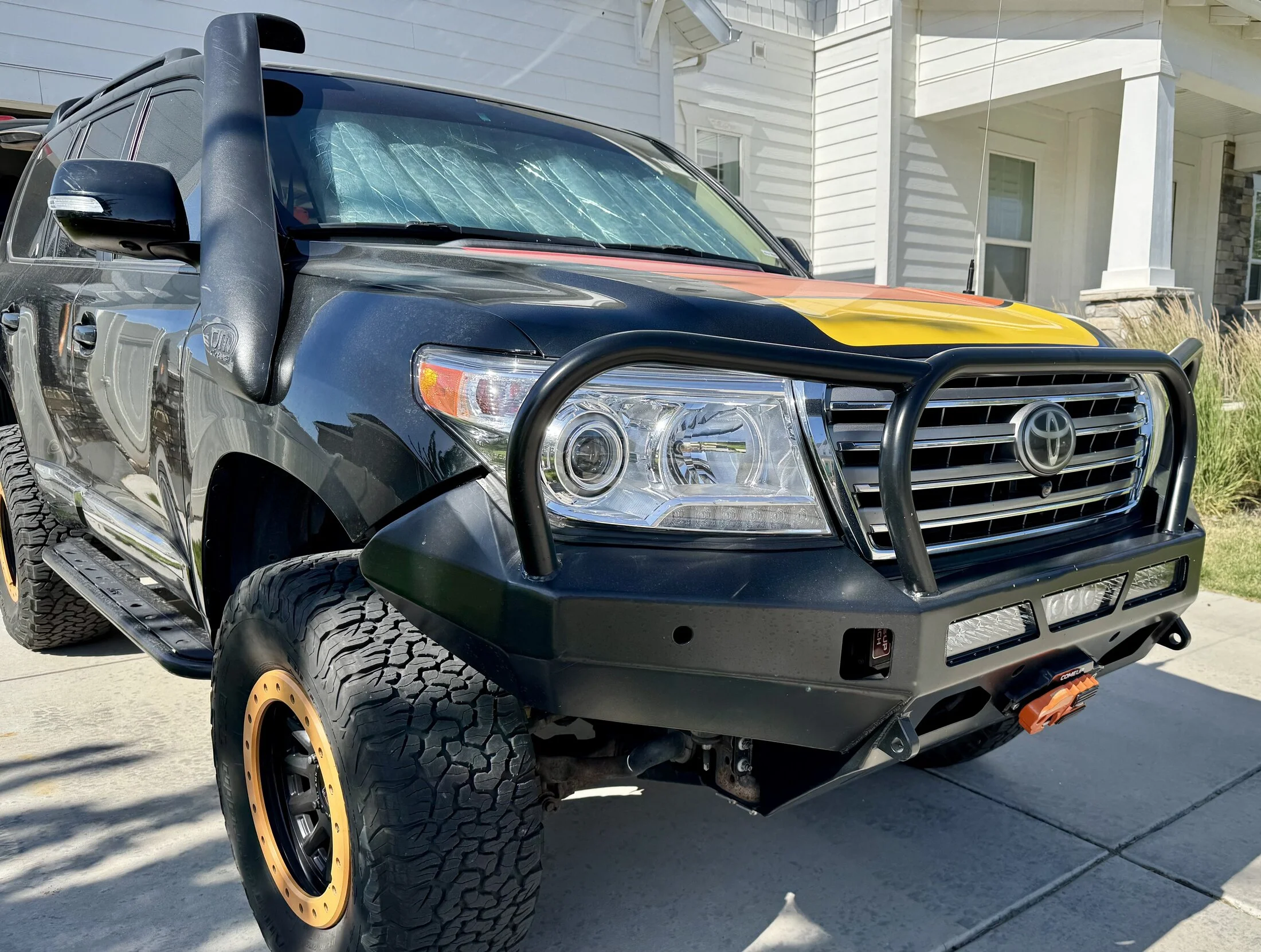

I haven’t been able to find anybody that builds bumpers for the LX 570’s to accommodate for the 1.5” body lift. I’d love to know more about yours and see more pics.
Chris

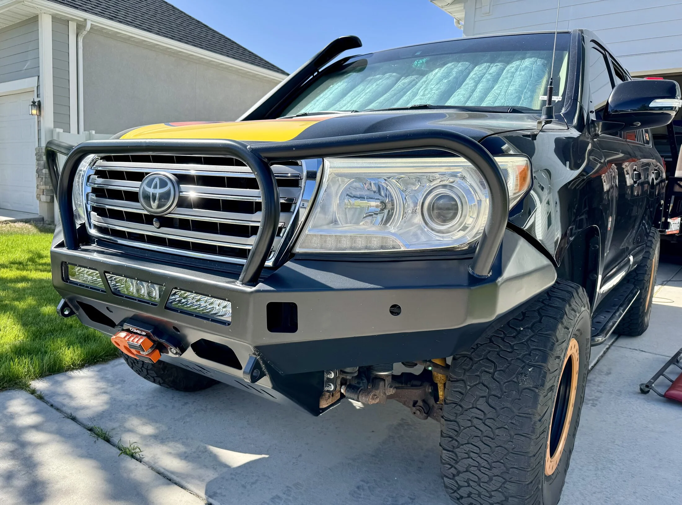

Derek is a fairly new and small operation and just does fabrication on the side currently. He has a small auto dealership specializing in Toyotas. He is a cruiser guy and I just suggested he get involved in the Mud community if he's not already. He's primarily on Instagram. Here's a short video he took of the bumper when he finished making and installing it. I continue to be very happy with it. I had a TJM bumper previously that I really liked, but this one has a little better clearance and of course was built with the body lift in mind.
I hope he built a jig for that… seems like a really nice bumper that a few people on here adding body lifts would probably scoop up quickly

I would just like the pieces of his bumper, I can weld and all the other things. The time consumption of the actual fab is what gets me.
I love my TJM bumper but this one is an eye catcher

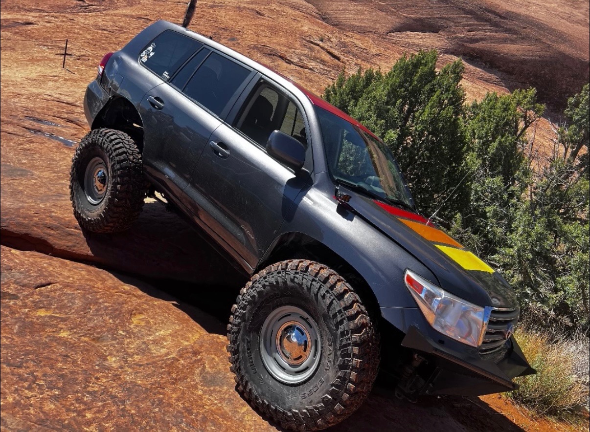

This is Chad from Colorado and he happened upon my YouTube videos running big tires and asked a few questions and dove into fabricating his own body lift and getting onto 37’s for his ‘08 LC.
@J2HundyOutfitters is what he goes by on here. He makes a few parts now and has a thread on an alternative gasket for the valley plate. He is pushing the limits of the 200 platform now with 42’s! 👏🏼
