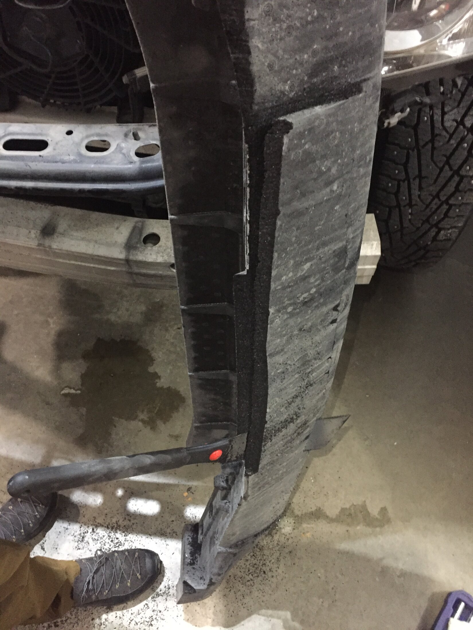

Anyone who has trimmed down the front foam that resides behind the bumper. How much did you have to cut down. I cut the bottom inch off of it for a 1" BL but my bumper still didn't get very close to fitting. I assume I've got to cut the front nose off it as well. Getting close to wrapping up my install.

Yes, you'll have to reprofile the nose part of the foam. In general, probably cutting off more than you think you need to.
This was a first pass but I think I cut off more than this when finished.

Here are my two photos I saved from my own install. Hope this helps as well.
