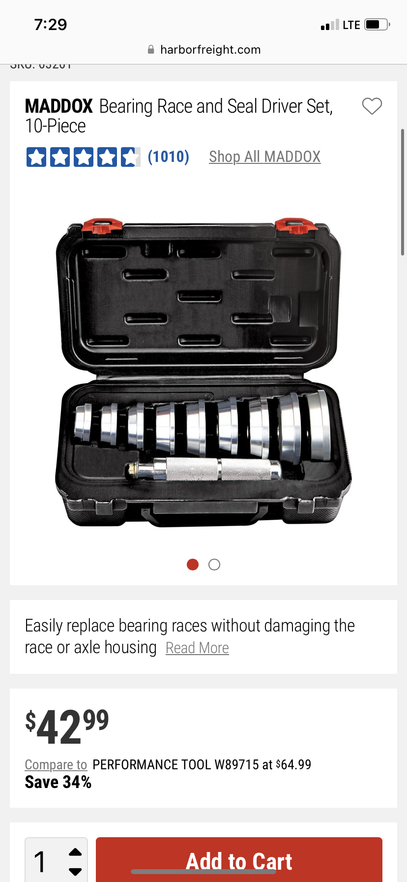

Would anyone happen to know whether this harbor freight race driver kit would work for our rear diff?
Yes, that's what I used.
There's still a couple spots where you'll need to get creative to drive the bearing past the snout. Check the install thread in my signature.
You might keep the old bearings around too as they make great "tools" to drive other bearings.
Yes. When I set up taller gears for my diesel 4Runner I changed bearings at the same time. One of the old pinion races got sanded down a bit around the outside diameter then became the adapter to press the new race in. If I didn’t sand it down it wouldn’t come back out of the recess for the new bearing, since it is just a bit deeper than the new race.
I also have the older version of that HF driver set.. it’s great for axle seals and some other parts. But most of my tooling for pressing races and such are older bearings I’ve collected in an ammo can.
If nothing else you can get a length of 3/8” X 1.5 or so flat bar. Not too difficult to cut and grind to a length/shape that will let you bridge and push evenly on two sides of a bearing race. I’ve done this a handful of times over the years.

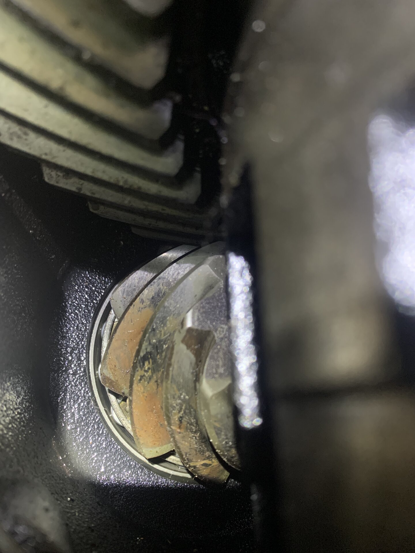

  • The side bearing for the carrier on at least one side presses beyond flush…meaning just a set of bearing press plates won’t press the side bearing deep enough. One solution for this is to use part of the old side bearing (the race of it I think), sand the inside and perhaps outside of it so it’s no longer a “press” fit on the side of the carrier and can clear the bearings/cage easily…and then use the newly sanded carrier side bearing race as a spacer/press tool to push the new carrier side bearings onto the new arb/locker/carrier.
  • How to remove the old carrier side bearings for making your new press tool though? The guy in the video seems to use a specialized tool…which will likely preserve the integrity of the carrier side bearing totally in the event you want to reuse it:
  • I don’t know what that tool is called and I don’t plan to reuse the old carrier side bearings…so what was recommended was to cut off the carrier side bearing “cage” and remove the bearings…and then use a 2 jaw puller (I used an oreilly tool rental 2/3 jaw puller 67020…it converts from a 3 jaw to a 2 jaw by removing one of the jaws and swapping another so that the two remaining jaws are parallel from one another)…you need a 2 jaw puller because there are two reliefs cut into the carrier for 2 jaw puller…not 3. Additionally, you’ll need something for the puller to “push” against in the center since there’s a hollow in the side of the carrier for axle shafts... I used an aluminum bearing driver with a bolt in the center of it…
  • I sort of “pulled”/tore the cage off partially, then pulled the rest of the cage off With a set of channel locks (could have used a dremel)…the bearings then fell out and I was able to pull the race off relatively easily with an electric impact and a bolt placed in the center of a bearing press plate (seen below)

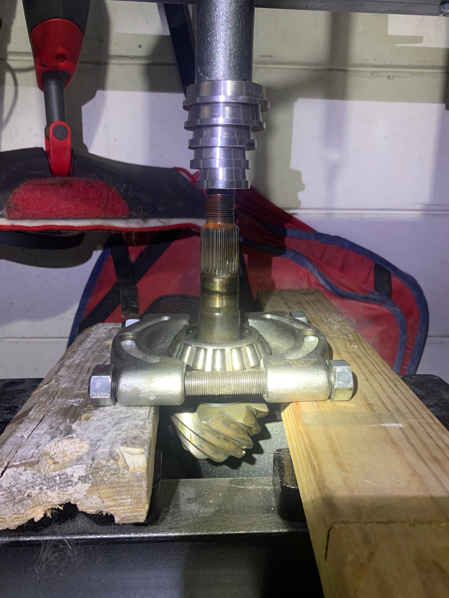

-I think the next step is to remove old pinion bearing from the pinion and place a new one on.
Autozone rents/loans bearing splitters (or sells them for $50) that can supposedly be used to remove pinion bearings
Good stuff, seems like you are moving along nicely.
The bearing splitters autozone/oreilly rent are petty good as long as you get them big enough.. they make a pretty wide range of sizes. I have a medium sized splitter made by OTC, on which most of the knock-offs are based, and it has been a great tool.
And now that I think about it too big of a splitter doesn't work either, as the knife edge won't contact much of the bearing. It's a balance.
Mostly based on this
  • remove old pinion bearing from the pinion…an “up to 4.25”/108mm bearing separator ($50 or it can be rented/loaned from Autozone) seem to have worked, along with a press and some aluminum bearing race press plates

  • Catch the pinion when it comes out so it’s not damaged. It’ll have a small spacer on it underneath the bearing. This video is of a 9.5” rear differential rebuild may be of assistance…13 minutes into the following video is when he removes the inner pinion bearing from the pinion

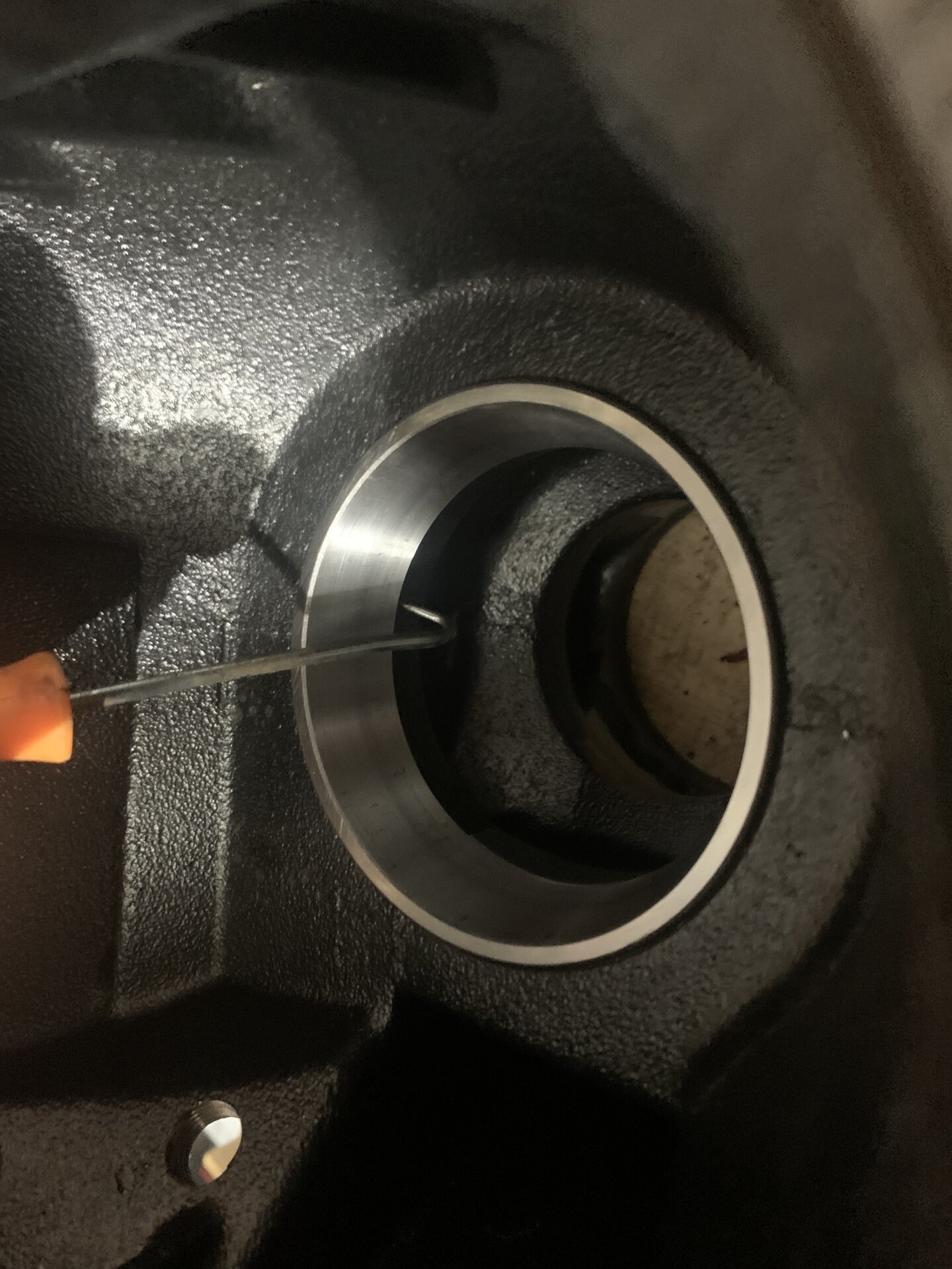

When you go to install the new large pinion race into the housing you’ll probably need to reduce the diameter of the old race to get past the shoulder while not getting the old race stuck in the recess. Kindof like what you did for the ID of the carrier race to get over the stub without sticking.

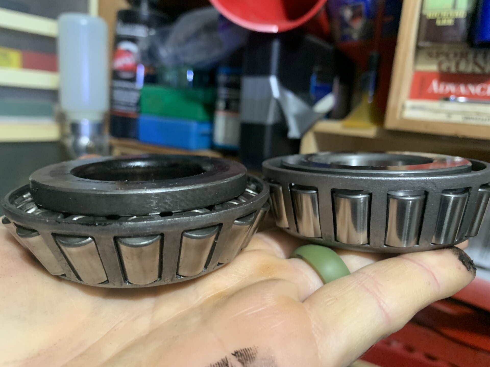

  • I ran into a bit of an issue and am still trying to sort it out.
  • I tapped the race that was sent in…while it did press in, it is proud of the place it presses…according to the 200 series forum, zuks photos, AND my extra diff, that race is supposed to be inset, not proud…also the old bearing has a chunk of metal above it and the new one doesn’t…also the parts have different numbers.
Old large pinion bearing: nsk stf r40-64g
Old large pinion races: nsk stf r40-64g
New pinion bearing: nsk 30308jr
Photos are of old pinion and new pinion bearing…old inset pinion bearing race…new pinion bearing race proud.
There is a thread where someone has similar part numbers and similar issues…though I don’t know whether it was ever resolved or whether these are alternate part numbers that, while dissimilar in appearance, may work just as well.
Thread:Diff rebuild question - https://forum.ih8mud.com/threads/diff-rebuild-question.1277533/
Does anyone have any insight? Will the new style of pinion race bearing be fine?

What bothers me most about the bearing changes is the angle of the rollers.. I'd have to assume toyota designed theirs the way they did for a reason.. for that angle to change so much seems pretty significant. Had you considered ordering these specific parts in Genuine Toyota flavor to see if they changed too?
For the gear setups I've done I just remove/reinstall the large bearing with the splitter. Assuming identical bearings (you can't do this with the pictures you've posted unfortunately) the original shim will usually get us very very close to final spec, if not perfect. Setting up new gears as Zuk or the big shops do, there's more incentive to have setup bearings or a more efficient tool ready than setting the splitter up over and over.
Good idea, the stark difference between oem and what was in the kit kind of bothered me too.
At $60 for an oem bearing and race (supposedly part # 90366-40088) I get exactly what Toyota designed…and can use my old one as a setup bearing to reduce the chances of an issue.

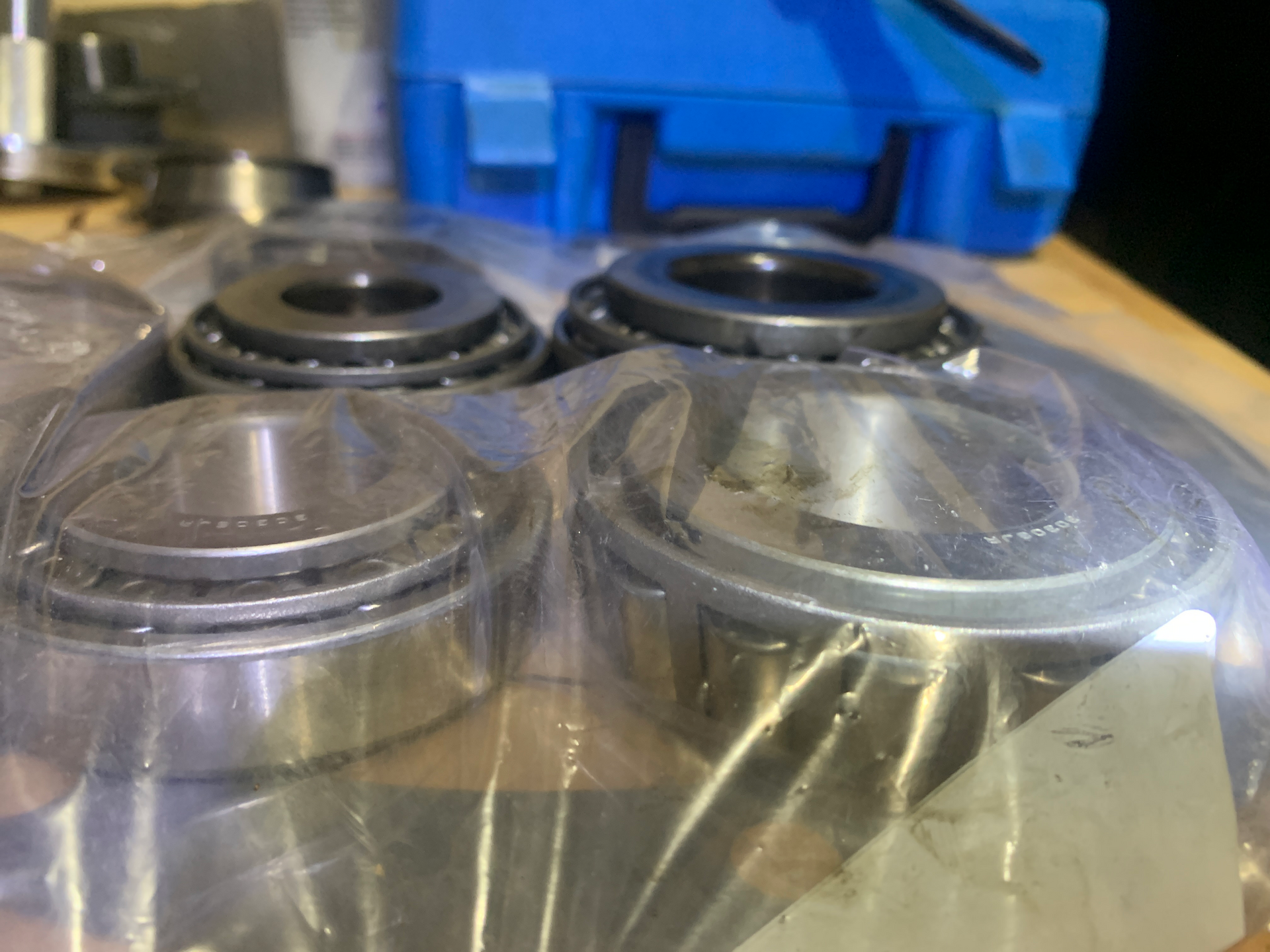

Are the small pinion bearings the same between your kit and the old part?
It doesn’t appear so.
  • small pinion bearing in this kit is koyo hi-kap 30306j-n, stock/oem was nsk stf 30306djAag Japan L…which are visually dissimilar in thickness…essentially both of the oem/stock pinion bearings have thick rings of metal on top of them (kit pinion bearings in the bag/foreground, oem in the background)
  • Similarly the pinion spacers included are not “in front of the large pinion bearing” like oem, they are “under the large pinion bearing race” style spacers (pic follows)
In light of learning more about the items in this kit, I ordered an oem large pinion bearing for around $60 shipped…that way I can sand and use my old oem bearing as a sizing tool (rather than pounding in and out the large pinion bearing race in order to try different spacers)…I’ll, thus, potentially order some oem spacers in lieu of using the kit’s “behind the race” spacers (if needed).
In order to reduce the complexity of the project, I’ll may end up ordering the oem/stock small pinion bearing/race too…since kit bearings are so different in size than the oem ones…I haven’t gotten that far though so I don’t know whether that will be necessary/advisable.

For the record the roller angle difference might not be on my radar if I hadn’t seen Zuk write about it a long time ago. Seems it was an issue with Koyo install kits as well.
Since the roller angle is so different on the large bearing I’d absolutely get a factory small bearing too.. in theory they should both be able to handle the forces involved but if somehow NSK designed those bearings to work together and you change one of them, I can see a hypothetical situation where the other isn’t happy.
Also good plan to run the spacers on the pinion itself, as Toyota did.
