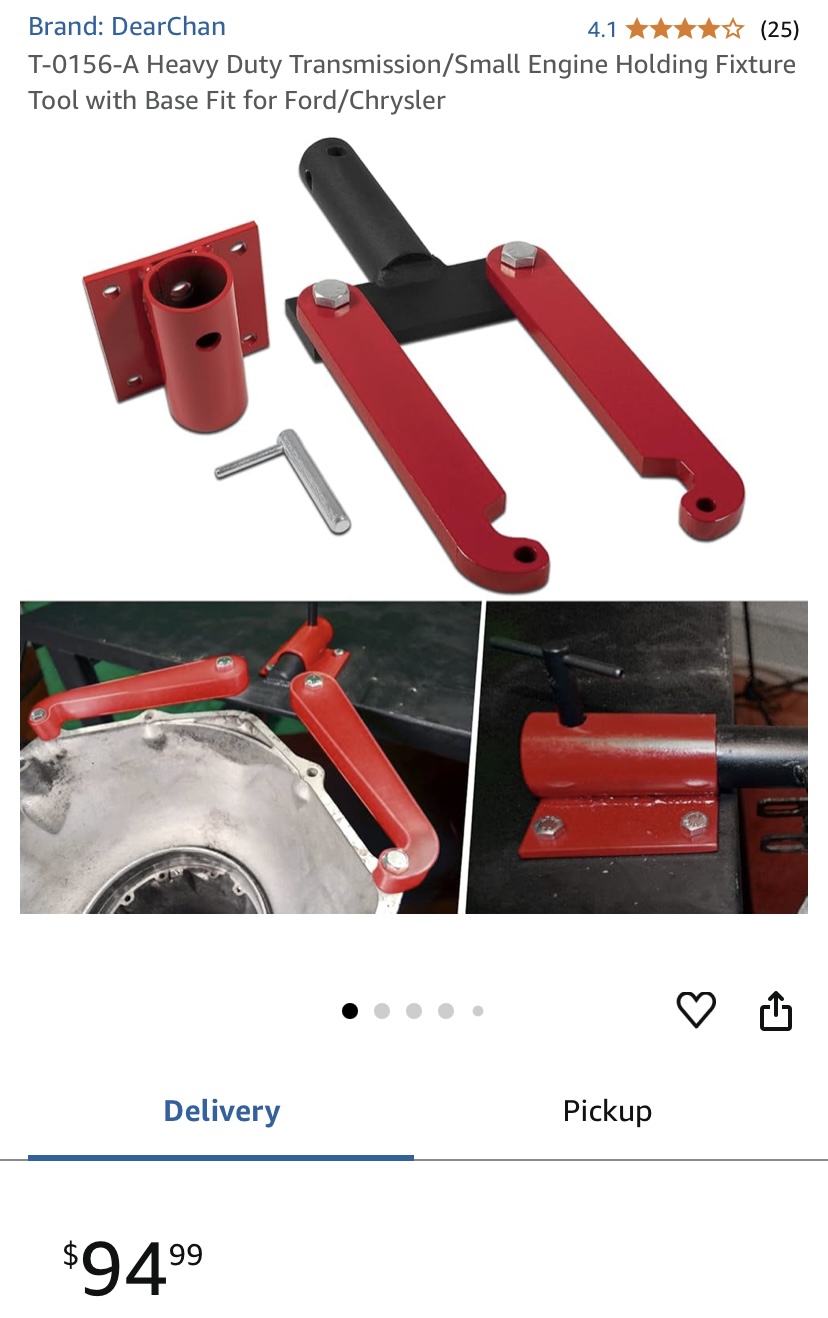

  • Then you snug the pinion nut down with an impact. Not critical measurement, just some drag on the bearing to start setting pinion depth…it appears Otramm tightened the pinion nut until the pinion flange dust cap was flush w the differential case….i had trouble w the diff carrier spinning on the bench w this so I went about trying to make a “holder” for it. I ended up using the following tools…not a close fit, but it appears feasible for what I want it to do…not advice, but I was able to put a bolt through the top of the engine holder and transmission holder to secure it a bit more in there…and was able to pinion a big wrench to lift the diff into a more flat (rather than leaning) orientation.
