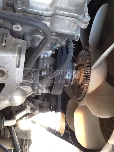

Which fan clutch is this?
Since I couldn't find a thread that identified the various models, could one of you more experienced fan clutch experts identify the one that is on this '97 LX450?
It looks to be an Eaton unit, but not 100%. I am fairly certain the Eaton was factory installed on most 97's.
I am sure Tools might be be able to ID it from that angle. If you pull it, it might make the identification easier.

Anyhoo, here's the clutch I pulled out of my 97....

Looks like your blue fan clutch is the newer version with part number 16210-66020.
