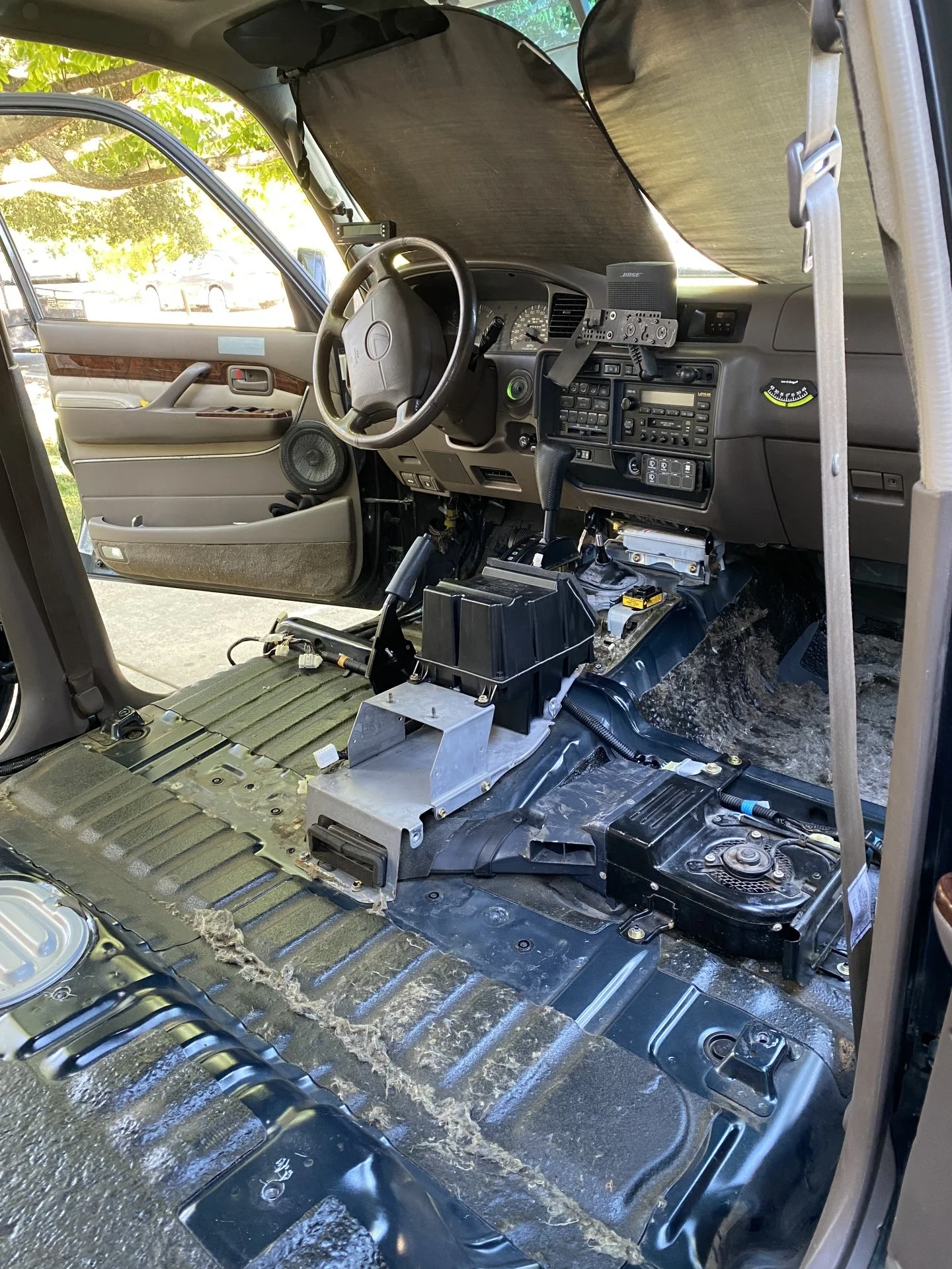

Did you remove the front seat?
Yes…and a bit more ;)

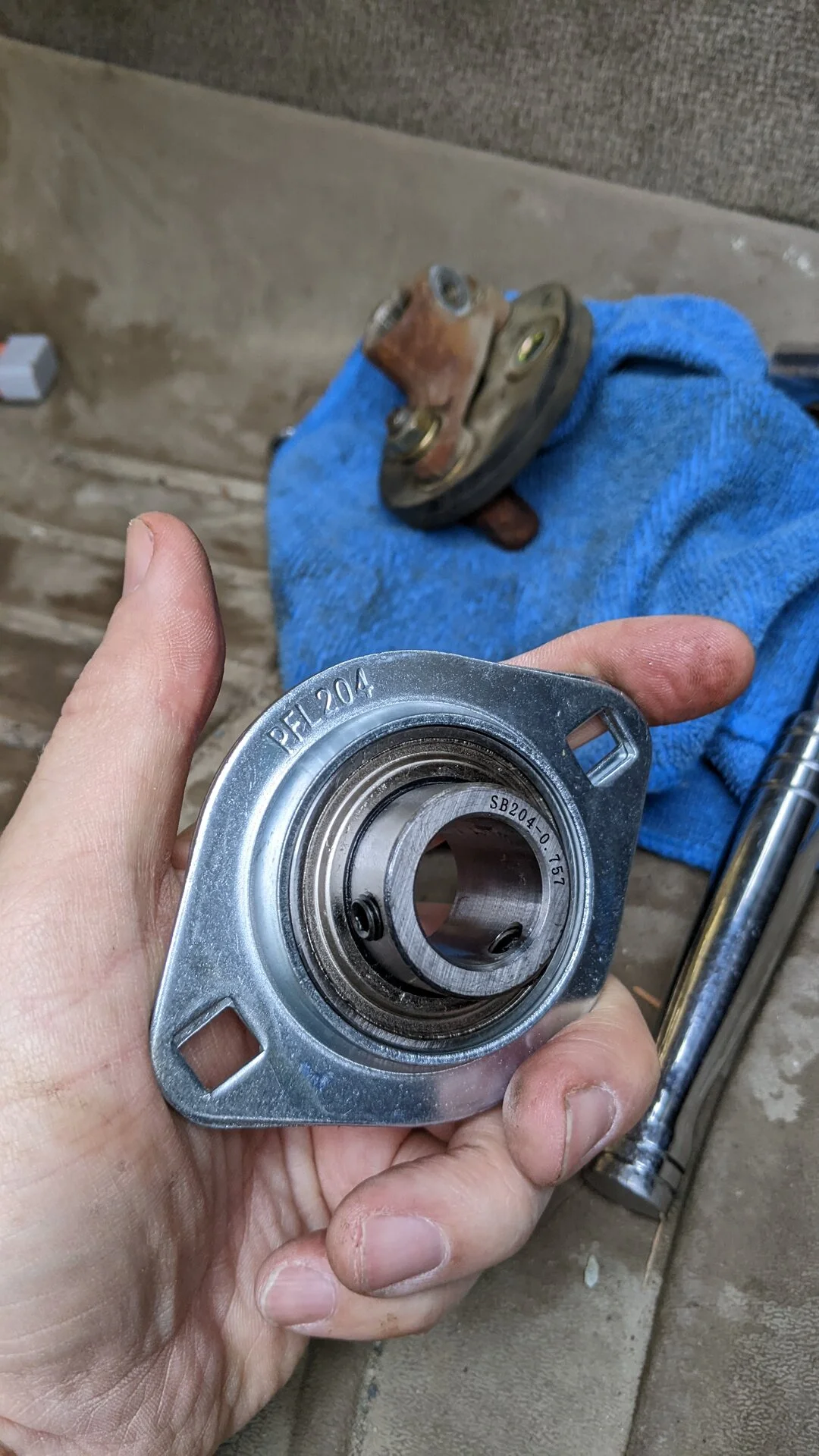

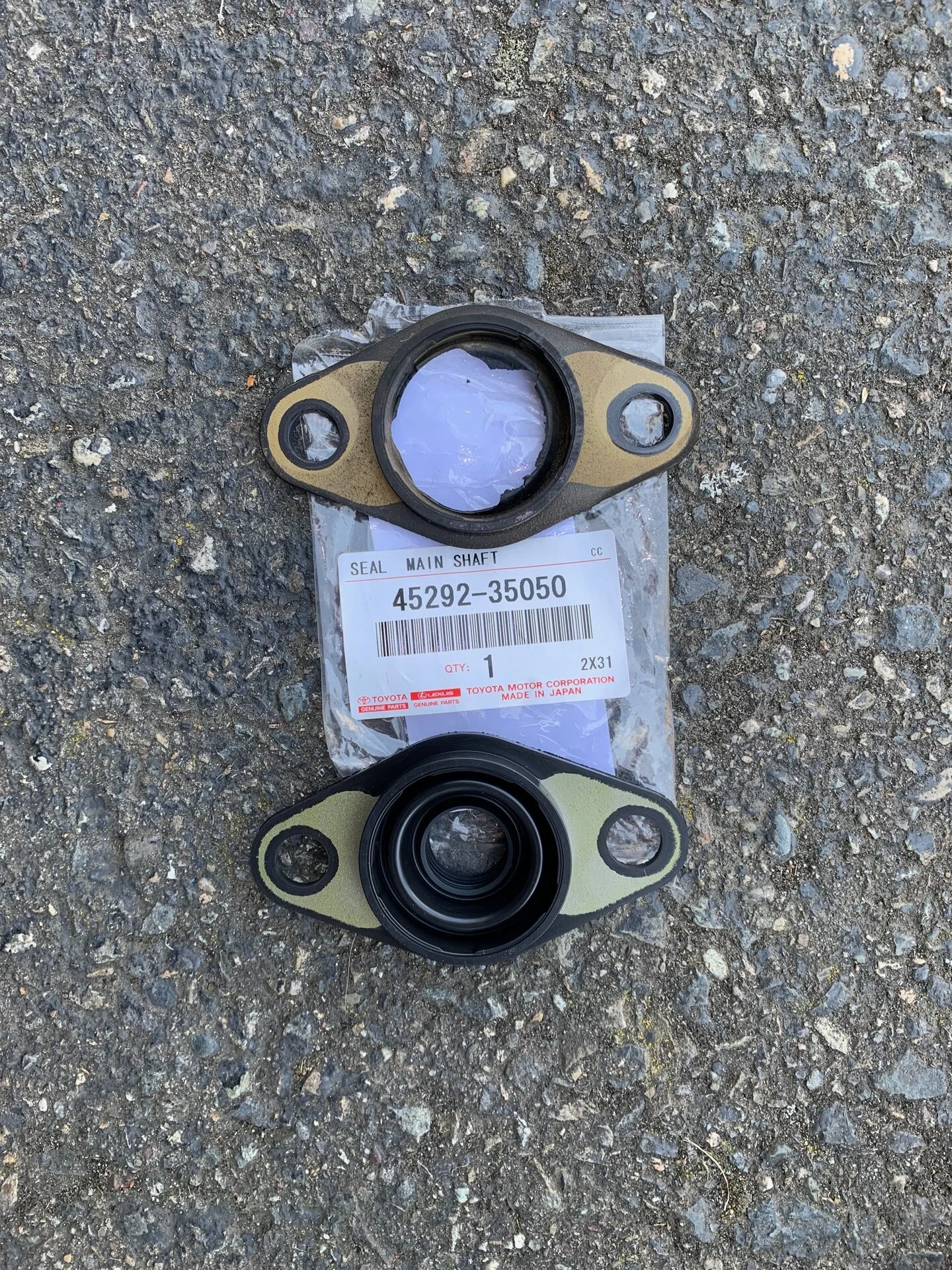

I can confirm the steady bearing doesn't work on my 97 lx450. Like previously mentioned the shaft gets larger by a couple mm about half way to the firewall. So I just replaced the OEM boot instead.
That being said, I have a brand new bearing I can't use, if anyone wanted one I could sell it to them cheaper than new 🍻

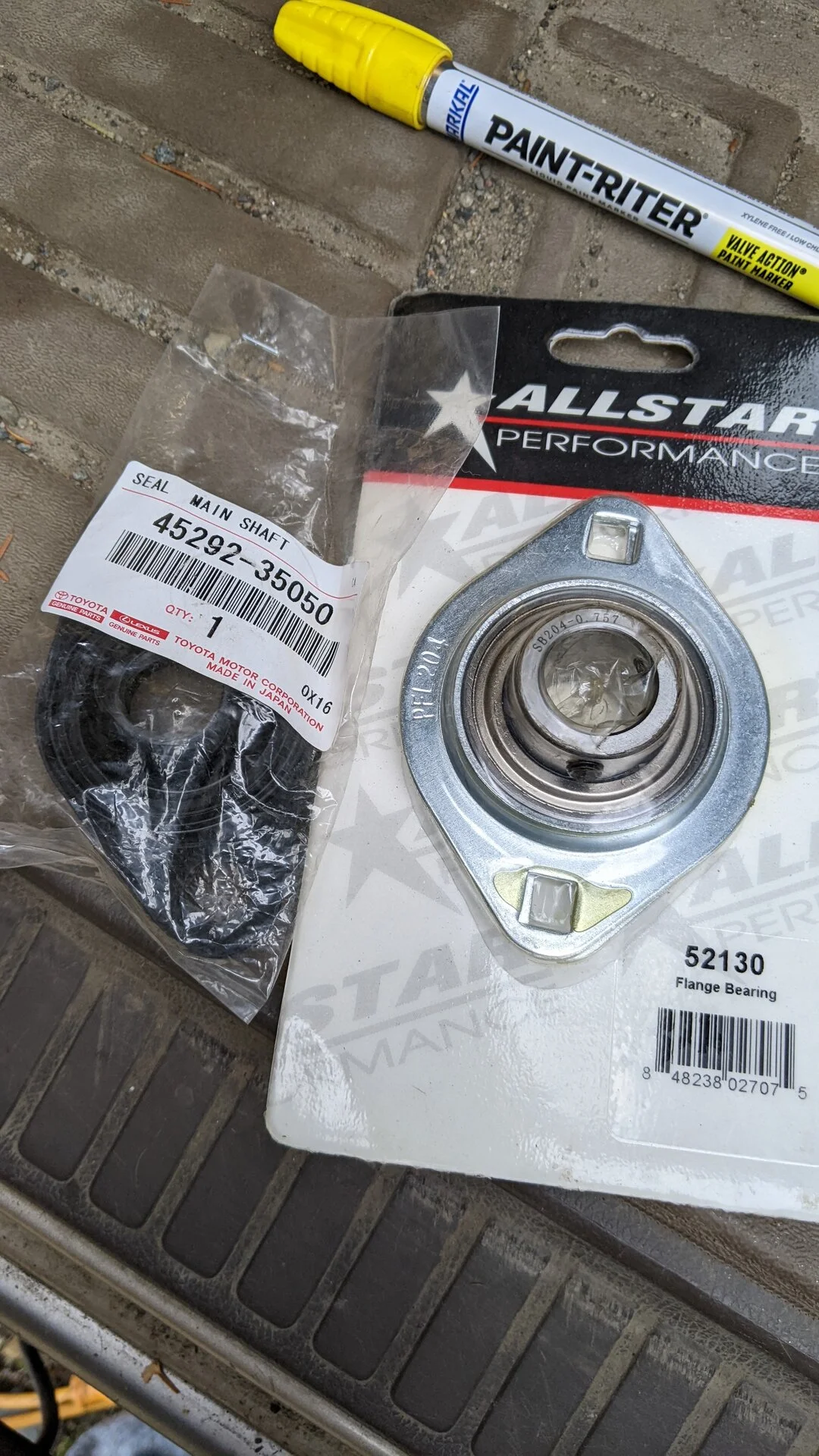

My steering shaft was off center so I knew a new factory seal wasn't going to last long. Ordered this bearing Amazon.com: Bryke Racing Steering Shaft Firewall Mount 3/4" Bearing Support IMCA : Automotive - https://www.amazon.com/Steering-Firewall-Bearing-Bryke-Racing/dp/B00D951Z1G, used a grinder to make the support fit, cut a spacer out of quarter inch thick plastic ( a tube of caulk is the same diameter as the bearing support flange) and installed with bolts that were about a quarter of an inch longer than the original bolts. The bearing fit over the shaft without any problems. I didn't tighten the set screw on the bearing. It's been installed a year now without any noise or problems. It may be my imagination, but the bearing seems to have taken a tiny bit of slop out of my steering.
Let us know how that works out, in another thread (hot drivers feet) someone used the same/similar steering shaft support bearing and IIRC removed it after awhile.
