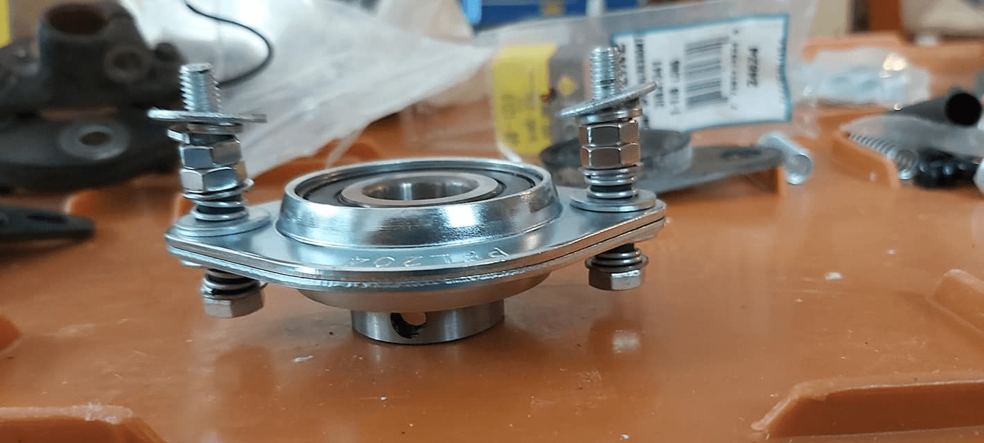

Now lots of people had tried the bearing technique and complained about it squeaking and it drove them nuts. So I thought about it and came up with a system that so far has worked flawless. After going through these 4 items I have no dead spot and it's nice and responsive without a squeak.
1- get a new rubber seal from Toyota along with the rag joint. I got my rag joint off rock auto because I'm a cheap.
2-order a steering shaft support bearing off ebay 20mm or 3/4"
3-get a pack of these springs, 2 m6x60 bolts, 4 m6 nuts, 6 m6 washers, 6 m8 washers, a peice of thick shink tube that fits over the bolt.
4- lay it all out on the bench
5- crack beer
6- climb under your dash abd remove the old rag joint and slide the old seal off the shaft.
7- cut two springs in half. And this part is a bit specific to your bolt. I used a 50mm bolt but I wish I had 60mm it would give more clearance to the fire wall.
8- Slide m6 washer onto each bolt.
9- Cut shrink tube to just longer than the part of the bolt without thread. Heat it up and shrink to to the bolt.
9- Slide one half of the spring on followed my a m8 washer. Do this for both bolts.
10- Now slide the bearing assembly onto the bolts then another m8 washer spring then m6 washer. Put one nut on the bolt and tighten it until it bottoms out the thread. You not have floating bearing assembly. That has the ability to move with the shaft and wont squeak.
11- Install a second nut, you may want to get a couple extra nuts and use them to take up any extra thread so nothing can come loose. Leave enough thread that there is 15mm or so past the new seal or so to be able to re bolt to the fire wall. Don't forget the washer infront of the seal!
12- Climb under the dash and slide the assembly downtown the fire wall and tighten the bolts up. Then tighten the set screws onto other shaft.
13- Have another beer, you have been doing yoga for 15 minutes under the dash you deserve it.
14- Now the hardest part I found was getting the new rag joint back in. Sliding it over the shaft is simple but getting the steering column side to line up again was hard. I ended up getting a hand and unbolted the column, pulling it back ever so slightly to get the bolts in.
14- Once installed make sure you tighten everything up! It's your steering double check!
15- Take it for a drive and feel the difference.
Mine has been this way for 3 offroad trips now and no squeaking of any sort. Steering still feels nice and tight. So I figured it was time to share.
Hope this helps some one out! See you guys on the trail!
