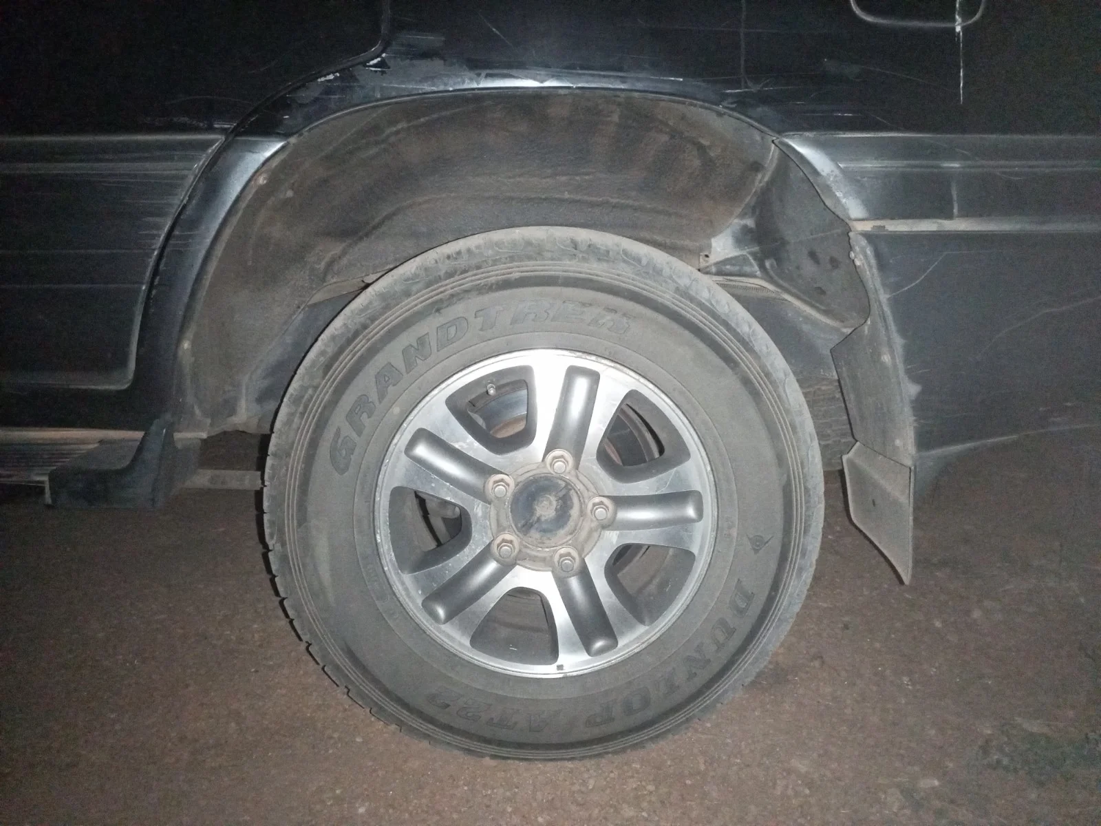

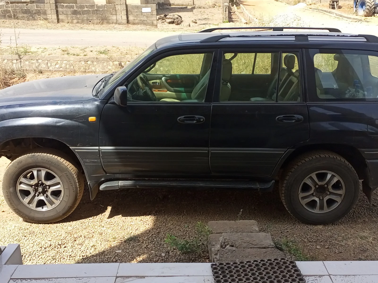

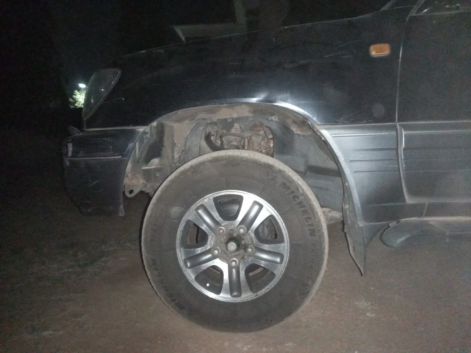

It finally happened guys, I'm almost certain that the two front AHC Globes have s*** themselves and imploded and fluid is flowing unrestricted into the 2 front shock absorbers. Every bump in the road turns the entire front end of the car into a vibrator and getting out of the driver's seat after a long enough ride is dreadful because you have to brace your now-jellied legs. Anyway i'm just looking for some confirmation that the Globes are in fact the problem, I mean I know, but it never hurts to be sure amirite? The back two globes and rear suspension system are still working perfectly, everytime we go over a speed bump in the road, unless you literally crawl over it, riding in the front (driver and passenger seats) feels like riding wild bulls at a rodeo while riding at the mid-row seats and rear-most seats retains (most) of its original comfort. Also, when the car is parked (and I assume every other time) the front is visibly higher than the rear. Front looks like it is in super-high mode while rear is at Normal setting. I'll just attach a few pictures here and there.

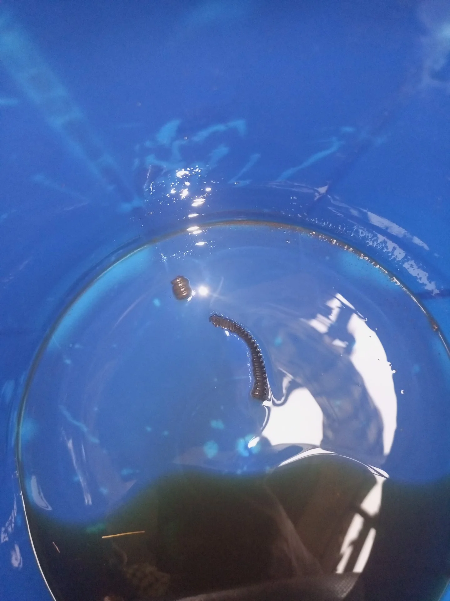

Ok, so, I went and checked the passenger side accumulator today, knowing that at least I would be able to temporarily stop the bounciness by releasing the pressure and pouring the old fluid back in. However, this fluid was exceptionally dirty and even had pieces of rubber or plastic come out from the mouth of the accumulator assembly after unscrewing the accumulator. Any ideas what this could be? Or maybe it could be some weak wiring loom that feel into the bucket when the bleeder hose touched a wire? (There's also just hella grime and dirt pieces everywhere in the fluid :/ )

Then, your front heights look WAY off. It's far too high, and will most definitely ride like garbage.
Looks like either: your height sensors have failed, or they are set super wrong.
That loom just fell off into the bucket. No way that was in the hydraulic system.
