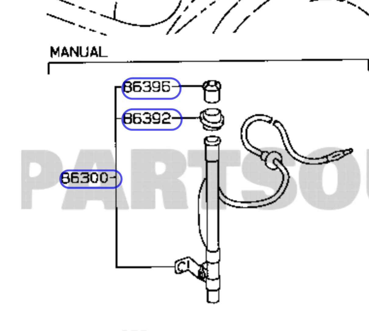

Who can tell me if this is the Toyota standard factory AM/FM antenna base for an 80 series without a power antenna?
This is on a spare LHS front fender aka outer guard I've recently obtained, and it's the same one my 80's existing LHS front fender panel has (but is damaged).
Having trouble finding anything in Toyodiy that appears to match. Perhaps it's an aftermarket Aussie-made thing from the 1990's.

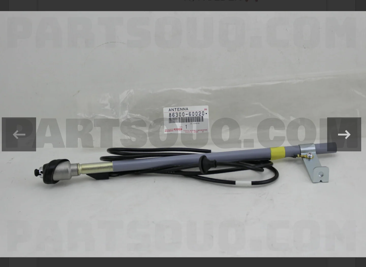

I saw that in Toyodiy but nothing that matches the two identical antenna bases as per the one I pictured the top and bottom of. The antenna from Toyota isn't a 'fixed' antenna as such because it's collapsible into itself exactly like a power antenna but just doesn't have a motor to 'drive' it up or down.

The one you pictured is universal aftermarket, so unlikely you'll find it in toyodiy
The one I linked is "fixed".
If you choose to leave it in the raised position, it's fixed in that position until you change it.
If you want to lower it for a car wash, or off road driving, you have to physically push it in.

You can use one off of a Tundra or a Tacoma. Those are fixed flexy style non-moveable antennas that keep things OEM.
I installed a Tacoma antenna but had to make a base to hold the bottom in place. Apparently I didn't get the angle right and now my antenna leans towards the driver's side. When I installed it, there wasn't a lot of room due to the inner fender.
