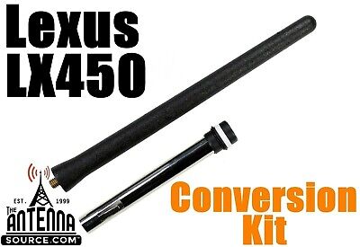

I really hope this is the part to make this happen. @OGBeno ?

You can use one off of a Tundra or a Tacoma. Those are fixed flexy style non-moveable antennas that keep things OEM.
Are they direct swap? I’m thinking about trying out the Ronin Factory stubby antenna since mine just snapped and I don’t want another long antenna. I don’t even have a radio in at the moment.
