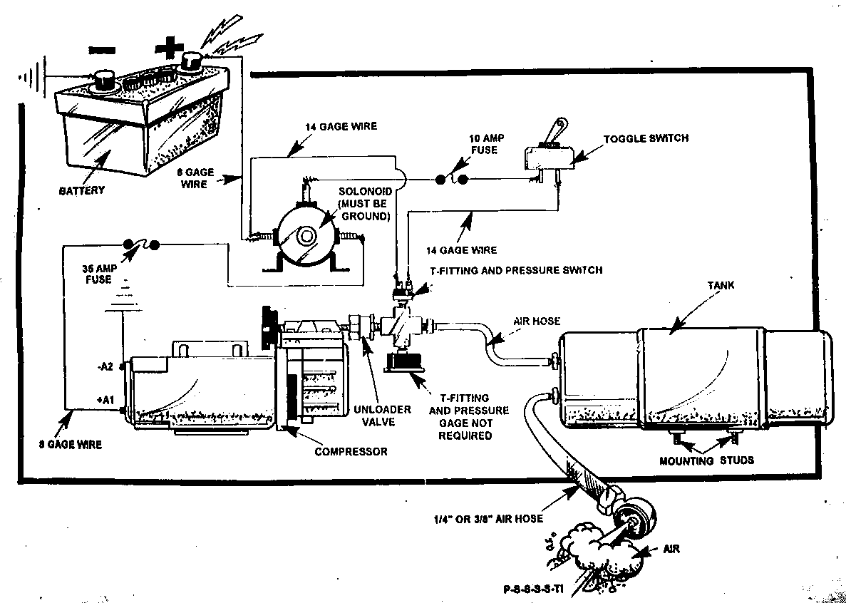

I found this when I was searching to just understand the basic requirements for an onboard air set up. Thought it might be helpful. I used this search. You may find something more useful or specific to your application.

I also have a 4 tire setup that would work much better with OBA. All good, just not sure about the unloader valve I needed. Thanks all.
