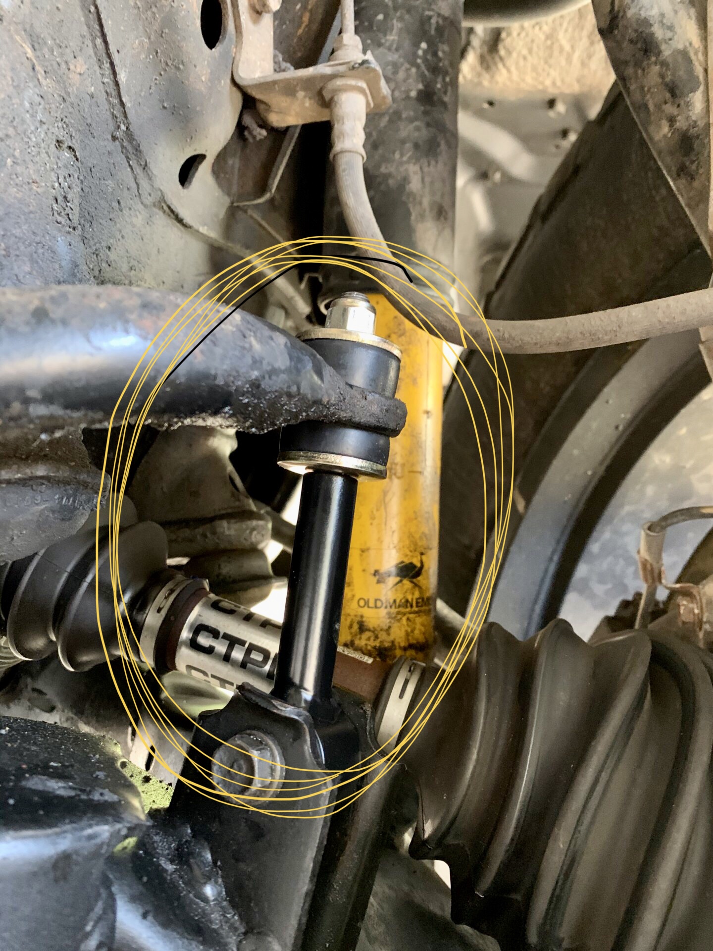

Mines was a worn out bushing at the end link check your end link. While I was there I saw my wheel bearing needing replacement too smh
When changing the broken shafts, all bearings have been replaced.
Which end link do you mean? And was it clicking?
Yeah it was clicking the front ones they were able to move around. My left side didnt do it but the right side did
