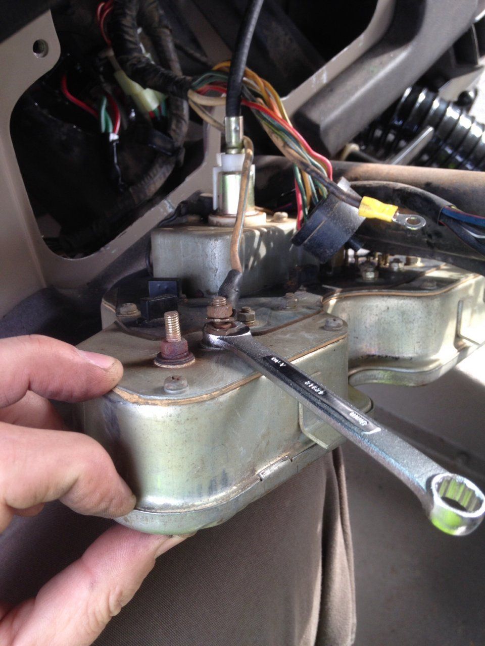

Since NOTHING worked, it wasnt likely ground. Too many grounds for that to be the common problem. Only other logical item was power. But I had 12V. Question was - how much current? By now, I had pulled the gauge cluster and BAMM ! There was my answer ! A loose conection on the Amp meter. The connector had overheated (rusty connection?) and was creating an intermittment open.
I replaced the connection, cleaned off all the rust, tightened everything back up, and WAA-LAA ! And Vroom, too !. I wasn't thinking aboutt it initially, but ALL power goes thru the Amp meter, before it gets to the fuse panel. I had 12V, but not enough currrent - it's the current that makes it work, ya know! - to make anything work.

Since NOTHING worked, it wasnt likely ground. Too many grounds for that to be the common problem. Only other logical irem was power. But I had 12V. Question was - how much current? By now, I had pulled the gauge cluster and BAMM ! There was my answer ! A loose conection on the Amp meter. The connector had overheated (rusty connection?) and was creating an intermittment open.
I replaced the connection, tightened everything back up, and WAA-LAA ! And Vroom, too !. I wasnt thinking initially, but ALL power goes thru the Amp meter, before it gets to the fuse panel. I had 12V, but not enough currrent - it's the current that makes it work, ya know! - to make anything work.

I had the same issues, no power whatsoever. After tracing power around the chassis and fuse block with no luck for about 2 hours and scratching my head, I decided to let Mud help me out a bit. Saw this post, and pulled the gauge cluster to find a corroded terminal and fried wire off the back of the ammeter. Disconnected the entire cluster, and jumped the two wires and it fired right up. Thanks for your write-up Erik!
