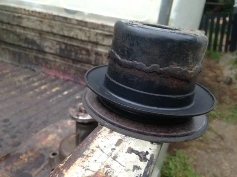

This is the weld that was done to the original pulley. Its obviously unbalanced and caused it to move around.

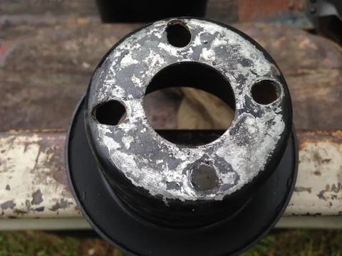

Which resulted in the four mounting holes elongating.
