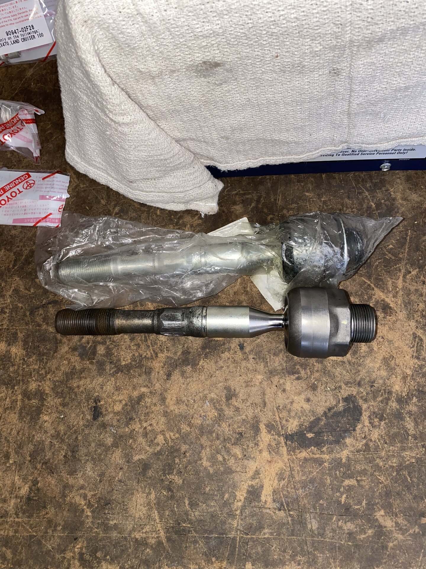

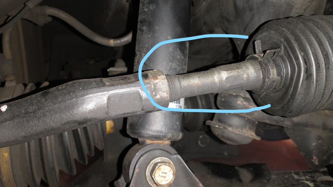

Actually, I was talking about the inner TRE to R&P shaft. Which is hidden by boot and staked/locked with a claw washer. These are very difficult to determine when loose. Unless very loose or boot large inner clamp undone and boot pulled back.
Record shows inner TRE replaced during accident related repairs. What I found interesting was; TOE off (out of alignment) after inner TRE torqued & locked back in. Which indicates they left it loose.
But we've now seen on few Rack & pinions. Where appearance is factory install with R&P, inner TRE's have come loose.

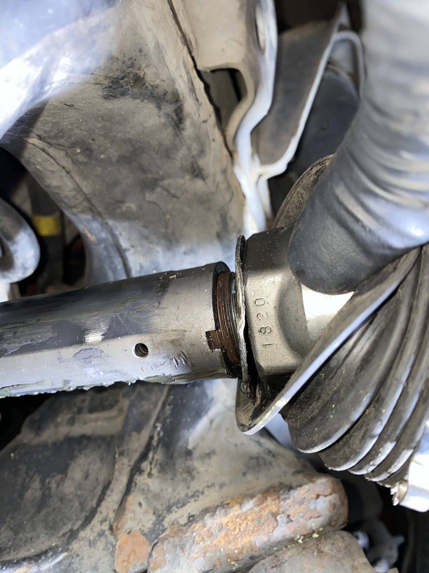

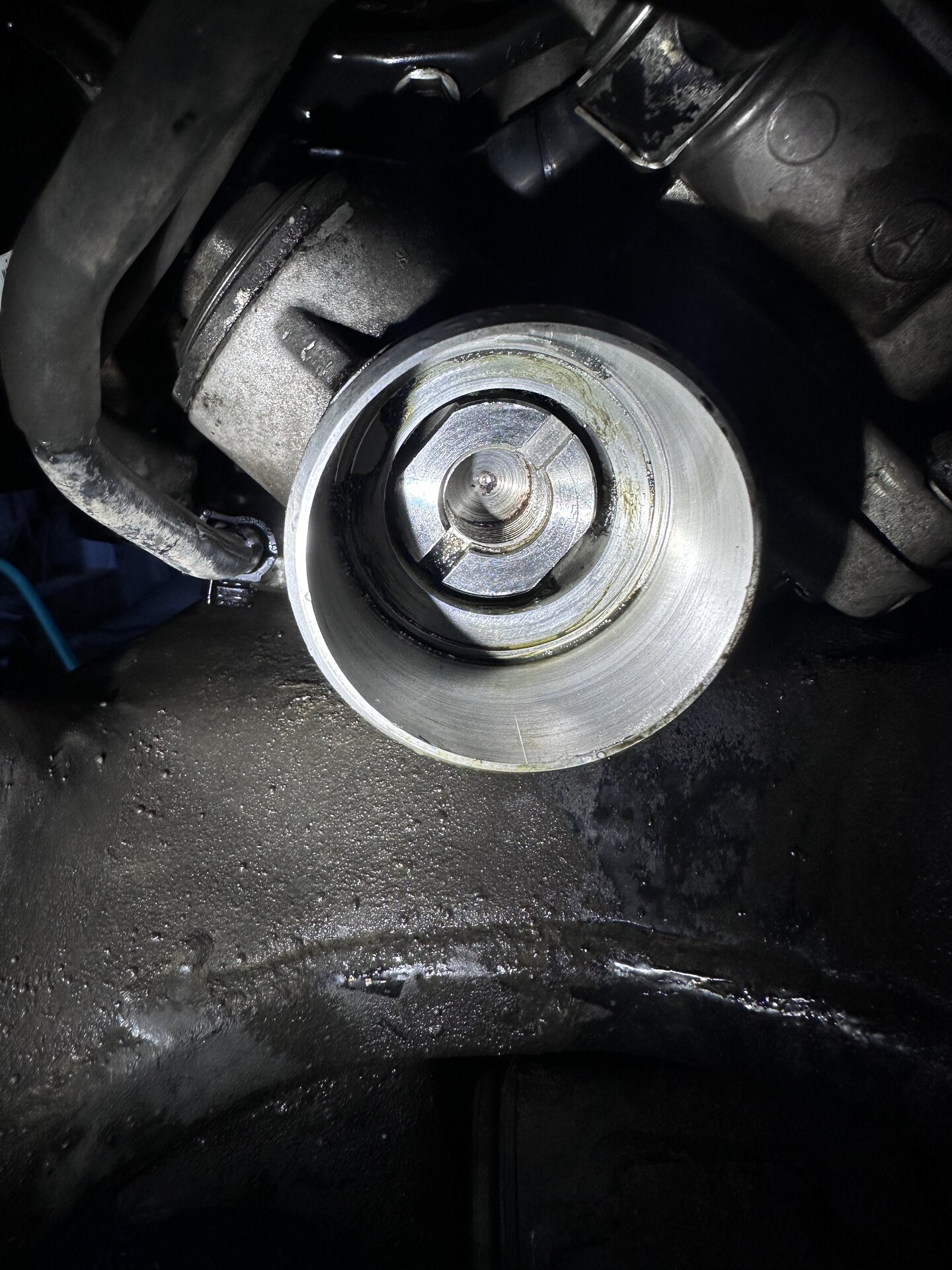

Today I pulled the tie rods off and found some oil inside of it. Not a ton but enough to piss a bit on the driveway.
I pulled the driver side because the boot was torn, after seeing the oil I pulled off the other side too and found the same thing.
I haven’t noticed any steering issues. Is my rack and pinion needing to be replaced or is this common? Trying to figure out what to do. Thanks.

I would clean up and check again in a week or two. I don't think you need to replace right away as long as it's just seeping. If there is significant loss then change it. When I changed mine I could see it leaking from the rack as soon as I cleaned up the visible fluid. Truck was still steering fine.

Cleaned it yesterday when I got the boot off and left it overnight. No additional fluid inside of the rack tonight.
That's great news!! Probably due to water mixed with a little oil. It would be ATF fluid leaking from the rack. When I had mine as you do and I turned the steering wheel all the way to lock outwards, fluid would be visibly coming out slowly and pulling. Nice job!!

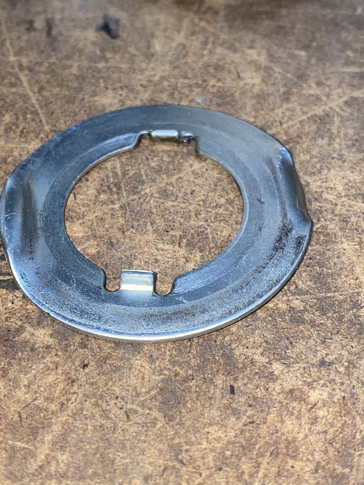

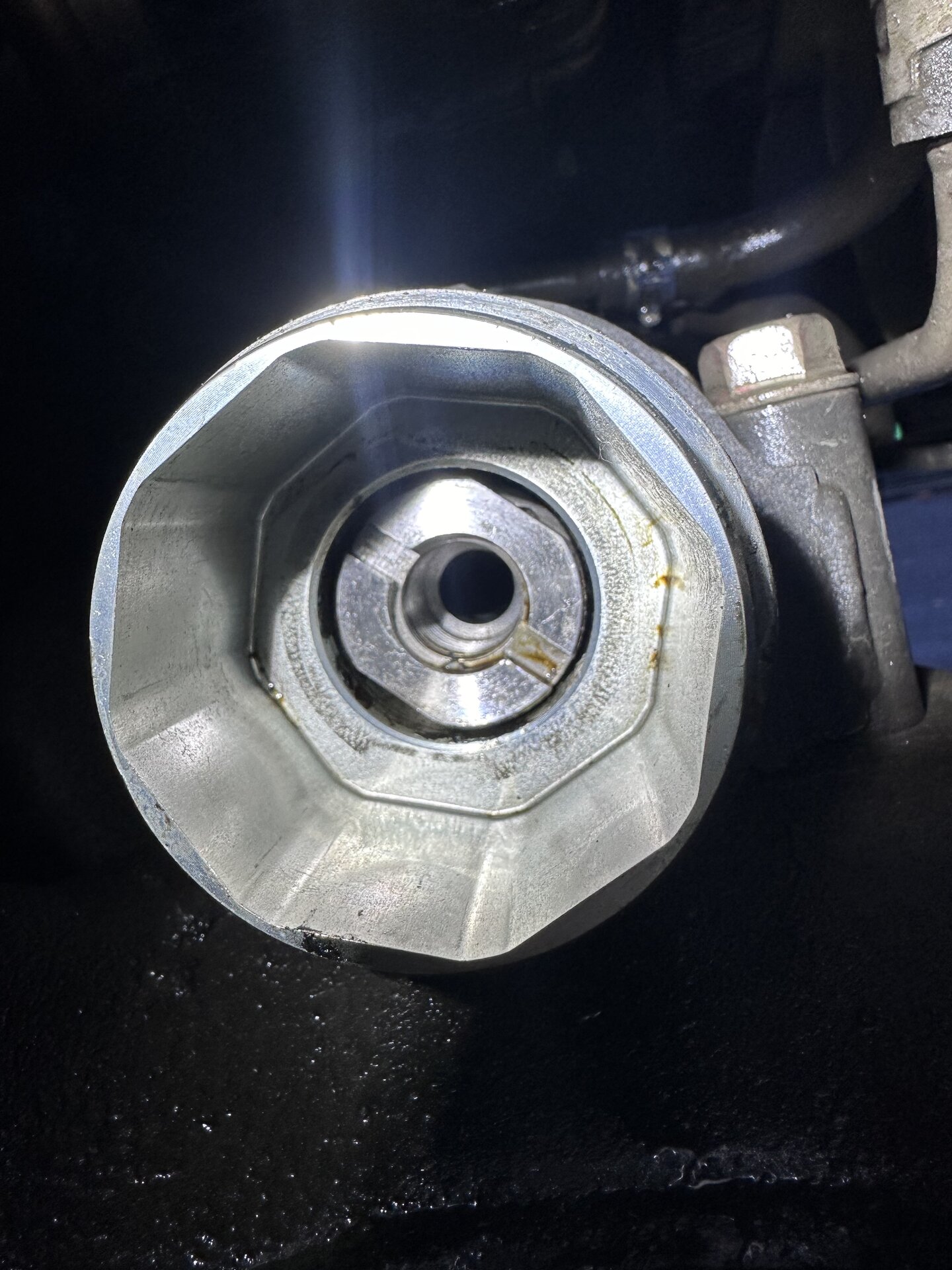

Inner TRE to rack torque 74ft-lbf. The lock washer is non reusable and must be properly stake/bent. You've been seeing some of these come loose. We suspect two reasons, inner TRE coming loose:
1) Breaking loose inner to outer TRE lock nut (41ft-lbf), without holding outer TRE with second wrench.
2) Reusing lock-washer and or failing to proper lock (stake/bend).

"never had to top out brake fluid in 4 years" Actually normal!
"Today I sat and let the truck run with the tie rods off turning it back and forth"
Very risky to be turning steering wheel, while rack disconnected from steering knuckle. This may, busted the clock spring.
When the vehicle tires on the ground and vane pumping fluid. As we turn the steering wheel, pressure increase inside the rack & pinion more so, than when tires off the ground. Early stage leak, would only be very minor weep at max pressure.
First clue of leak, is low PS reservoir fluid. No fluid lose in 4 years, there is no leak.
When I see bottom rack boot, wet. I look on top of boot for oil. If not oily on top of boot, 90% it's a rack leak. If oil also, on top of boot. It may be oil, from above. So further inspecting is needed.
Oil in boot, is PS fluid (ATF). If water in boot. Boot is either cut/rip or is not properly clamped. It's not grease & water mix.
We can live, with some minor leak. But must keep reservoir above low. We must also, keep oils off rubber bushings.

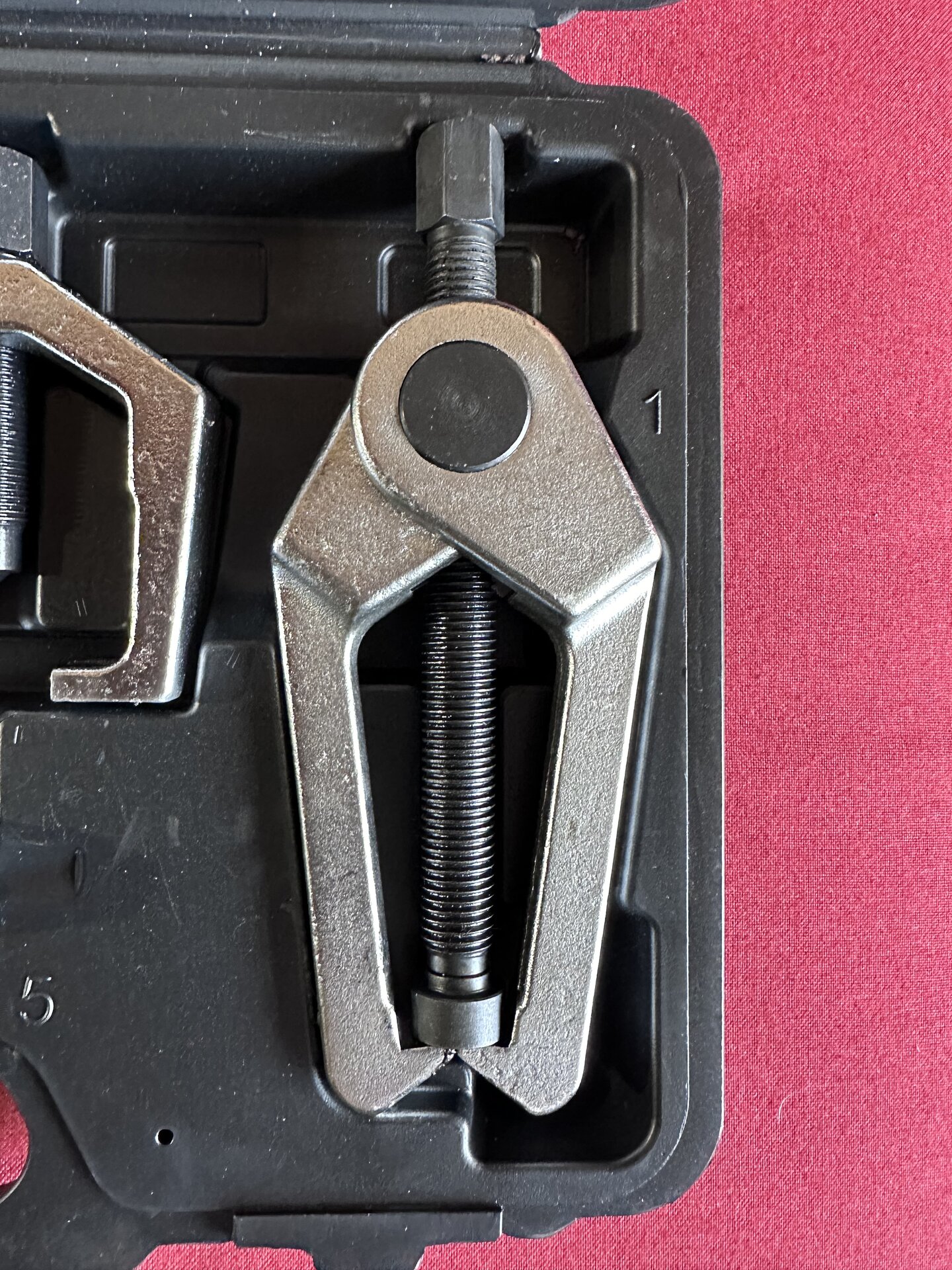

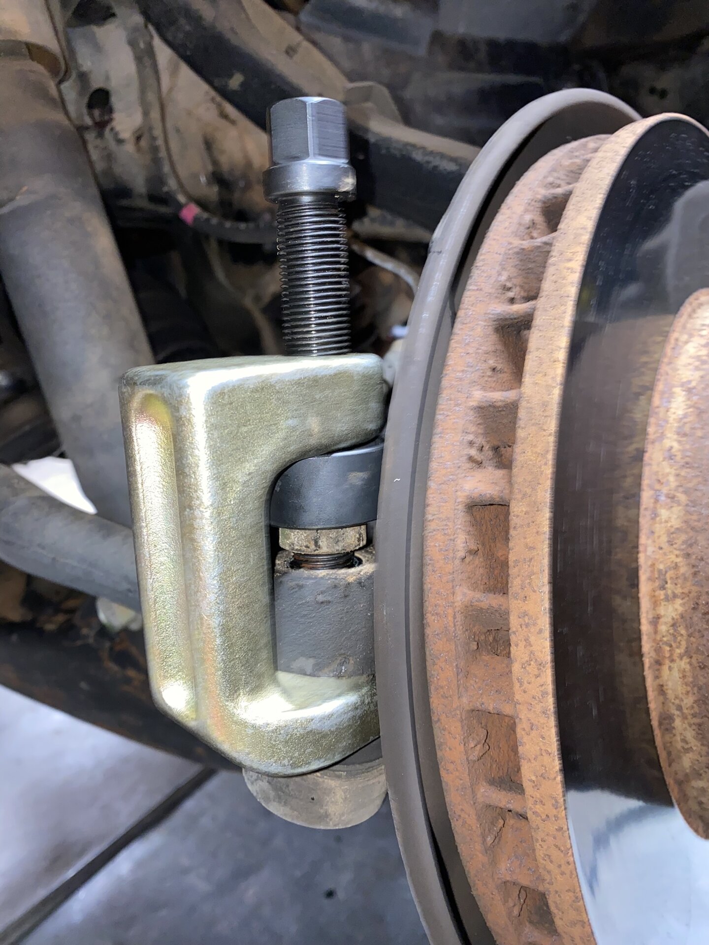

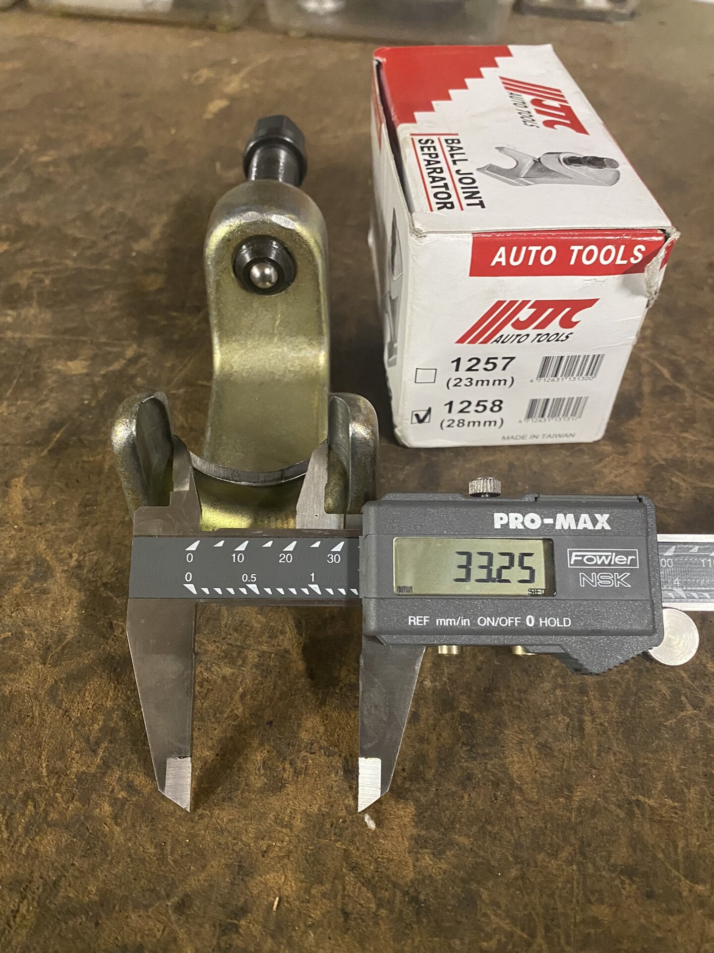

Did you have some issue with that TRE puller, hitting brake dust shield with rotor on?
I had one like your long leg puller, as a second choice. My first choice is a customized JTC-1258. Where I ground the opening a bit larger. Works really well.

Definitely will be grinding mine in the same way! It did hit the shield at first but I found if you get it in proper position it won’t touch it. Thanks!
