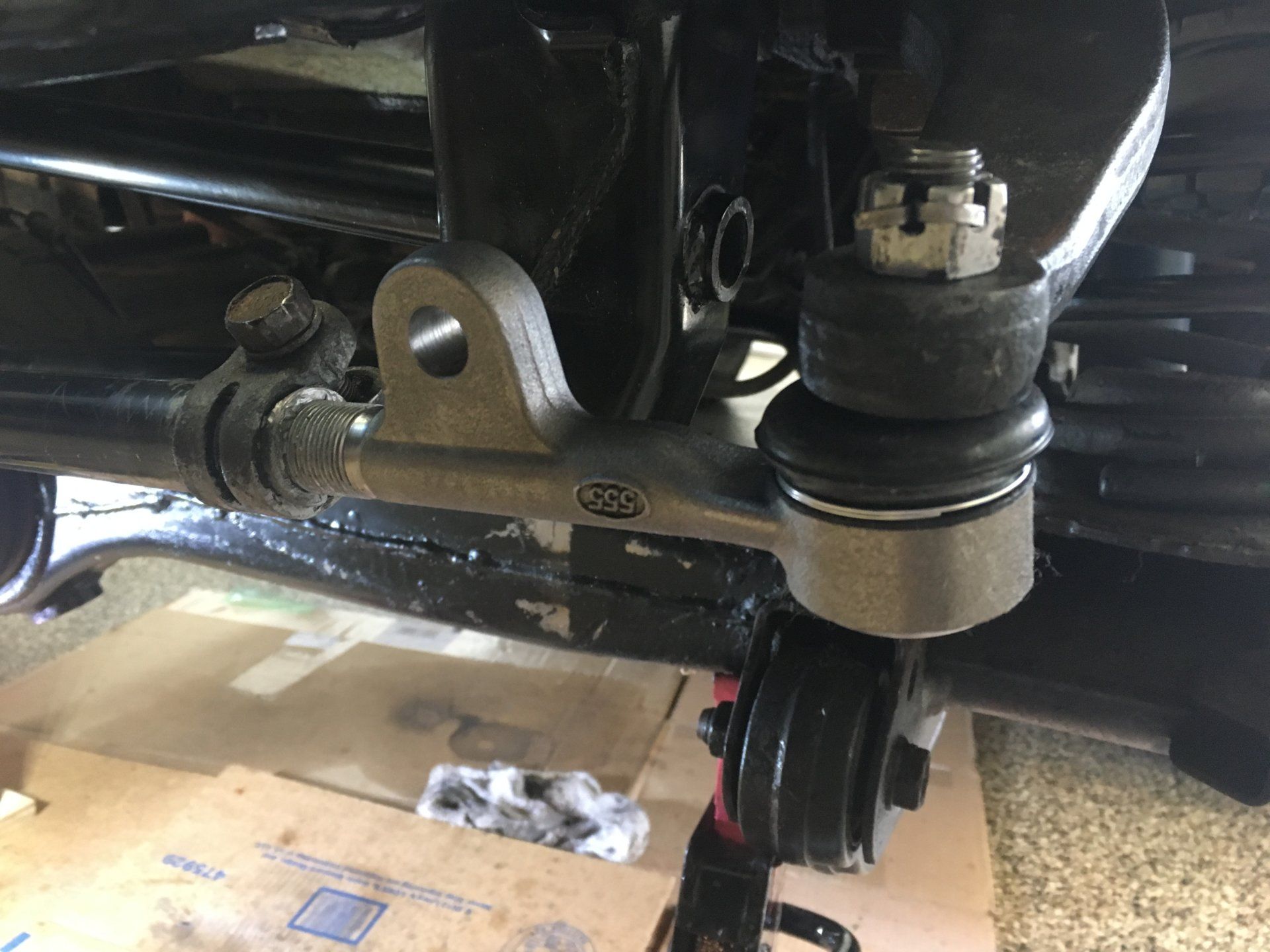

Adjusted steering gearbox pre-load to remove steering wheel slop.

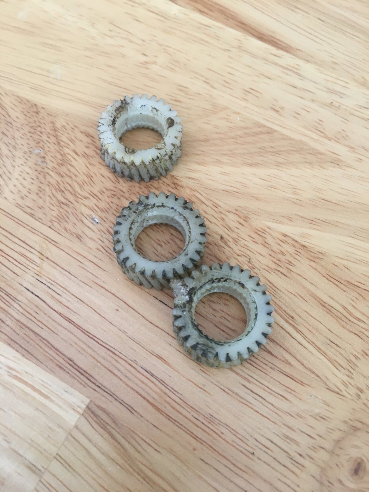

Fixed the seat motor gears. Both seats now move very nicely!

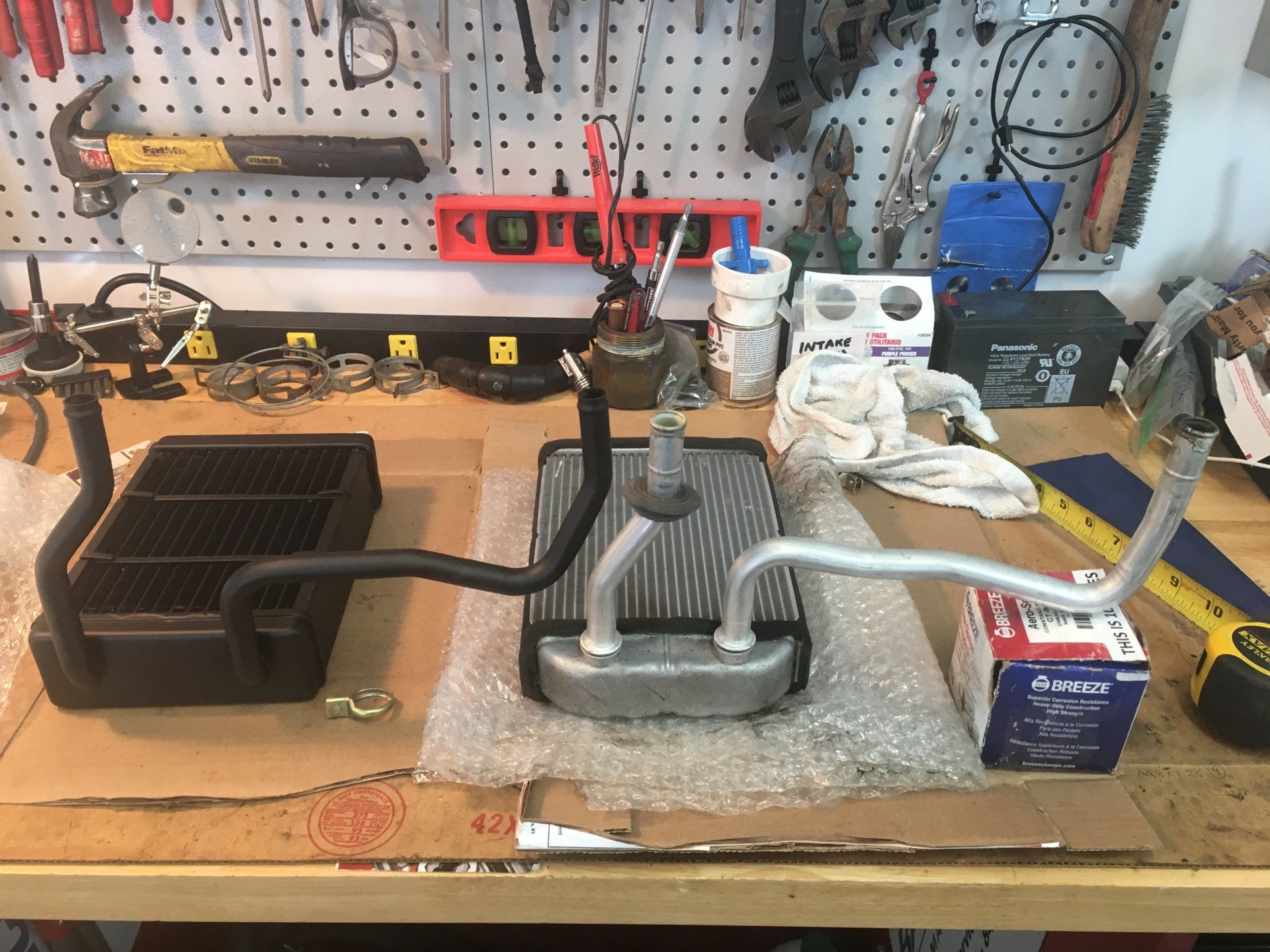

I've bypassed the front heater core since I know it's leaking. Will address in the fall.
