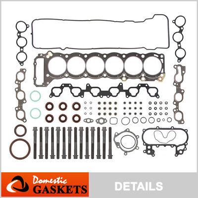

I spoke to the previous owner and learned that this was the previous "kit" used to do the head gasket a 1.5 years ago. $114 from eBay. Thoughts?
I am going to replace all of those parts including the head bolts.
From the areas that it's leaking I don't think that all the parts of this kit were used and if they were the quality shows.
sure if you like doing headgaskets for fun. just get a head kit from the dealership, itll have everything that you need similar to that kit and yes it will be more expensive but headgasket is something tha ti would want to go oem with.

I will absolutely be using OEM. Just pointing out what the previous owner used as his kit 1.5 years ago.
