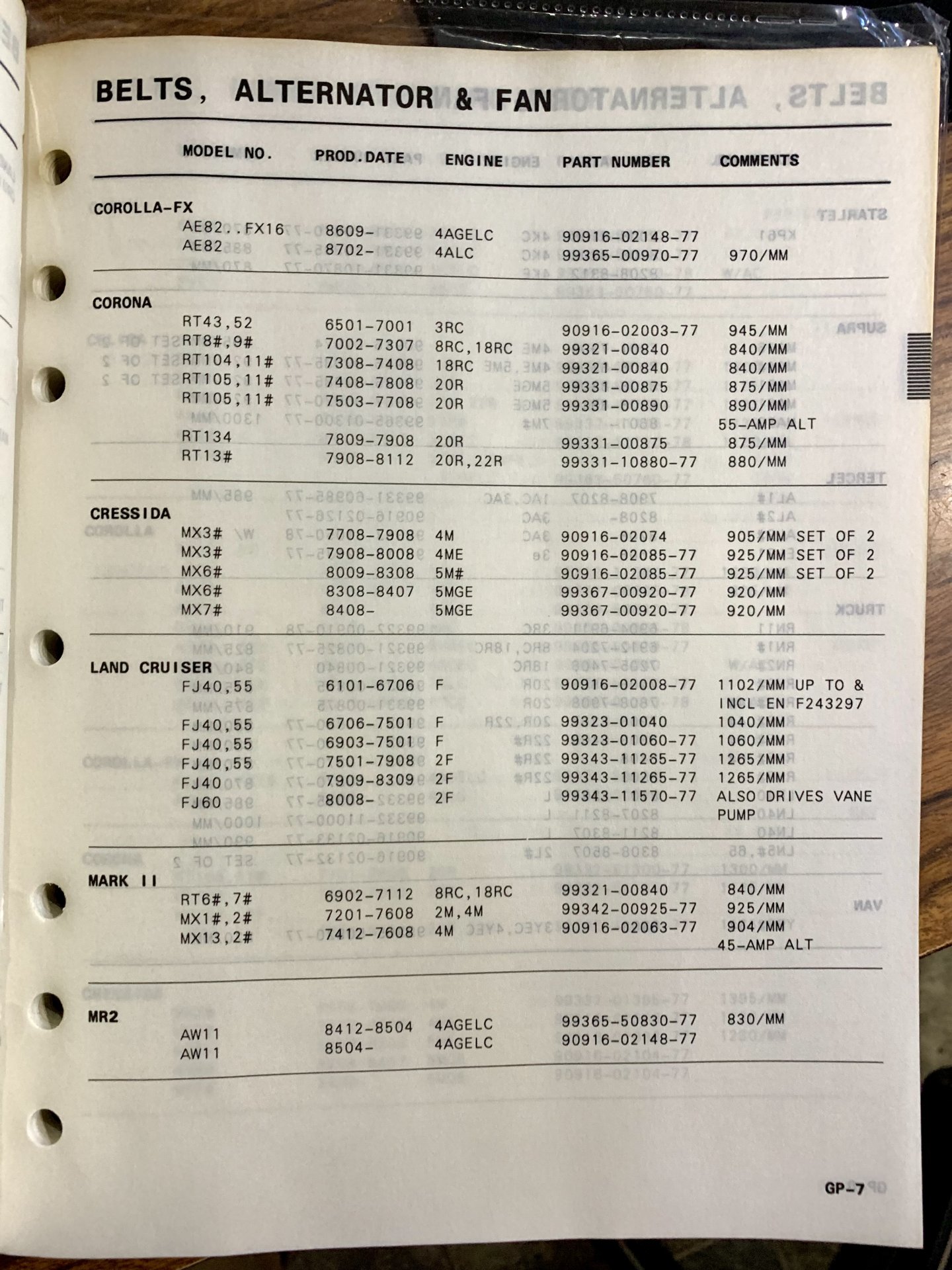

now , now ......
this is a EAZY PEEZY issue to resolve 🤔
NOTE : The Nomenclature Foot Notes in my 1987 USA Spec. Dealership issued Fast-Mover ..
- i bet @cruiserdan still has his Copy :cool:
- i almost forgot to ask ?
Does the
YELLOW / WHITE Mitsubishi / BANDO / OEM TOYOTA part # 99343-11265-77 match exactly what IS stamped on the DRIVE BELT itself in colored ink ?
