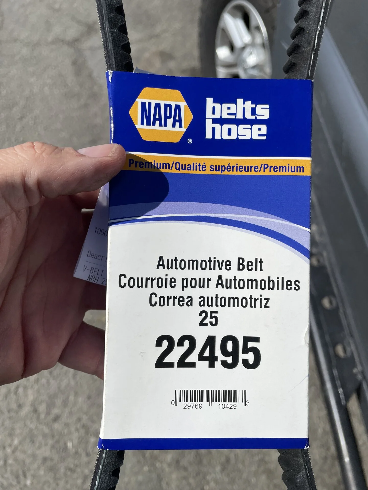

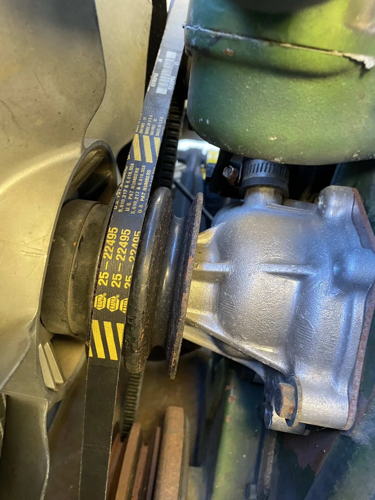

I was hit up in a DM to provide the outcome of this and while I have a Toyota belt for when I finally install the correct alternator for now to keep me enjoying her. Toyota no longer sells the two shorter belts that would have worked so I went with Napa and after a few tries I got the 25-22495 to work for me.
