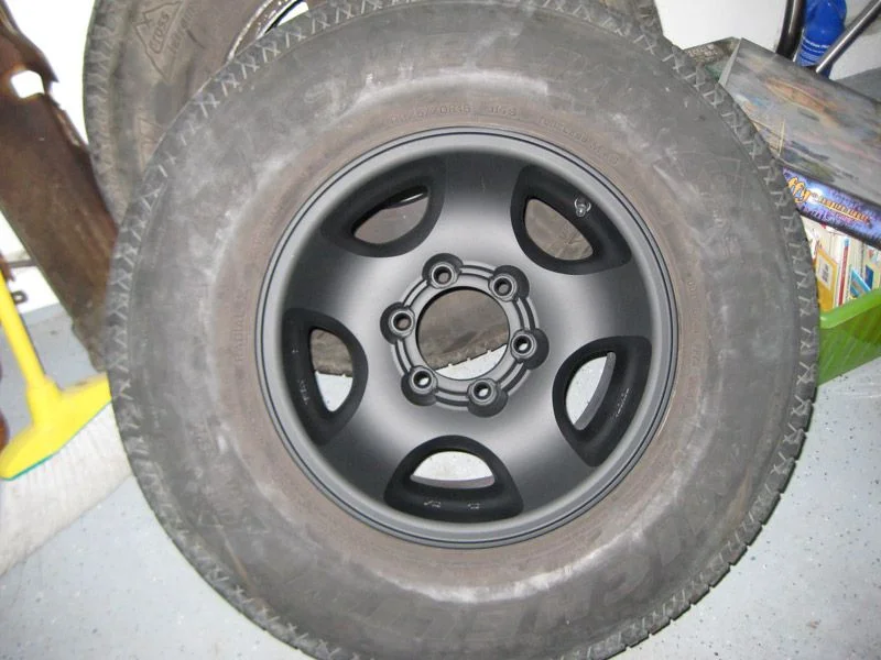

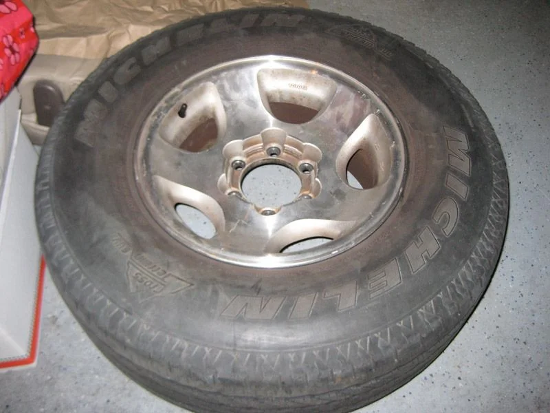

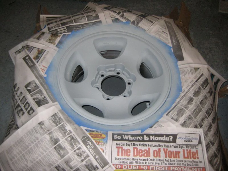

Decided to mess with my wheels instead of doing emissions crap today. Took my 80 series wheels and cleaned them up best I could and then wiped them down with mineral spirits. Then two coats of primer and three coats of flat black.

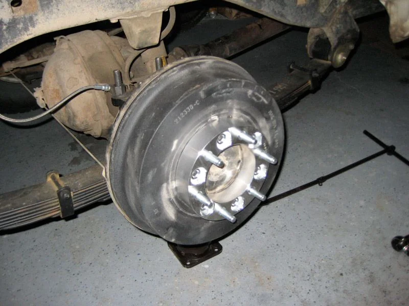

Installed the Marlin 1.5" wheel spacers. Used anti-seize on both studs and torqued to 75ft lbs. Curious to see how the tires are going to fare when the axles are articulated. I guess we'll find out soon enough.

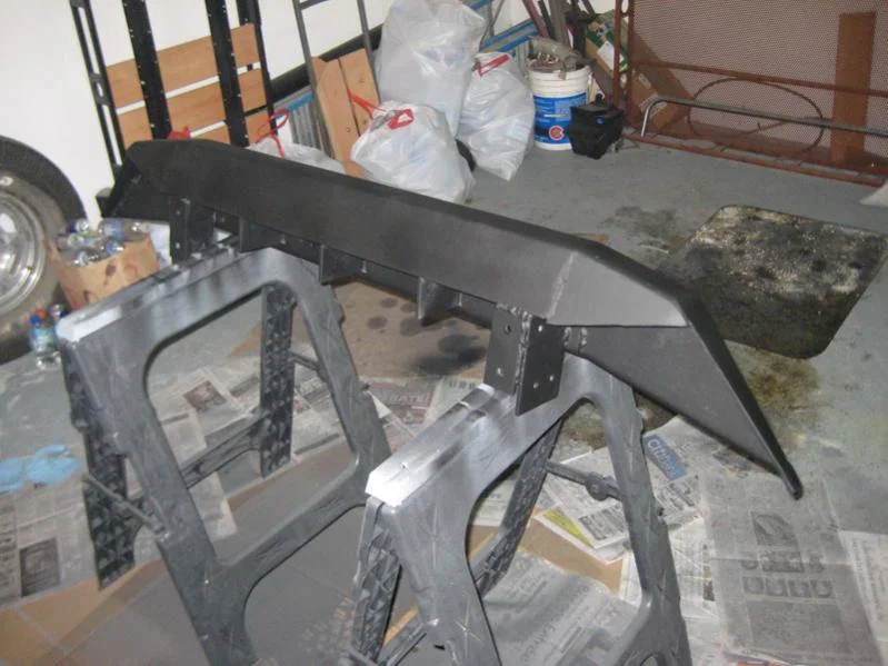

Also got the new (to me) front bumper primered and painted also flat black. I just need to hit up a welding shop to get them to take off these riveted brackets on the front that are connected to the frame. Then I just need some grade 8s or 11.9s if I can locate some locally.

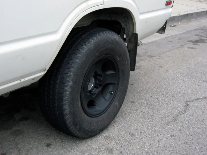

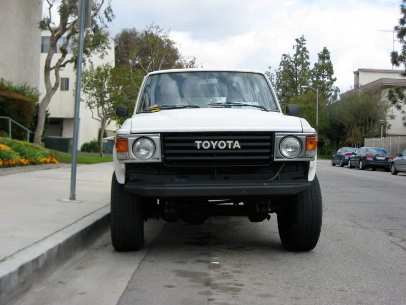

Finally got the wheels on, the bumper painted and installed and the grilled blacked out. Over this weekend I will be taking pieces of and blasting them with flat black :grinpimp:
Is that a ticket under your wiper ? :D
