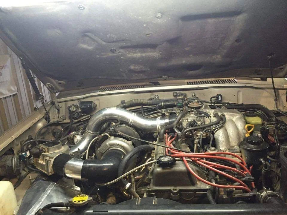

sorry I must've missed it but what caused you to go with MAPECU vs AEM or other piggyback setups that have been done?
Tried and failed with both AEM infinity 6 and an Emanage Ultimate.
Getting close. Maybe 2 weeks out.
Pic in current configuration
Wideband is losing signal
CX racing intercooler heat exchanger has holes in it - presumably from removal/install... Getting a better replacement. Thankfully that's not that expensive.
But... IT'S RUNNING!!!!!
And DRIVING!! Holy cow!!!! Nice work!!
hopefully he can figure out the wideband quick, get the new heat exchanger installed and throw a tune on it and I'll be good to go.
Also needs two O2 sensors
