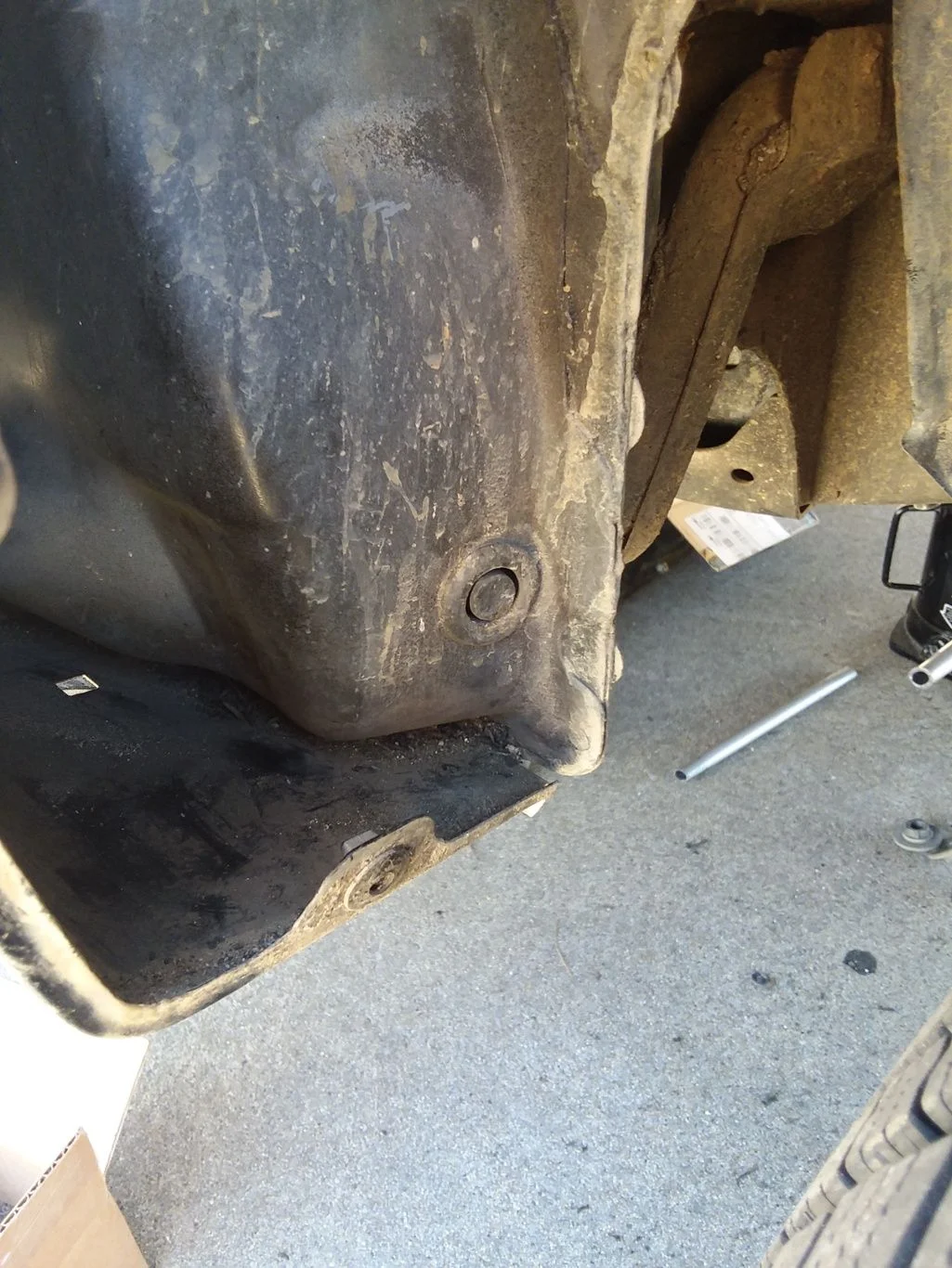

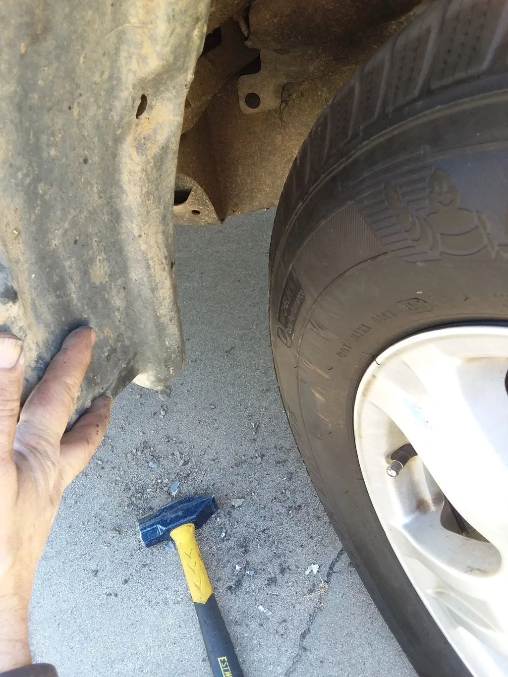

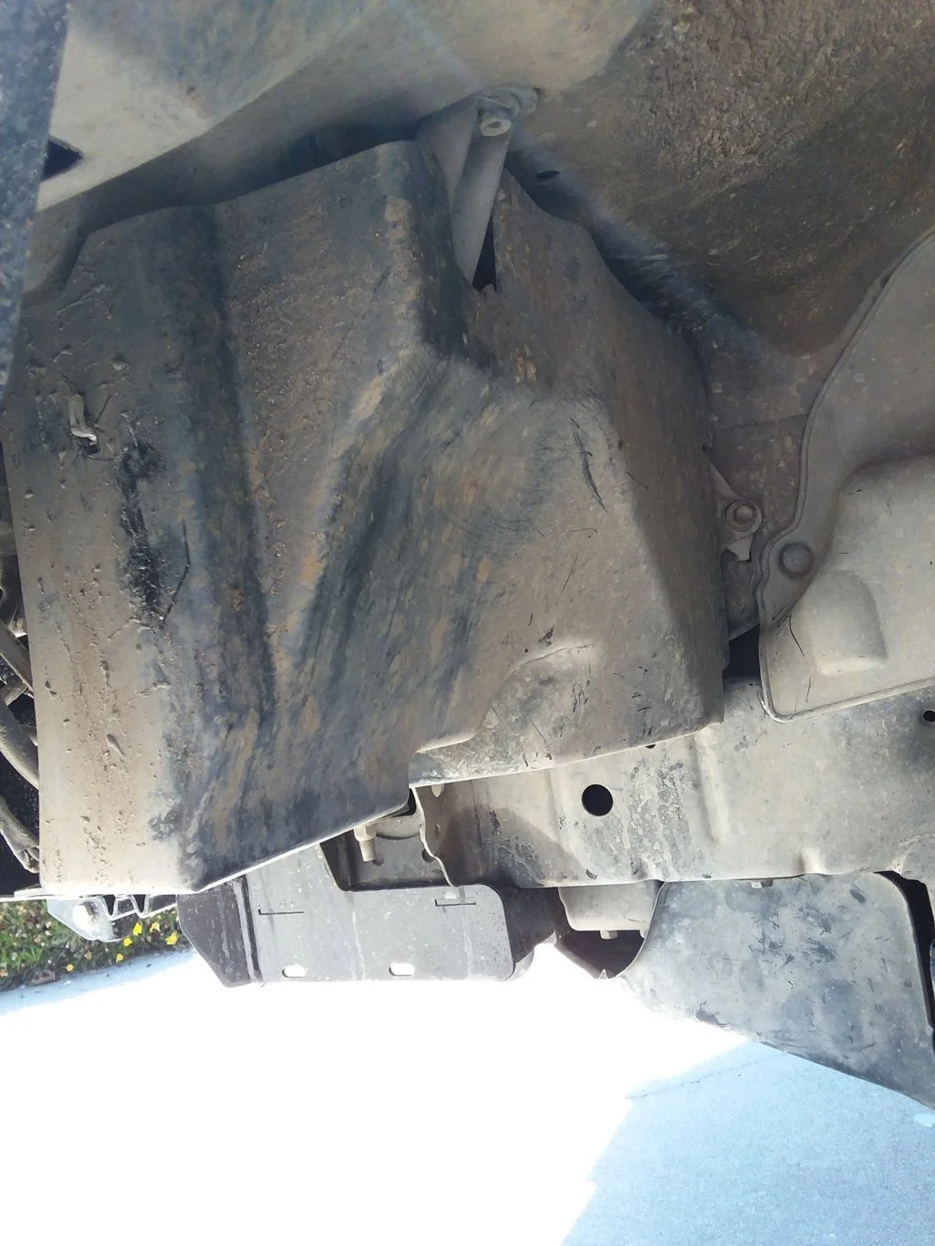

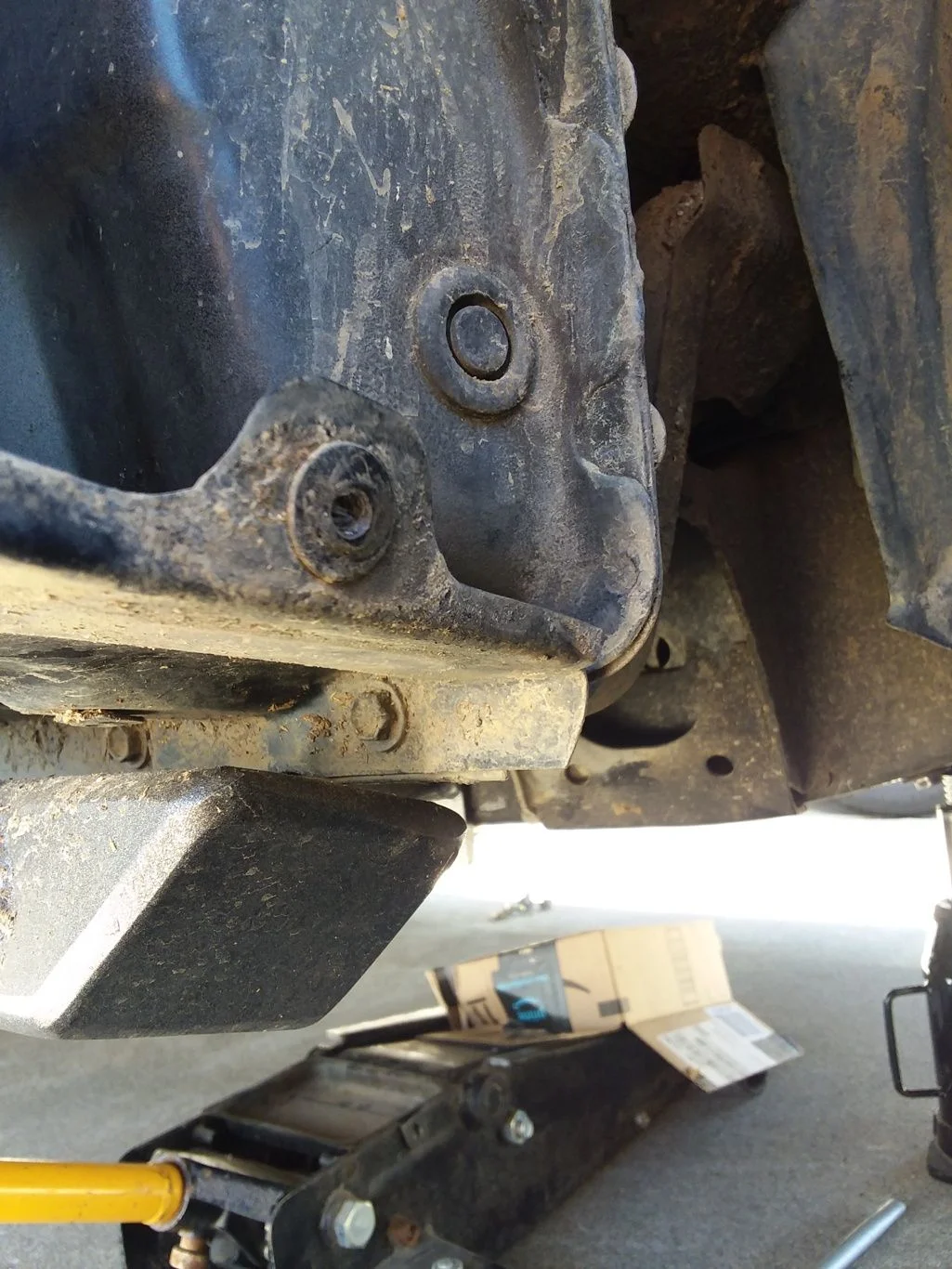

first step is to get an idea of what you're dealing with. after removing the plastic liner here is what the pinch weld area looks like.

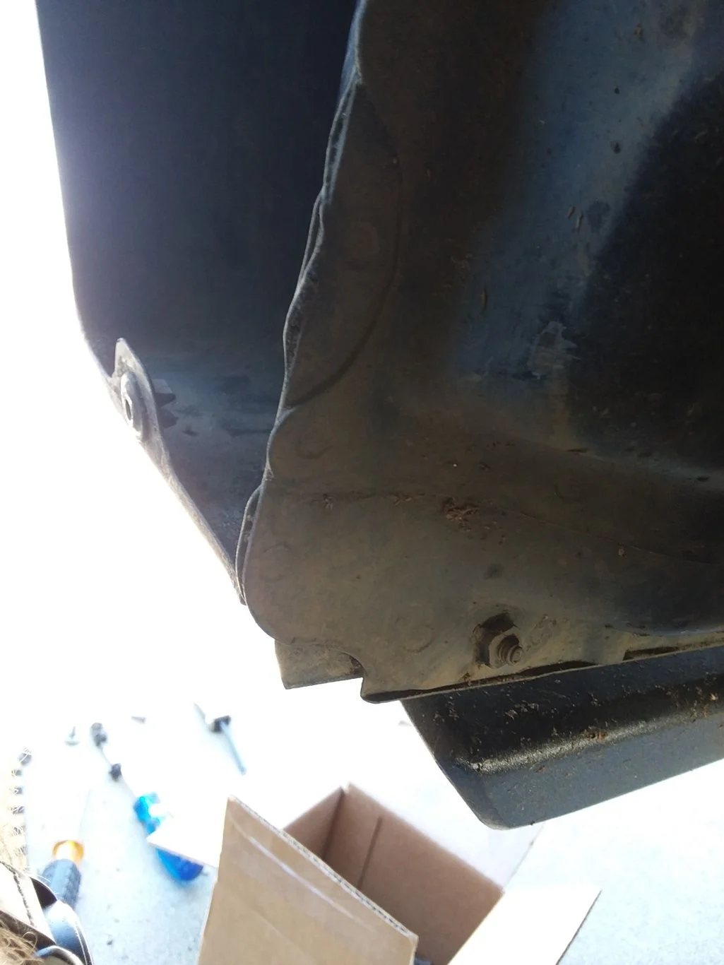

the back side

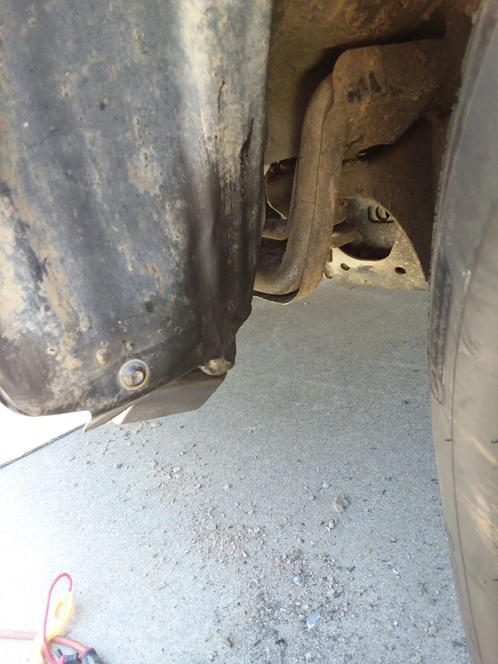

and from below

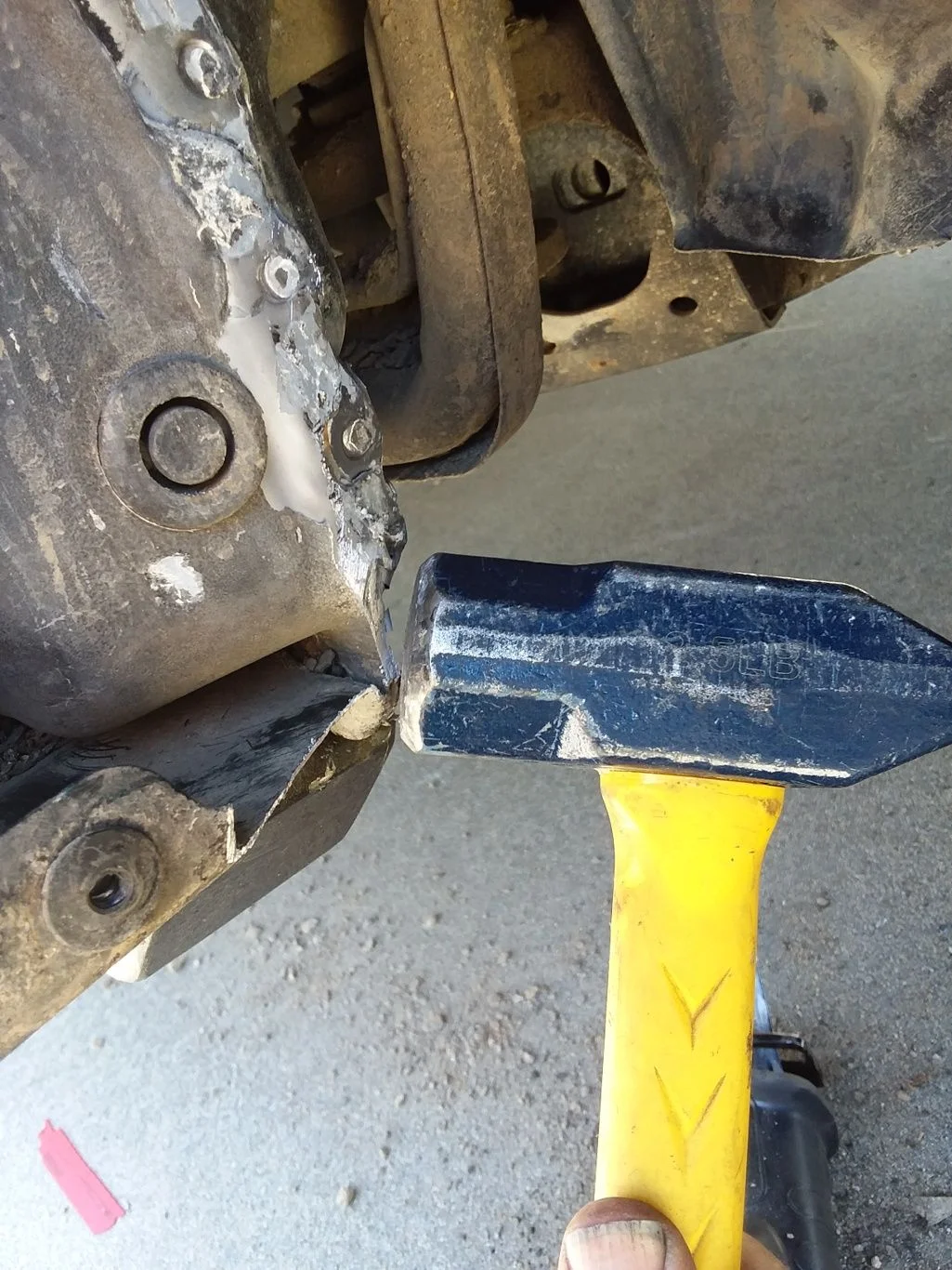

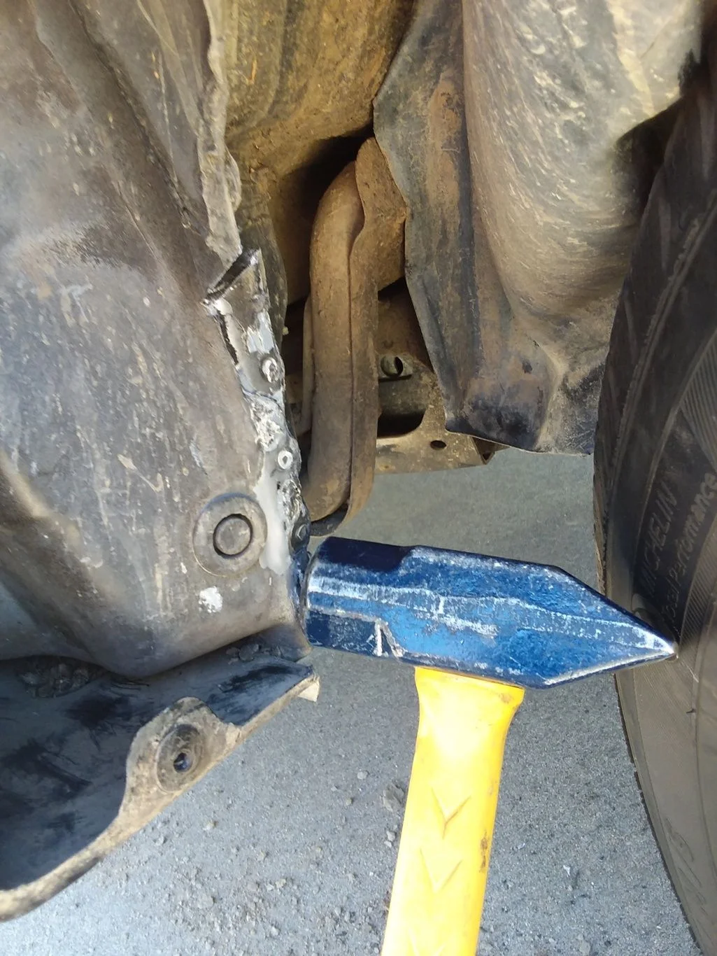

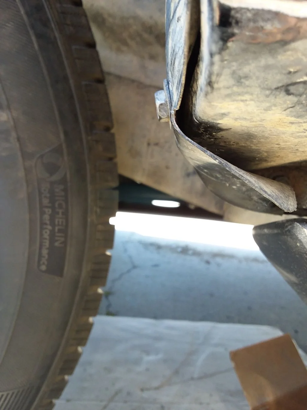

there's several ways to do this depending on the amount of tools you have. to make it easier to pound the pinch weld over, i start with a cut about 6 inches up. you can use a grinder as well for this.
then hammer the pinch weld over as far as you can. undercoating will come off and the weld will seperate in ares but by hammering it over it will maintain integrity

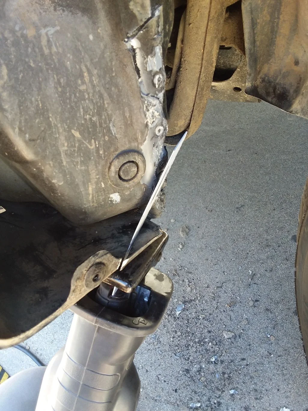

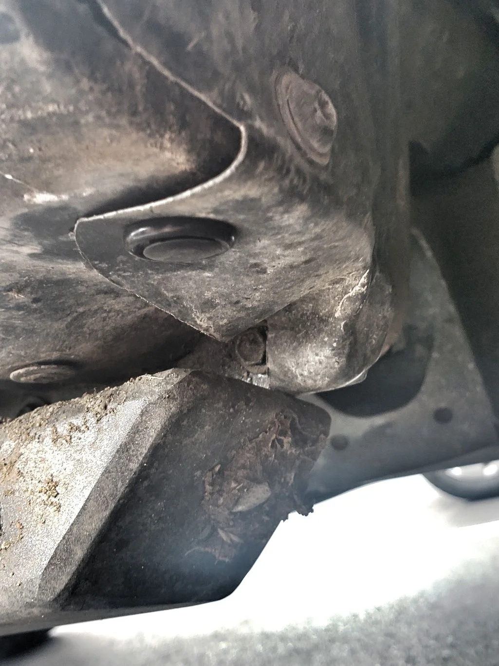

next i made another cut to maximize the clearance. i retained the fender liner bolt location.
i hammered again to soften edges. you could file the rough edges too. i also flaked off all the loose undercoating. those areas will harbor moisture and rust.
be sure to paint the exposed metal. get behind it as best you can
these shots show how much difference you are making in the critical area.

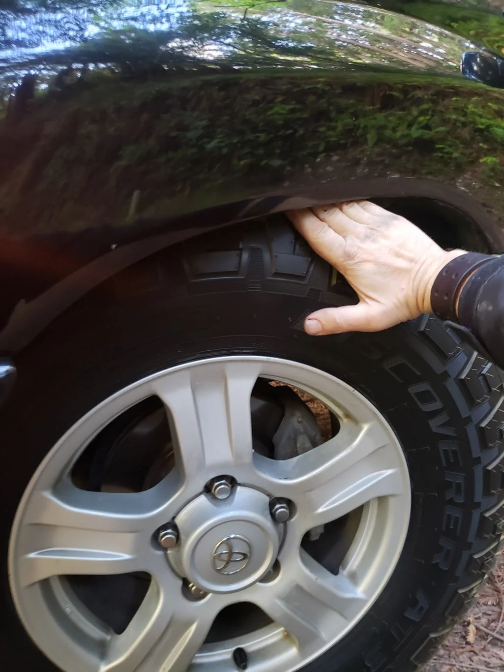

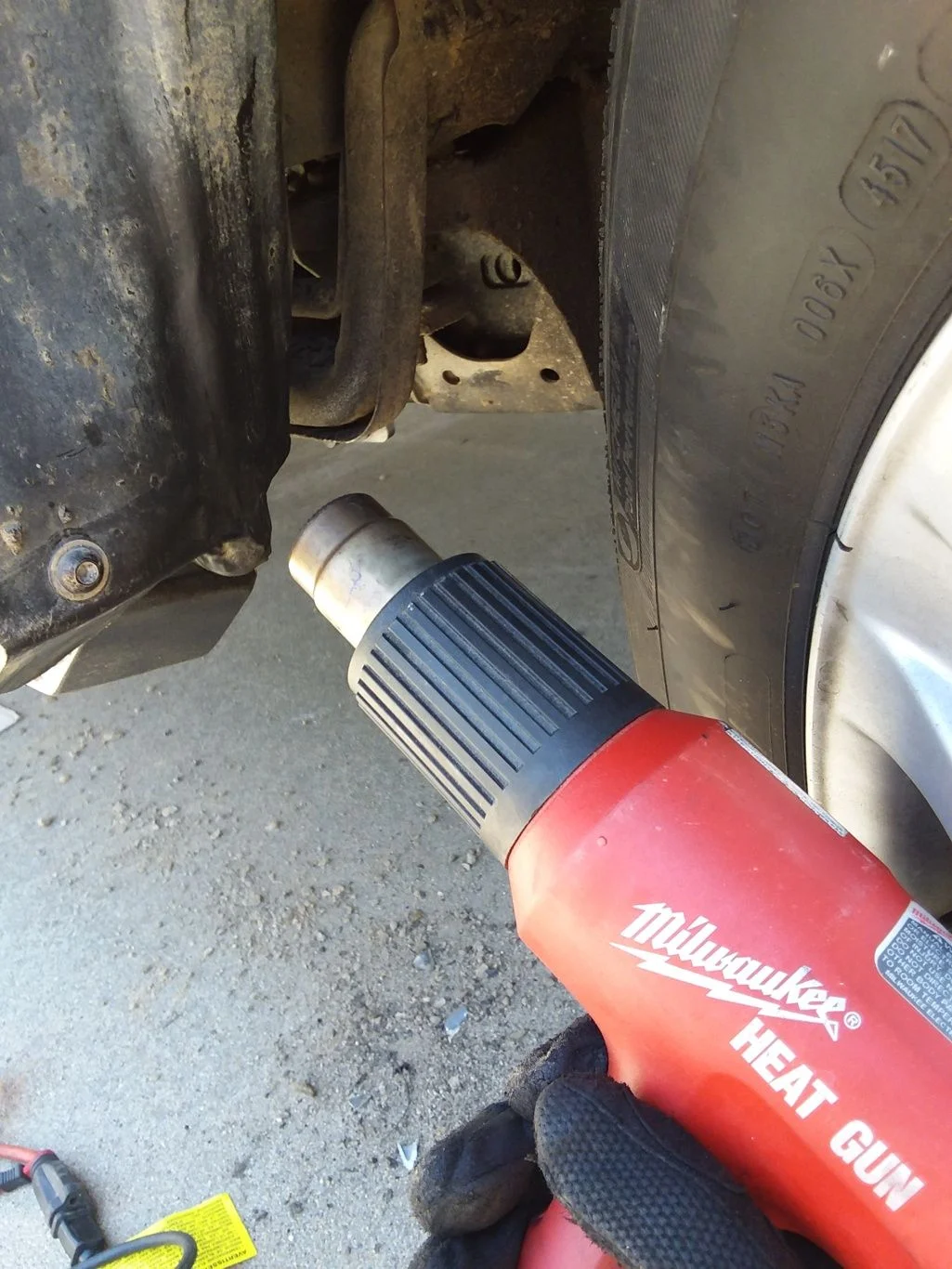

next comes heat gunning the plastic. many just cut the plastic part that sticks out off. i wanted to save this area from moisture and road salt as best i could.
heat the plastic and with a gloved hand or some tool, shape it against the metal while it's pliable.
here's the passenger side after. its pretty much hugging the metal.
here's a shot from the DS showing the profile of what you're doing.

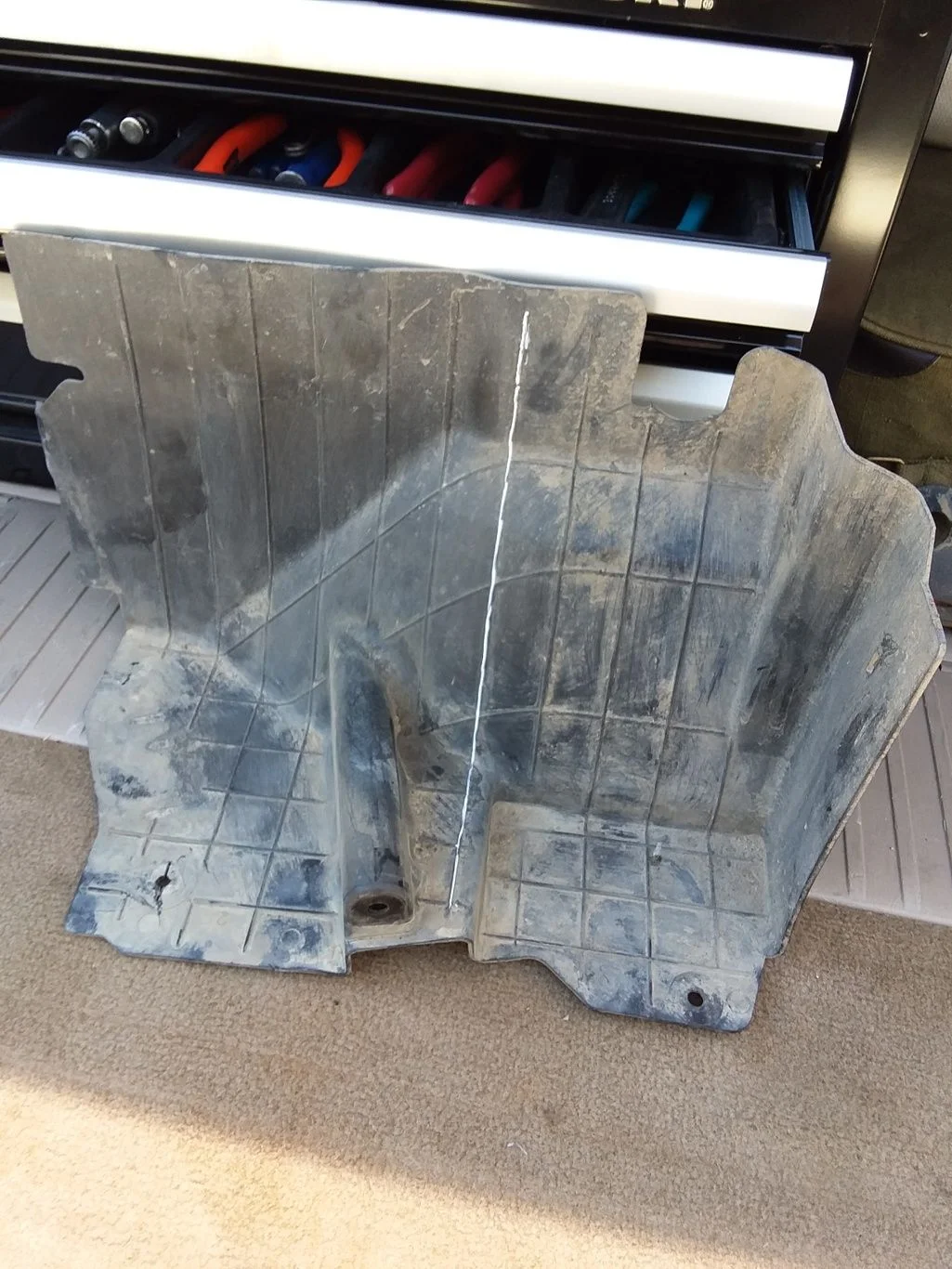

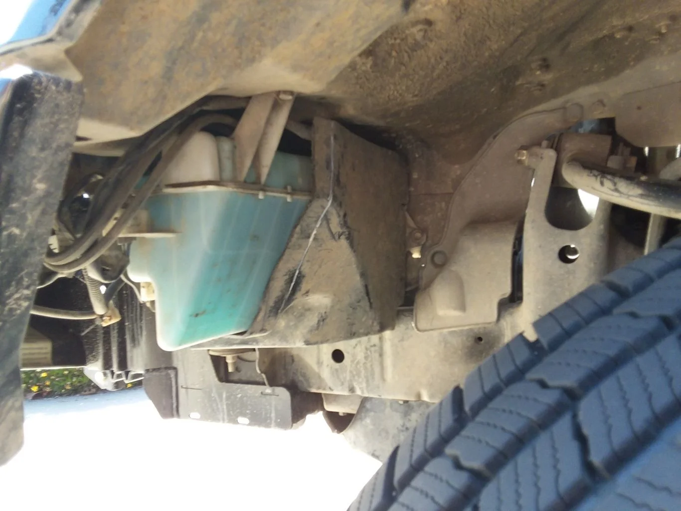

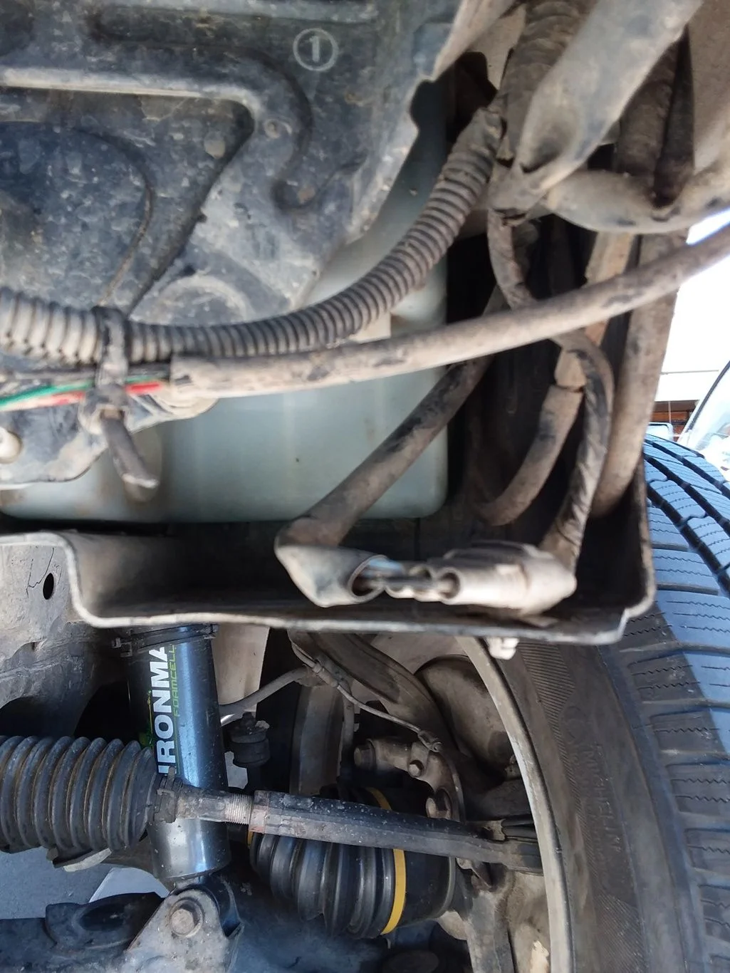

if you are indeed going with 35 inch tires, you may need to trim the windshield washer fluid shield as well. its on the DS and there's many ways to tackle this as well.
some heat gun and shape it, but it's pretty thick and I didn't want to do that.some trim just the area that's rubbing. you could remove the shield entirely but i chose to retain half of it to protect the pumps, indicated by the marker.
the white line was a preliminary plan as to where i could trim but retain the mounting points.
here's a shot from the front of the vehicle so you can see the excess space taken up by the shield.

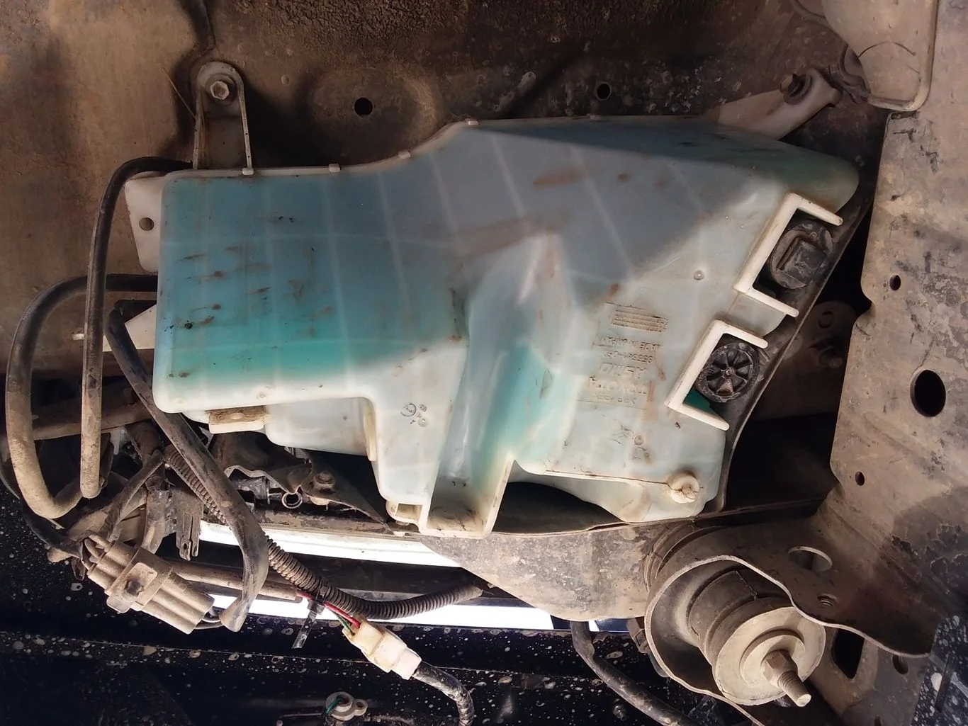

here is the shield removed. note the 3 mounting locations hold the tank in position. only 2 of them are used to also hold the shield on. (plus a little hook on the end).

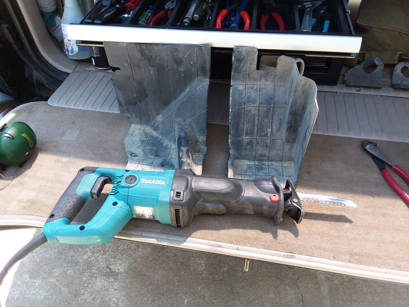

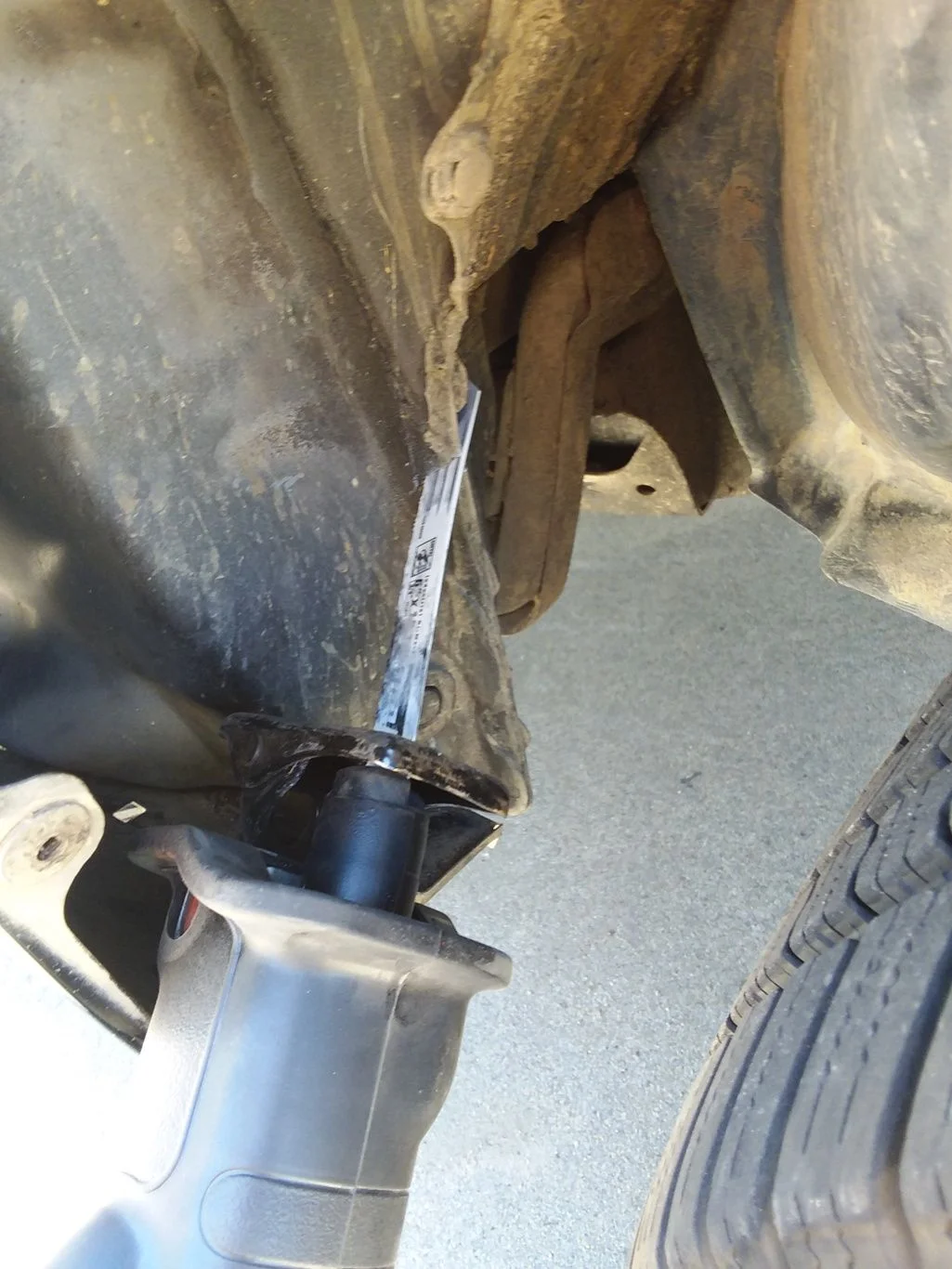

once removed i found the inner moulded ribs gave a good guide for the saw.
i used the sawsall but you could do this with shears probably. whatever you got. utility knife maybe. hand saw definately.

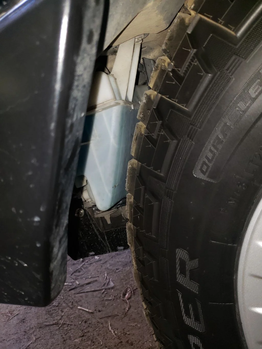

the outer side discarded, and remainder mounted.
i can trim more of i need too but this should prevent me from having issues at the tire shop when mounting.
as a bonus i can now easily check my fluid level for the washer fluid:)

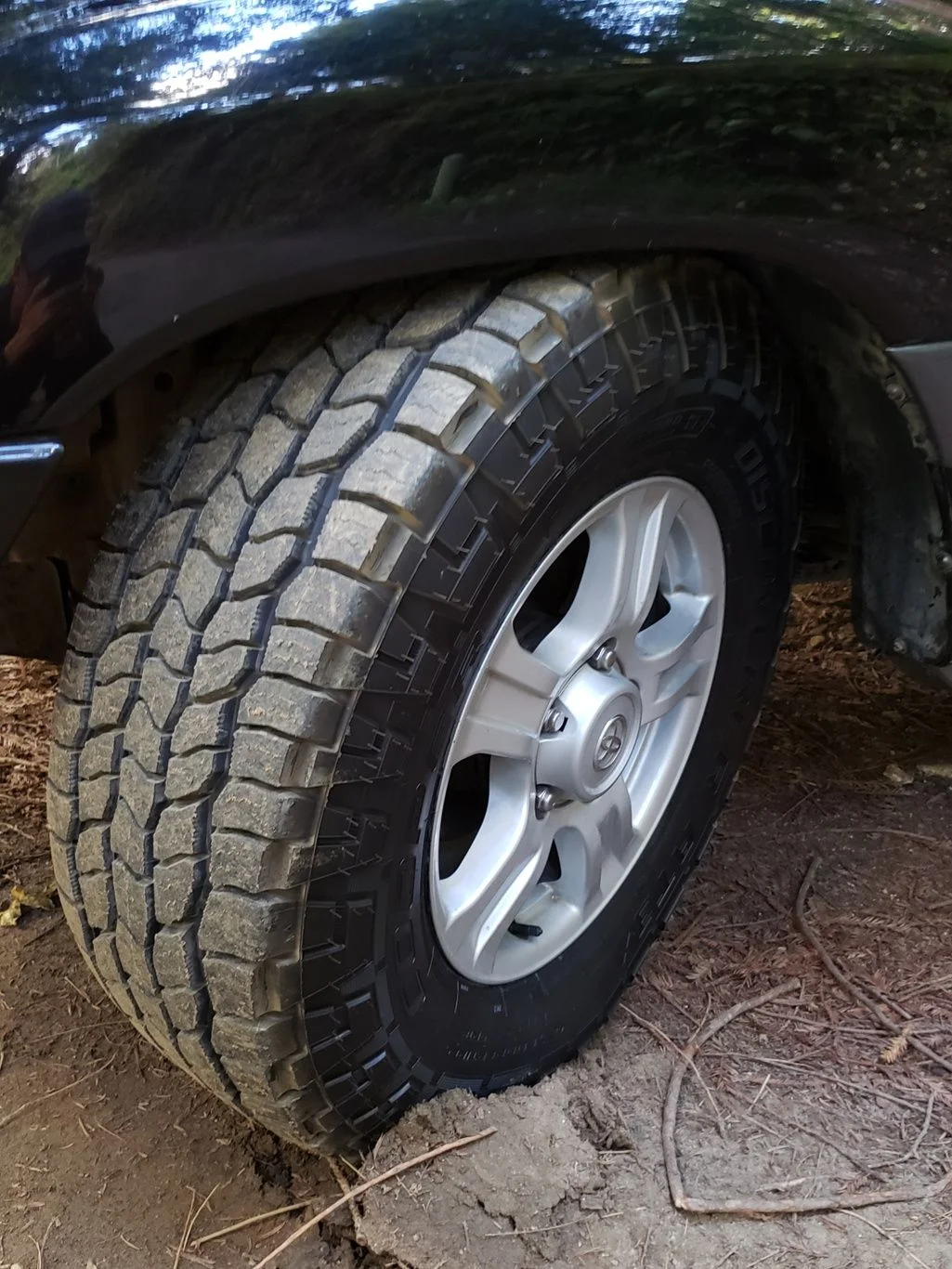

I got the new tires mounted and hit some trails and tried to flex it up. I disconnected the sway bars to help. I couldn't make it rub though I didn't quite hit the bump stop though (could go about another inch to compress the bump). Glad I trimmed the washer cover. It came very close .
In case I didn't mention, these are cooper discoverer AT3 XLT 285/75R18 on tundra wheels, no spacers and stock UCA. 2" ironman lift. Sitting at 21" hub to fender. I'm trying to keep it as low as possible.

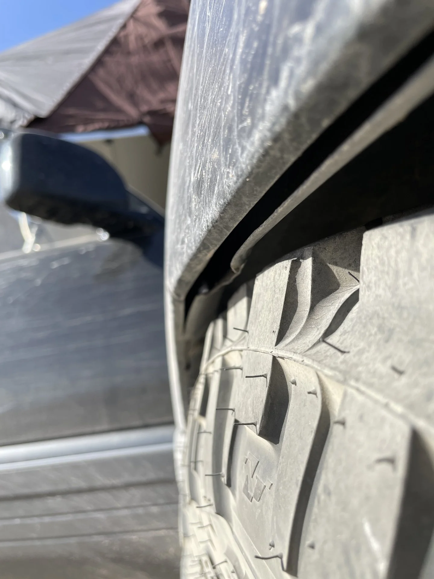

This is 35x11.5R18 NTG with 1.25" front spacer... AHC in LO and semi-flexed. Another inch or so of up travel. Rubs the plastic liner a bit on higher speed "whoops" but has never damaged the fender.
