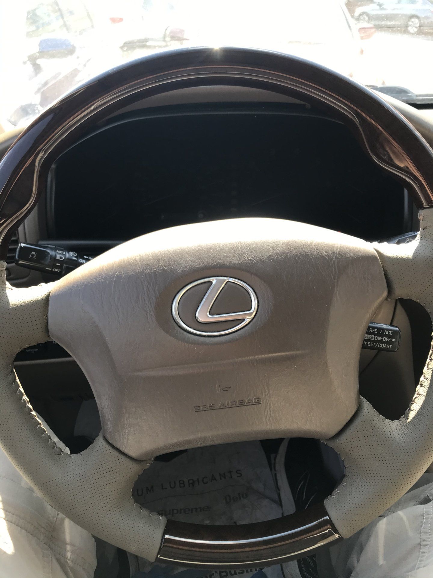

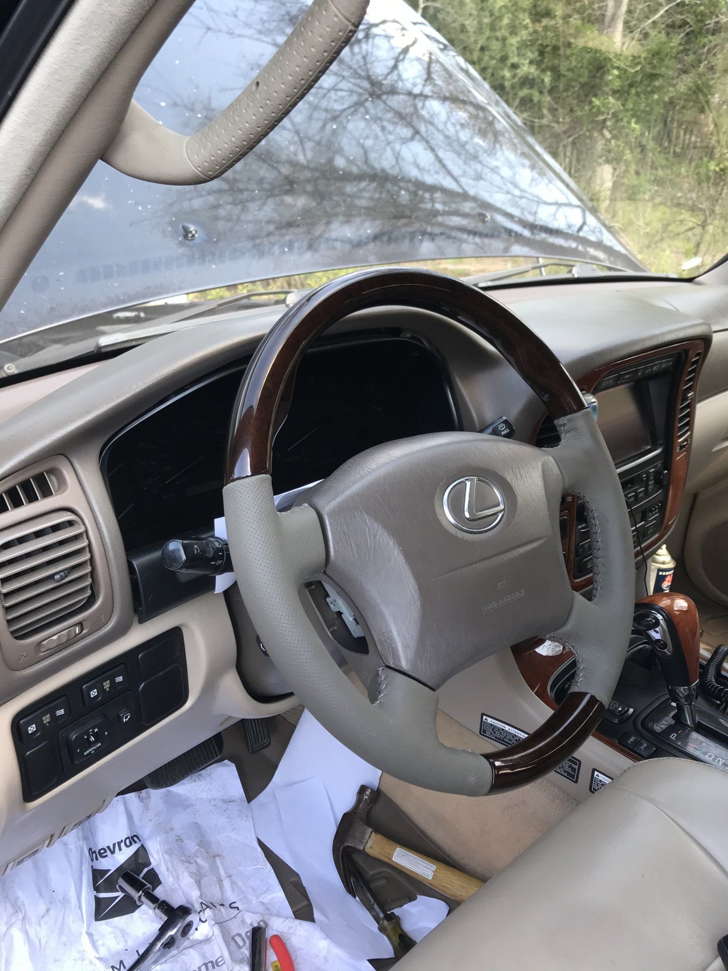

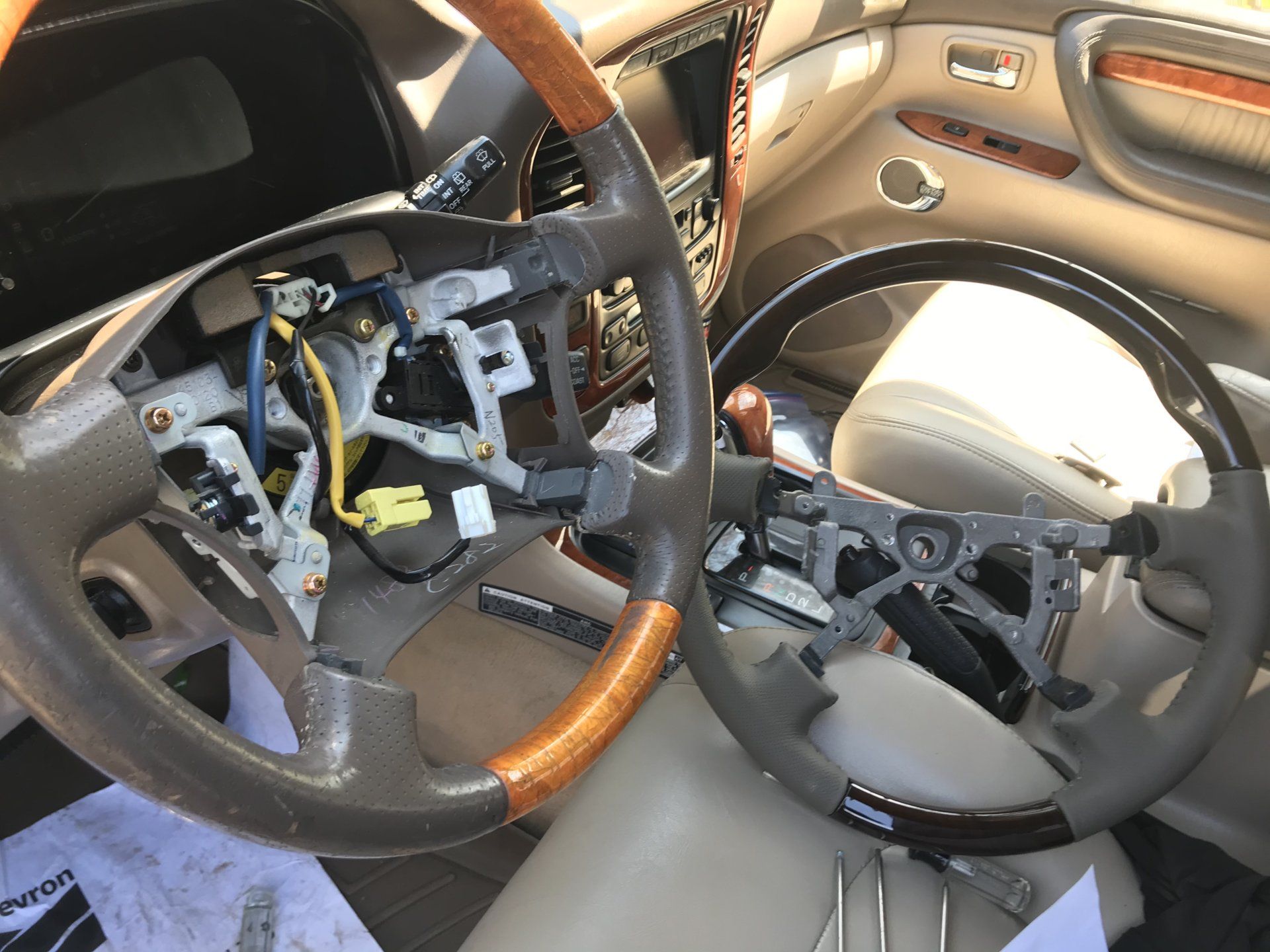

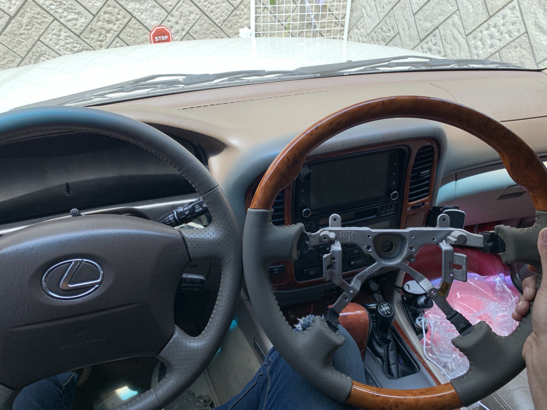

Searched and read up on steering wheel upgrades in the forum and the web.
Finally got it done. 3 hours, only bc I made few mistakes. I could probably do it in 45 min now.
Color is slightly off, but much better than my old steering wheel.
Wheel is from Taiwan. Great sellar on eBay. About $250.

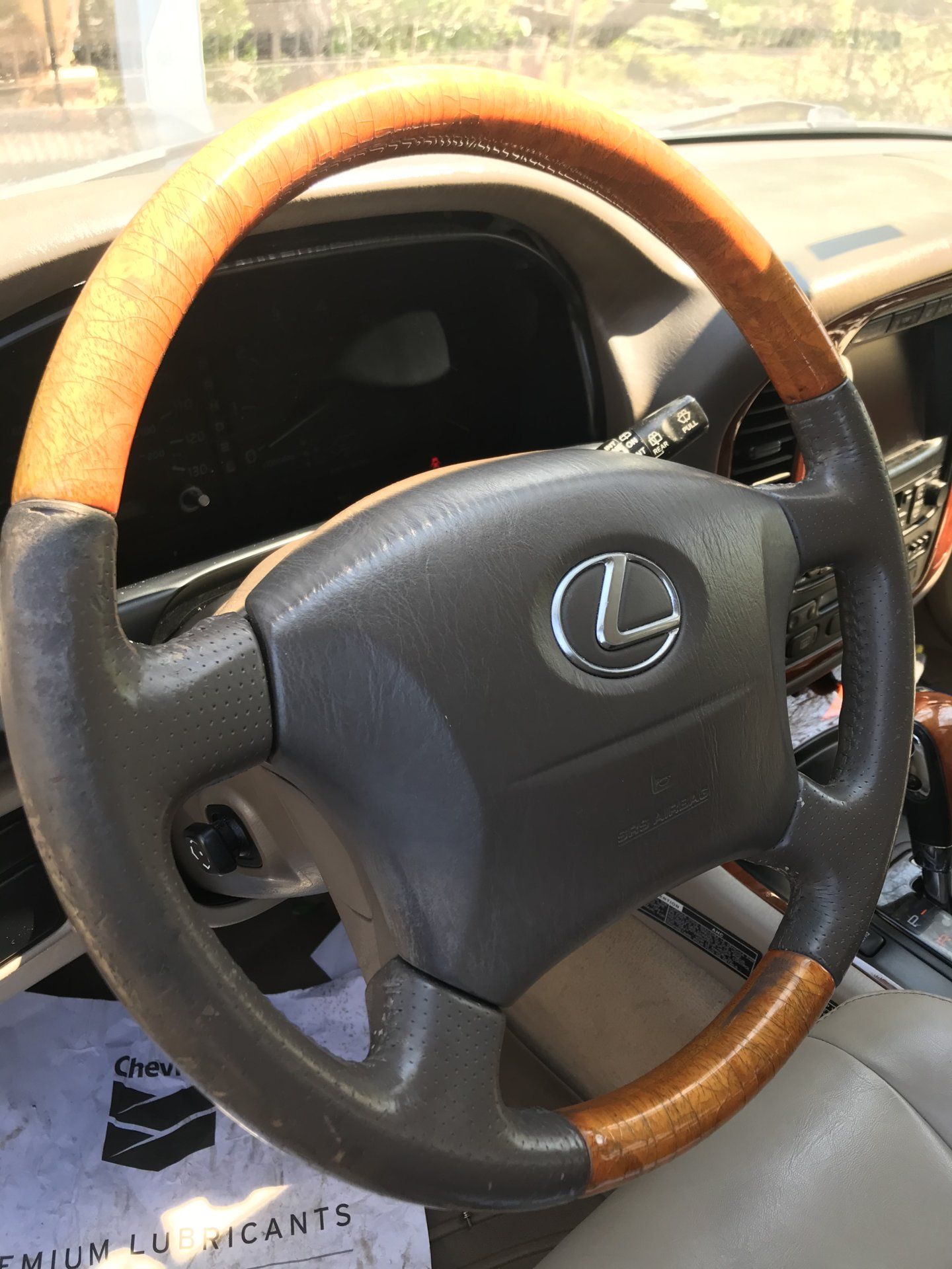

Maybe I will get my OEM redone so I can use it again in 15 years when this one goes bad.
Any questions feel free to reach out. The only struggle was 1) getting the original wheel off 2) making sure the new wheel was not off center for steering, and 3) resetting the airbag into the steering wheel.
I found out in the process that the grinding noise I have is the lower part of the wheel scraping against the steering wheel mount bc the plastic is not grabbing it close to the steering wheel.
Photos for the ones contemplating.
They didn't have choices. I just ordered it. Steering wheel feels so much better. Not perfect color, but for the price, I am a happy camper.

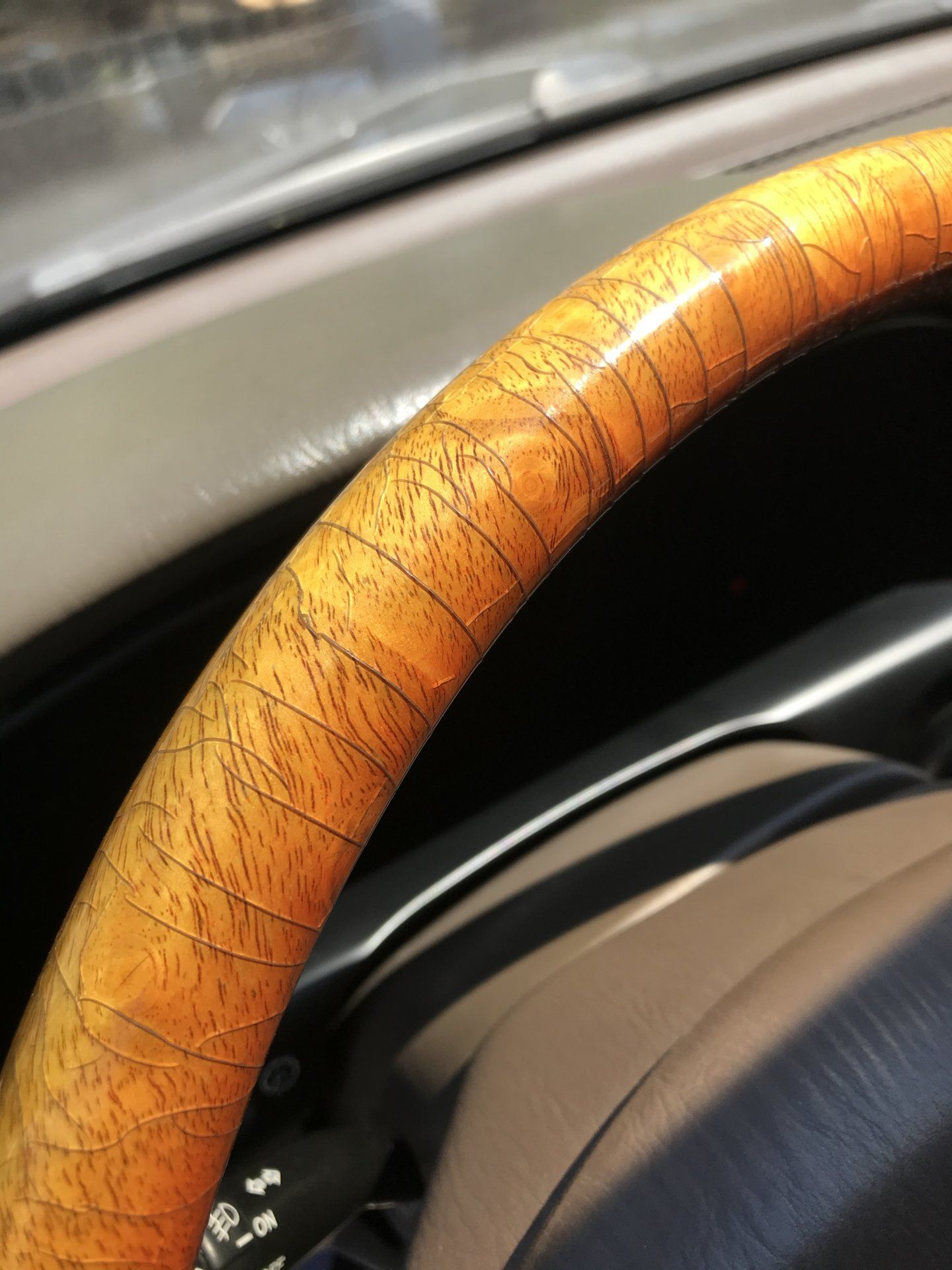

You can always sand off the clear coat on the real wood and dye it to match, would look awesome actually and modern. Someone removed the clear coat and did this but kept stock color, looked great just can't find the thread.
EDIT:
Here it is Lx470 interior wood trim overhaul

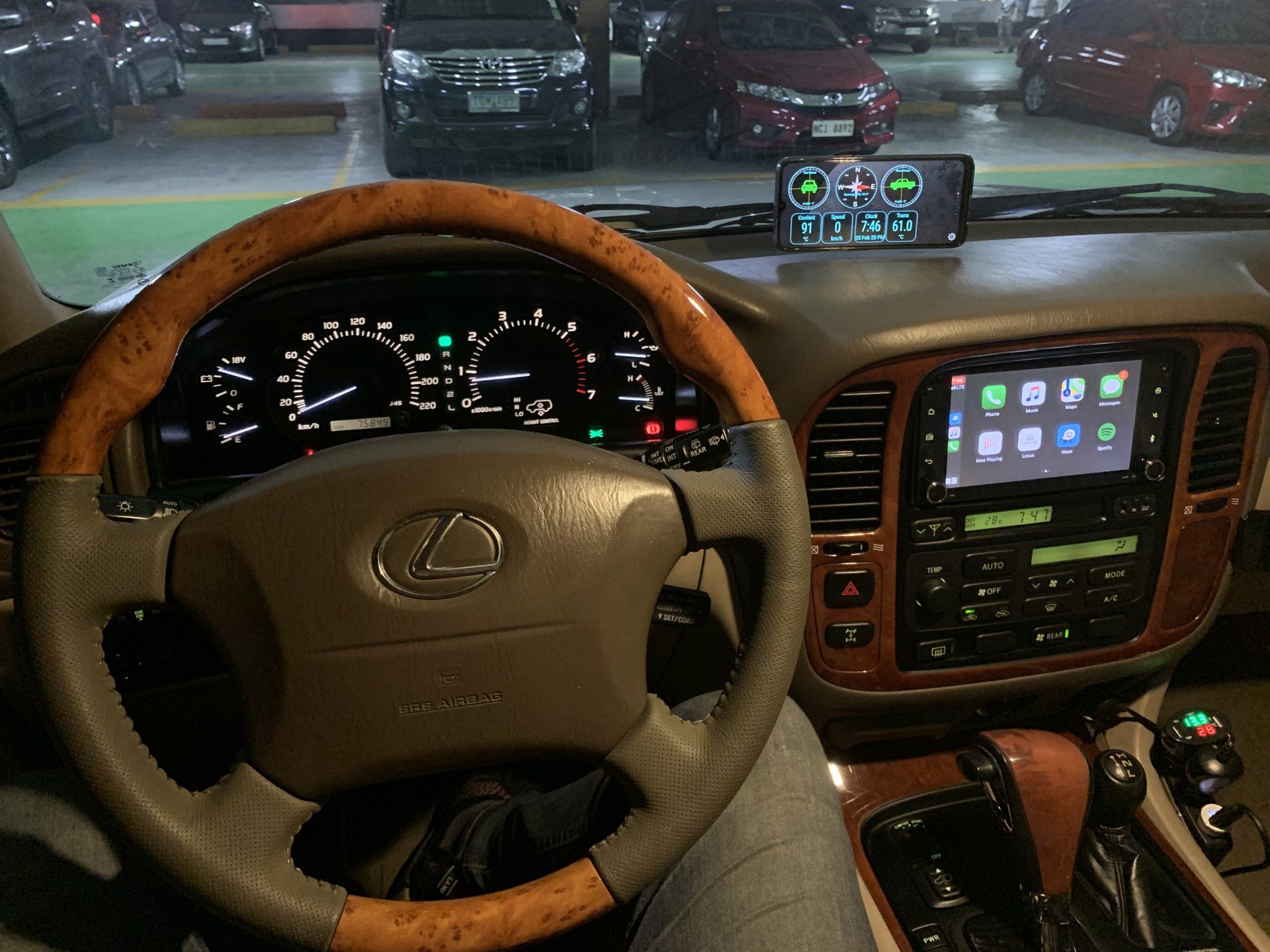

My color combo is identical to the OPs (mismatched wheel and all) and I think it's kinda funny. Good job on the swap, not feeling the cracked wood makes all the difference.
OP, I just installed the same wheel as you last week, and had the exact same scraping noise. Very annoying since I bought a wheel from the same seller and had no issues with the fit. I ended up sanding down the clamshell, and am now noise free.

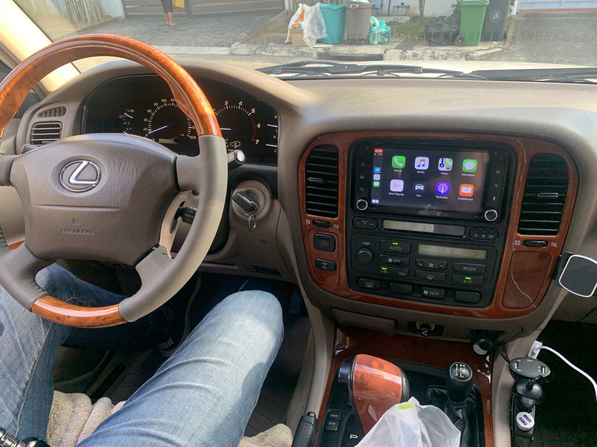

I ordered a prado 120 cover that fits our wheels. Not color matched, but it's a full leather wrap. I'll post up pics once It arrives and gets installed

@HRTROB I'm looking to replace my steering wheel too. Does anyone know the difference between a V2 and non-V2?
Not sure what the difference is. Mine is a V2. Somebody needs to get the V1 so we can compare ;)
I can do it in 20 minutes now because I had to reinstall everything a few times to get it aligned. Best thing I did was rent a steering wheel removal tool from a parts store. And remember to mark your center point before reinstalling!
