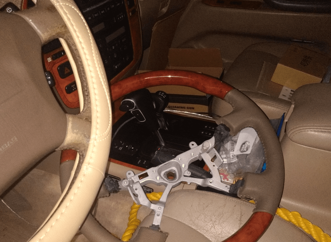

New steering wheel installed LX470
Would you want to sell your old one?

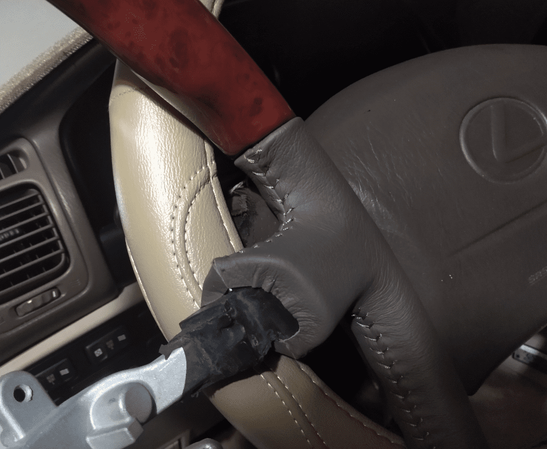

Let me see if the new one will fit and is the right color after I report back. The old one is a rag that I was very embarrassed about. Careful what you wish for..
I'm actually puzzled about the original leather coming apart before I bought it.. I think some leathers react differently over times.

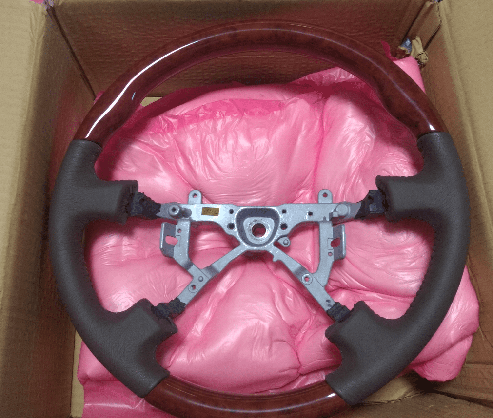

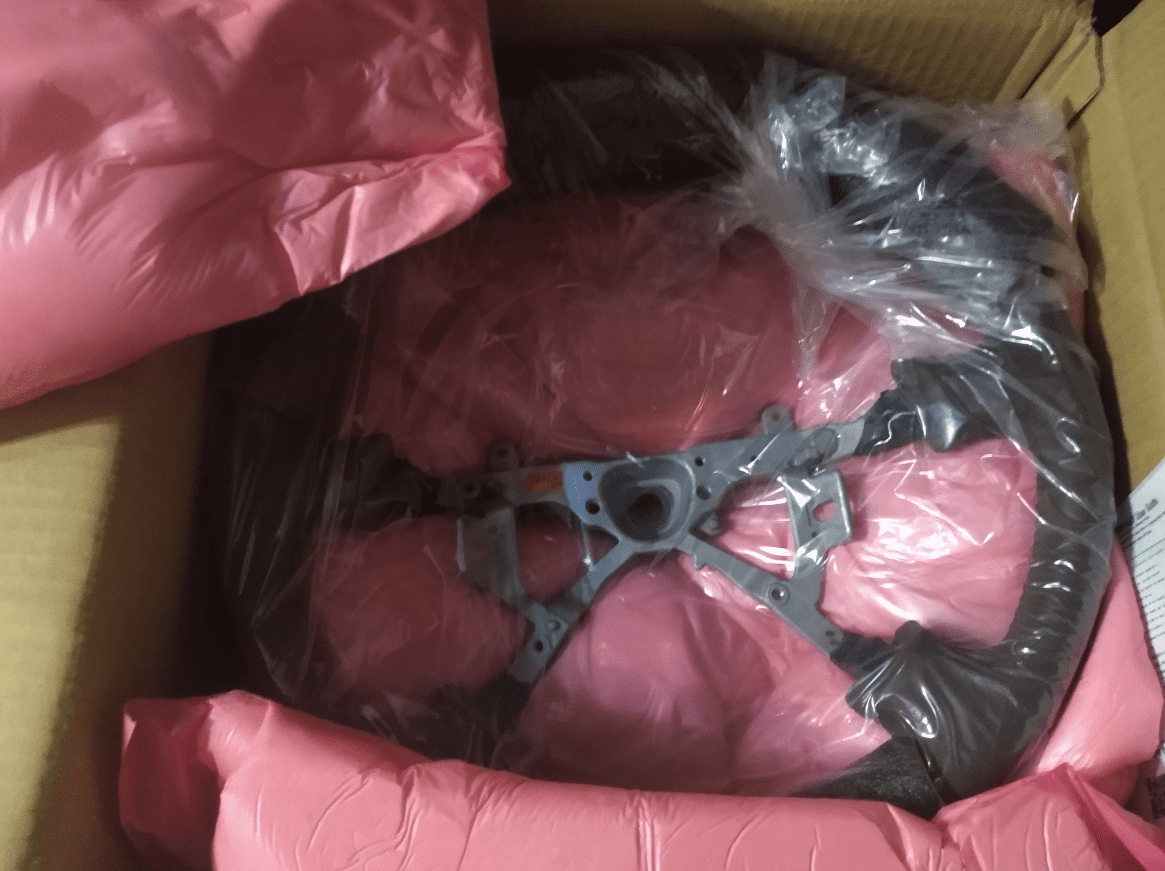

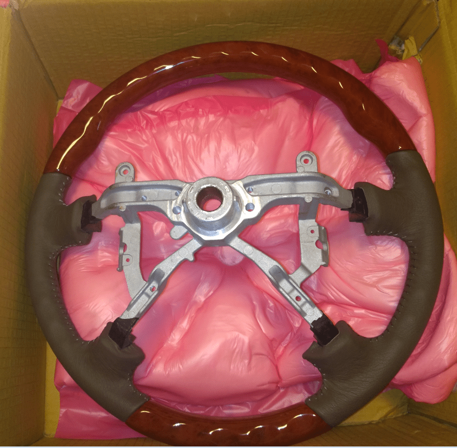

The new steering wheel arrived today. Ordered on Saturday, delivered on Thursday. It blends ok and will look better than the old wheel.
Comes very well packaged with extra protection for the wood part.
Color is enough to the air bag cover shade for a 21 yo off-road truck.
Nice. Mine comes in tomorrow. I may have to send it back if it’s different than yours.
I like the fact that it does not use perforated leather. I have bad luck with any type of perforated leather.

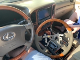

Yes. I will need to rent a steering wheel puller though.
No you don't. Just pull one side, then pull the other. Mine popped right off.
Don't pull. Just hit it with your palm at 9 and 3 o'clock repeatedly..
Before removing - set it dead center (I orient it by aligning rear cover)
Then install new one same way.
I replaced wheel at least 5 times and it's still dead center. Takes 5 minutes to replace wheel.
1. Pop covers with plastic pry tool.
2. Remove 2 Torx bolts and airbag comes off (2 connectors)
3. One 17mm?(or 19?) nut.
4. Shake and it will come off.

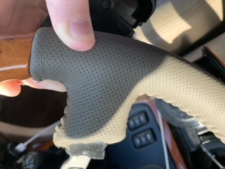

I just unpacked mine. Looks like the difference between the V2 is it has perforated leather. Which I like because it matches the original. Wood and color are the same as the others.
