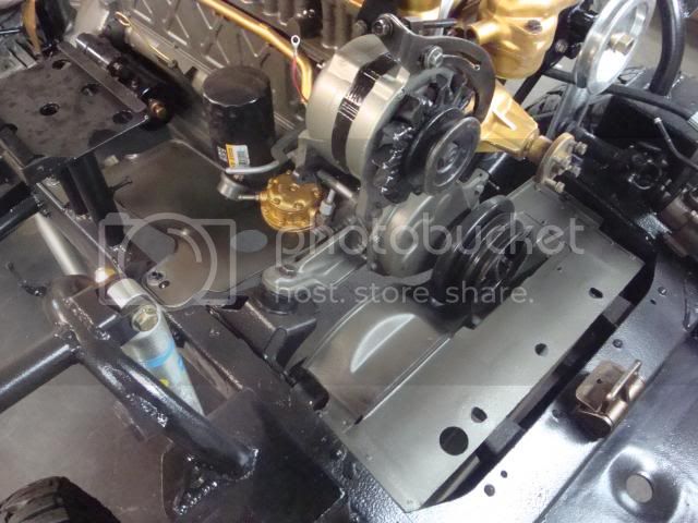

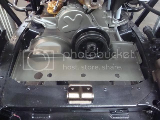

Cleaned and painted the lower rad shroud, ps splash guard, and the apron hinge yesterday. Turned out decent. Got the hi press ps line in, little short but itll work. Also took my drive shafts to Bull so hopefully thatll be off the list soon. Used the 60 series front ds in the rear and vice versa, both needed to be shortened to work and I asked for double cardans on both. What else? New toyota spark plugs and t stat......

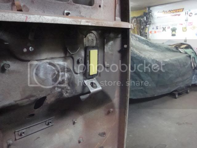

Found a spot on the fw for the big assed connector Peetie gave me. While cutting the hole for it I noticed that the glove box "floor" wasnt attached to the firewall and po had tried to patch it but didnt finish. So I went ahead and welded all of that and filled in 30 random screw holes in said floor at the same time. Took the opportunity to contour the glove box floor around the connector a little for some more room around it. I then finished patching the head unit cut out in the center of the lower dash along with a bunch more random holes in that area.
Gotta love welding sheet metal...... and po's that screw s*** in with self tappers instead of making brackets off of existing bolt holes...

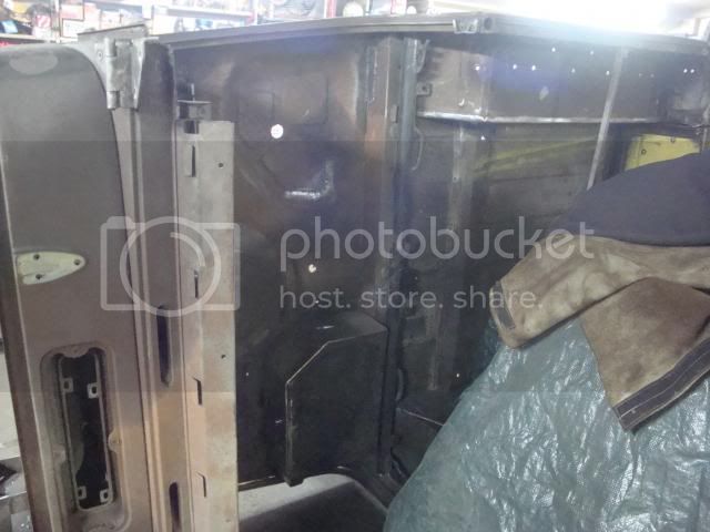

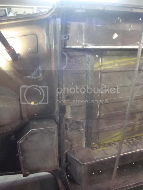

Spent the week working on the sheet metal. Tub is 95% finish welded, aprons are done, front fenders done, grille done, half doors done, wind shield frame done. Have to look over everything one last time before it all gets sent out for blasting and a coat of primer then I guess I have to pick a color.

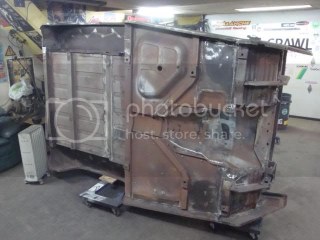

Nope havent picked a color yet. Been messing around with the tub and there was a lot more to finish up than I had convinced myself there was. Was. Couple friends stopped by and we got the tub flipped right side up and sitting on a custom moving dolly/2x4 rolling stand so I spent the last couple days going over the interior sheet metal and the exterior panels. Just trying to get it ready to send out to get sand blasted and epoxy primed.

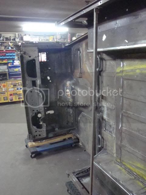

Just been painting and cleaning random stuff here and there lately. Made a pop up led light mount at the cowl vent that the purists are sure to fall in love with. The tub is all taken apart, holes are all reamed out, welding is done as far as I can tell.....
