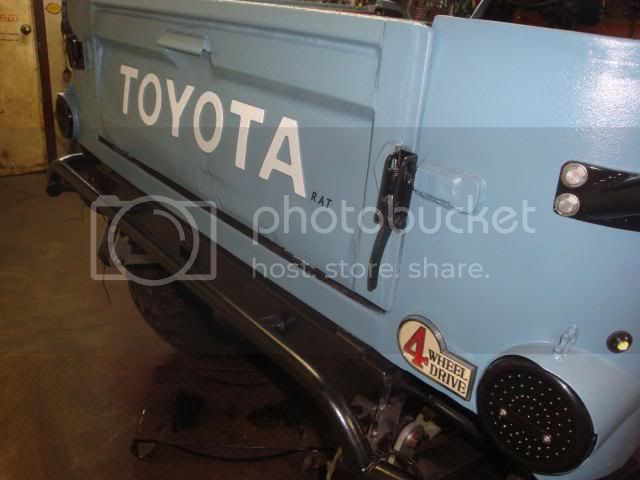

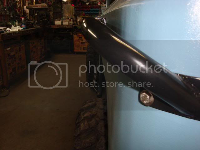

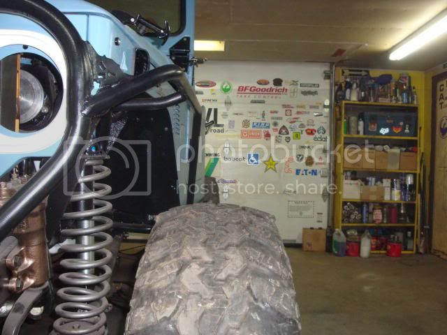

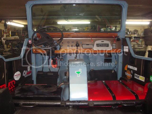

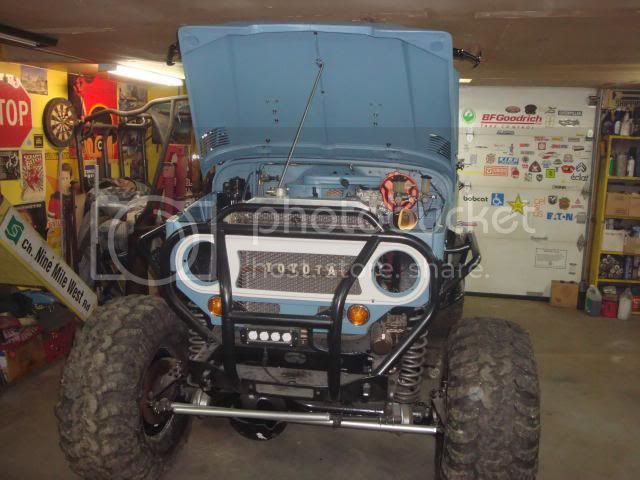

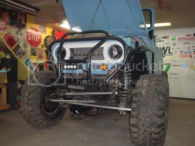

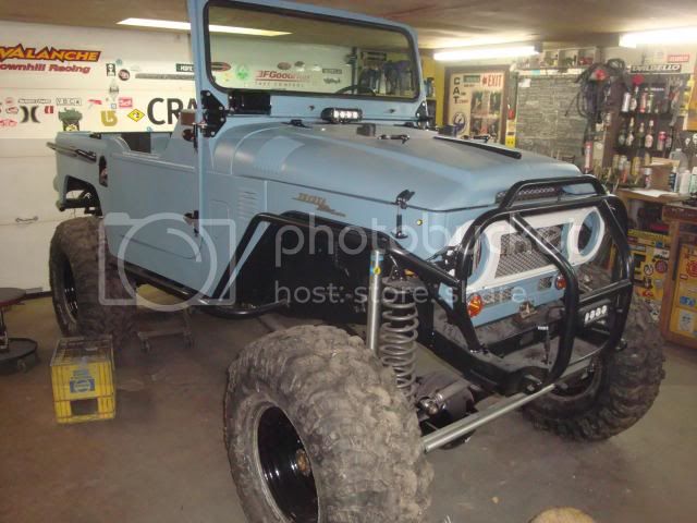

Panels arent perfectly lined up yet and its all dusty and greasy but heres where its at..

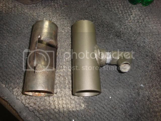

Home made T

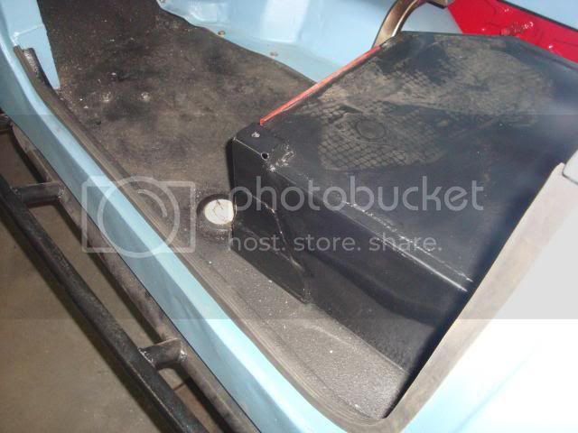

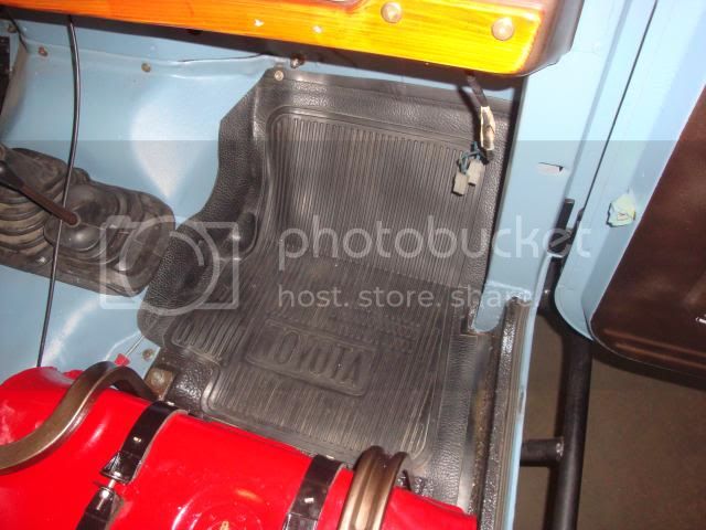

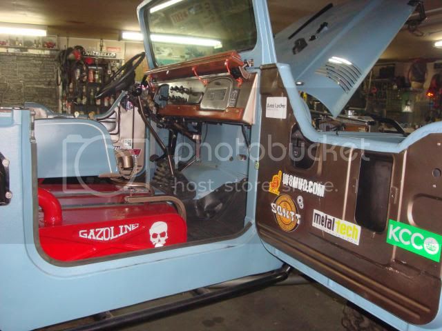

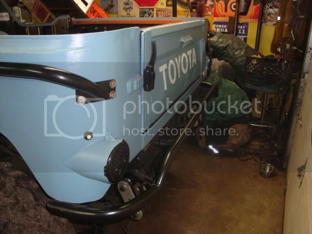

Whipped up some door seals.... kinda. Tryin em out.
Cut up oem floor mat. Drivers one is gonna be a little work since its swiss cheese.

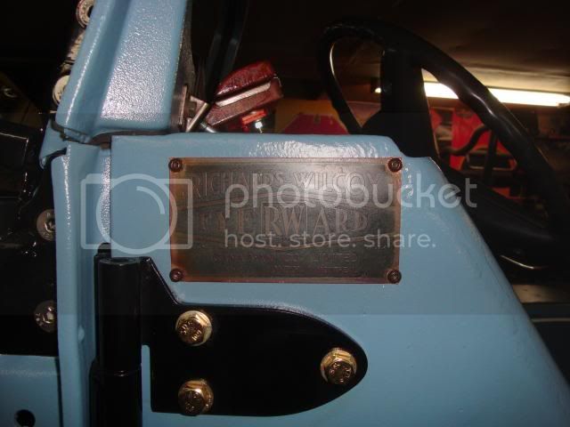

Brass fire door badges I had lying around.

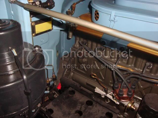

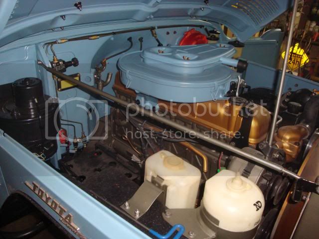

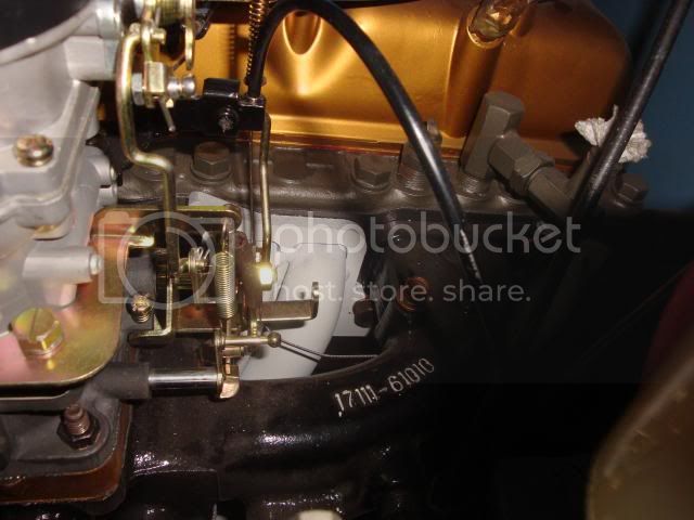

Got the fuel lines and filter hooked up heater lines 85% done power steering lines are in picked up all the fluids ( spent like 500 at the parts place and had the guy running. Kept having to tell him to stop looking for s*** on his puter just go match it up in the back...). Figured id treat the tranny to some lucas 80 90 and just got regular no name for the diffs since I change em regularly anyway. Bunch of other little crap like a w/sh washer pump got found and bought. New wiper arms and side views are on their way.......

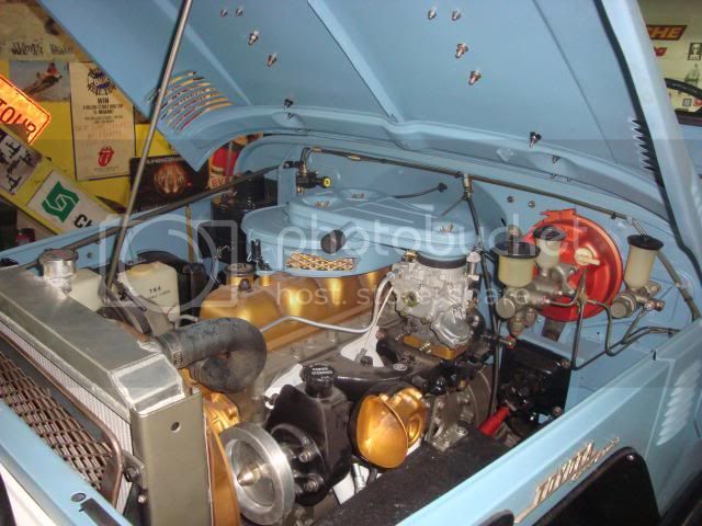

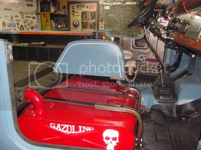

Managed to cross some more junk off the list the last couple days. Wipers and arms are installed, fuel filler lines are in, fuel cap didnt fit too great (was loose) so I "adjusted" the filler neck a little and now it fits mint. What else, the defrost hoses were fallin apart and one of the po's had wrapped them up in hockey tape of all things so those got custom shop vac hose modimifications. Got the ps cowl vent drain line hooked up, still tryin to figure out the ds since I dont have the stock one. Side view mirror assys got put together with home made gaskets, door latches got stripped and painted (lost both lock bearings while I was at it lol), door limiter dealies got painted and rebuilt using some mtb handle bar grip ends as bushings and such... Fan belts came in today, tentative appraisal appointment at noon.....
