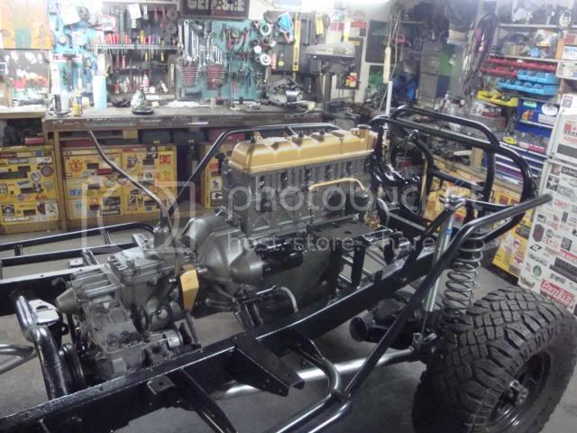

Well, finally got the frame/suspension shoved out of the way and the motor/tranny/xfer out front and center. Threw jack stands under the motor/bell housing mounts and it seems to be supported well... I hope lol.
I took a few minutes to cut off and move the lower piston mount of my engine hoist up 4 inches after the motor was standing on its own. I wasnt getting full travel out of the hoist, hell it wouldnt even come close to hitting my ceiling in the garage, and there was about 4" of piston shaft exposed when the hoist was lowered all the way. It will now go higher than the ceiling and still folds up mint. Maybe getting the motor back in wont be as much of a pain in the ass as it was getting it out.
After the hoist mod I took a couple minutes to clean all the grinding dust off of the motor and gave it a good wash with some degreaser. Next I pulled the valve cover and one head bolt and did the oil galley plug fix. Wasnt hard at all with the motor out of the van and literally took like 30 minutes start to finish.

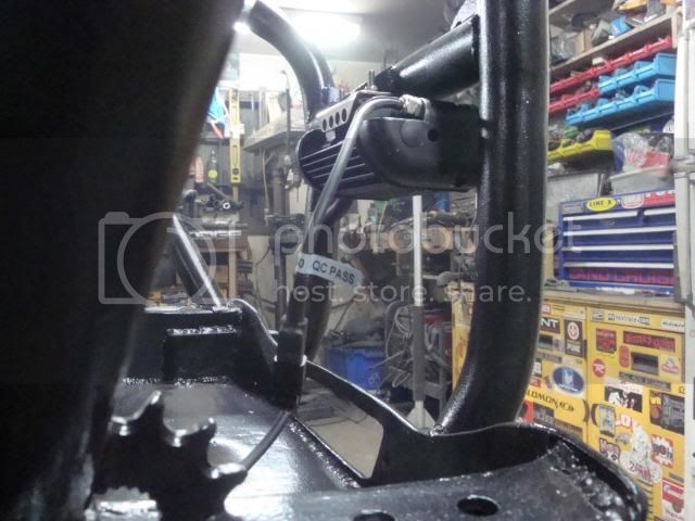

Got the bb links and new tie rods installed today then got some more cleaning done on the motor. Missed the delivery guy who was trying to give me my ebay light bars, maybe ill see him tomorrow.... Not much progress but not bad considering I work nights this week.

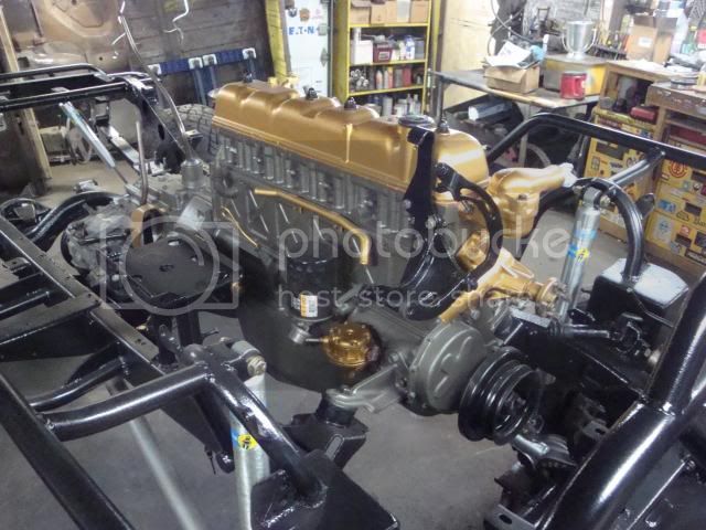

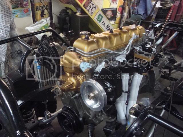

Update.
Painted up a bunch of stuff and put a bunch of stuff back together. Tired... Thanks Randy.

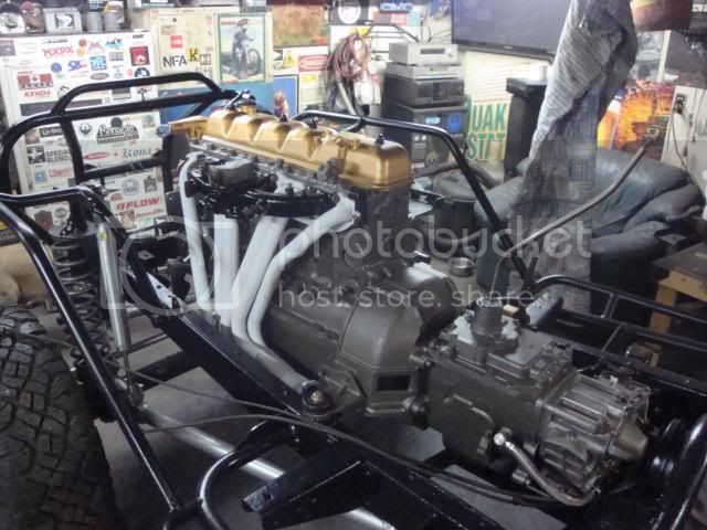

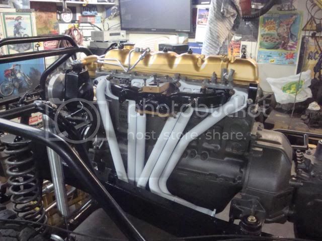

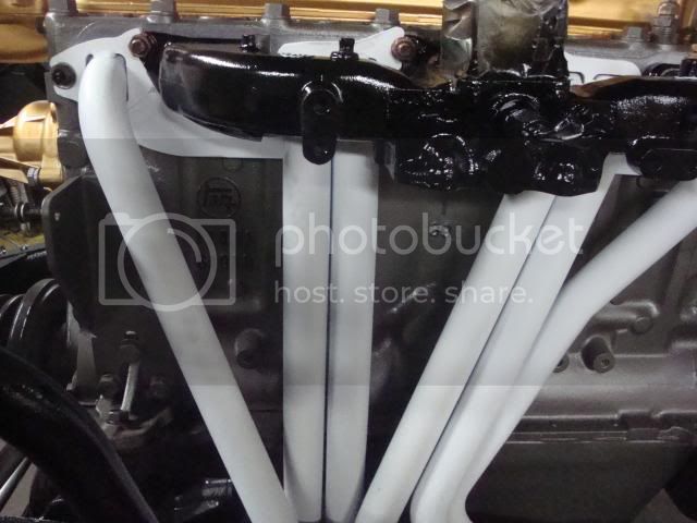

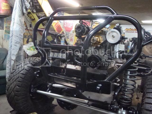

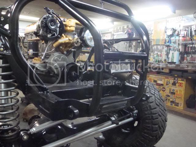

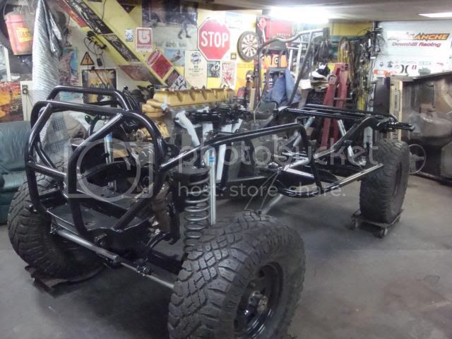

More crap bolted on.
D
Wow ... I'm a slacker ... Looks awsome
Sent from outer space via my mind
Wow to see where it came from to where it is now....
My hat is off to you sir!
