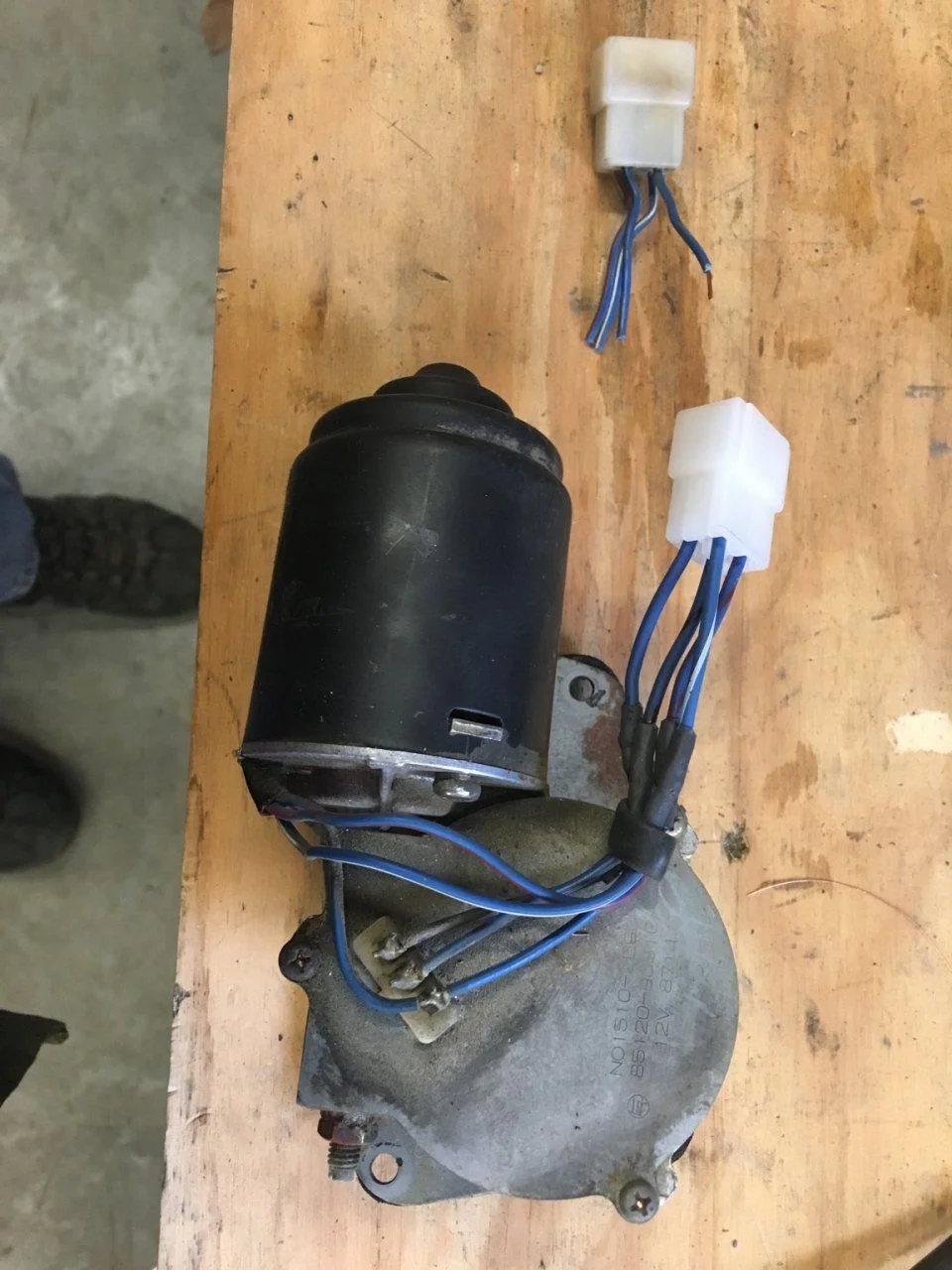

Moved on with some odds and ends this weekend. Replaced the windshield wiper plug with Coolerman's replacement. That went fine, but now trying to diagnose the wiper system itself not working. I know I have power to the plug as the pump works, but in the first position I'm only seeing 5 volts at the motor. Nothing in the 2nd position. I took the switch apart and everything looks normal with minimal wear and little oxidation. Going to run some continuity checks, now that the leaves are raked.

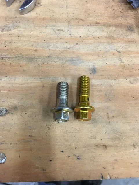

Replaced the rear brake banjo bolts with a longer bolt. Initially had a small leak, like a few drops overnight. Checked the web and the recommended torque on the bolt is 32 ft-lbs. That ended up adding about 3/8 of a turn and so far the leak has stopped.

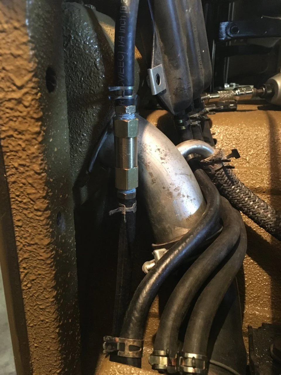

With no charcoal filter and the check valve no where to be found I dug around and found a thread on replacements for the $55 OEM check valve. This is from McMaster-Carr. Added (2) 1/4" male barbs to either end and it took longer to take the cover off than to make the modification.
