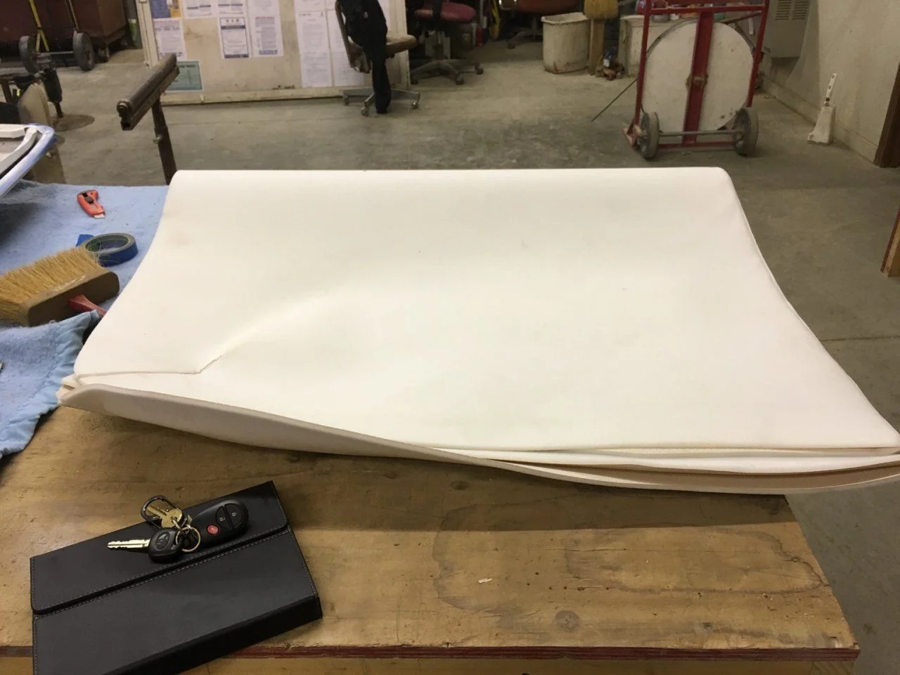

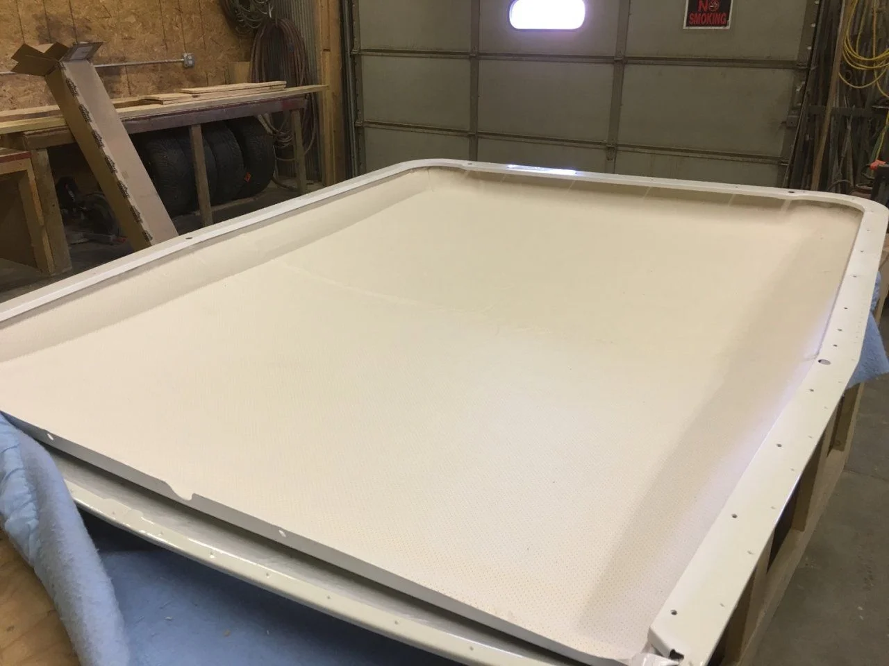

Progress slowed considerably due to the holidays. Spent yesterday doing prep work on the hard top ahead of the headliner installation. Went with Specter's headliner which is much thicker than I thought it would be. After some research here I'm going to use 3M's 90 spray adhesive. That's planned for this morning.
Received the correct front door weather stripping from Specter last week so planning to get the doors finished up and installed as well. Now is when I really wish I had insulated and heated the garage...good thing I have a heated shop at work.
Sent from my iPad
Headliner installed.

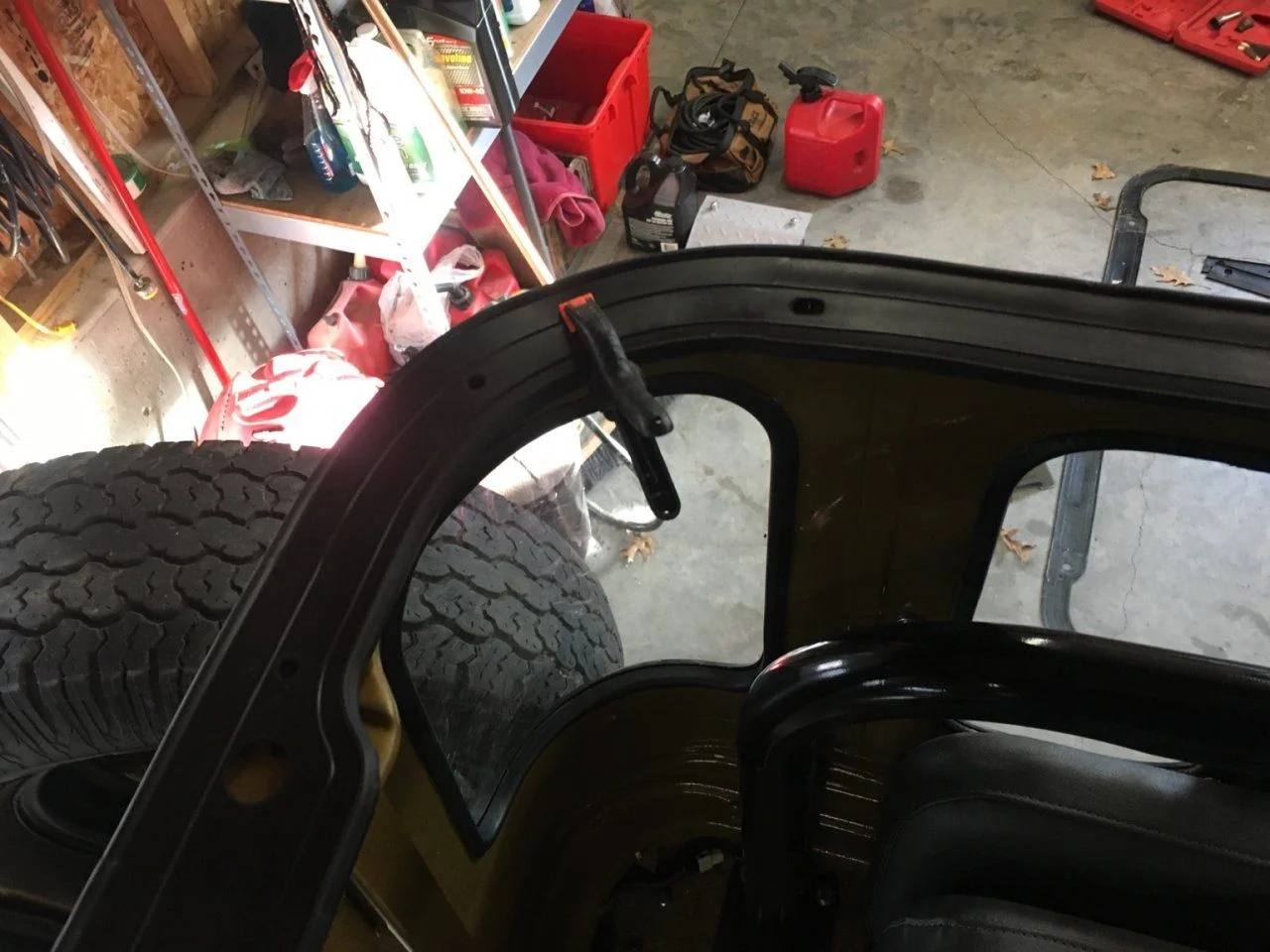

Purchased an aftermarket hardtop gasket from CityRacer. Awesome quality and fit perfectly.
Spent the afternoon bolting the hardtop to the sides. Yes, it sucks. Front doors are on and reasonably adjusted. With the new seals everything closes tough but tight.

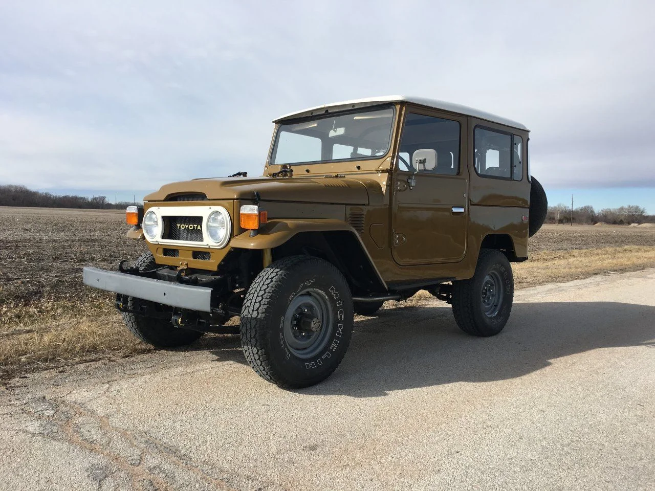

Got stir crazy yesterday and went on a little shakedown cruise. Drove up and back to Erik C.'s on a combination of paved back roads, highways, and interstate. New speedometer cable broke about 50 miles in. Have some drive-line vibration that I need to work on. There's noticeable play in the driveline itself which I believe is contained in the rear pumpkin - might be time for a rebuild. Had her going down the interstate at 65-70 with no problems, no wandering, no play in the steering. Pretty happy with the 270 mile trip yesterday.
Called CCoT this morning and a replacement speedometer cable is on the way.
